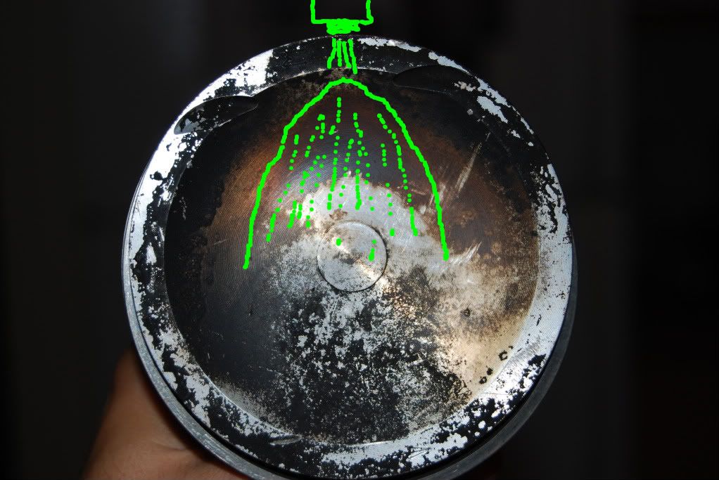

Attached is an image showing the fuel pattern as it is sprayed on the piston crown.

forgive my ignorance on this but draw up a picture of where the injector would be pointing on this particular piston , i see the bigger valve reliefs on top of pic and the smaller ones on the bottom...never seen this motor apart and would like to see if what I am thinking about this picture is correct.
Lex 09-24-2009 06:29 PM
The injector sits between the two intake valves where on the piston you see the 2 valve reliefs. The spray pattern appears like a triangle starting between the two valve reliefs and fanning out towards the exhaust side.
This piston was covered in carbon initially and this is what brake cleaner could remove.

rodrigo 09-24-2009 06:31 PM
would u have a non cleaned piston pic handy??
i rather not assume at what I am looking at was caused by the engine running vs the brake cleaner
thanks
also.... some 360 degree side pics of the same piston would be nice to see how the ringlands vary in discoloration from the fueled side to the non fueled side of the piston

MATT DAMOND 09-24-2009 06:43 PM
Here lanny:
With injector + spray, painted:
http://i797.photobucket.com/albums/y...a/piston-1.jpg

rodrigo 09-24-2009 06:45 PM
i got it matt ty... should be more at the 1130 o clock position though lol
MATT DAMOND 09-24-2009 06:46 PM
Yeah oops

was that injector spraying onto that cylinder from the bottom up? i see that the top has more discoloration which could be from heat
- edit - i fail, i missed that totally

Lex 09-24-2009 07:03 PM
Originally Posted by Lenny127 (Post 321434)
if u do get a chance to do some all around side shots of the pistons perhaps this would strengthen your theory, because fuel washing down the cylinder wall should not be happening on the side the injector is spraying away from.... and the ringlands in term would HAVE to look different , if your theory is correct.
Picture 1 shows the intake side of the piston. Notice less carbon buildup (behind the injector). This is how it should all look.
Picture 2 shows the opposite side - the exhaust side, against which wall the injector fires. The exhaust side of the same piston is also shown in the first post in this thread.
Notice the buildup on the ringlands and inside the ring groove. That carbon is caked on there good. Brake clean will not remove it easily if at all.

rodrigo 09-24-2009 07:08 PM
and again, I am not interrogating you , just asking so I can come to my own non biased opinions......both of these shots were taken in the pistons "virgin" state or after a cleanup?
reason why I ask..and I am not insinuating anything.... is that one person can clean parts and unwillingly (or willingly) erase vital information about how the engine was running.... i always rather see engine parts in its natural form , dirty, full of w/e came out of the motor.
Lex 09-24-2009 07:10 PM
The crowns were wiped down with brake clean using a rag. No scraping was done what so ever. The ringlands are uncleaned. These are all pictures of the same piston.

thanks lex. well......... its obvious that the piston doesnt have a "balanced" performance when it comes to lubrication.
now, it would be helpful determining if indeed this was a seizure (looks like it) and the rod having no place to go up breaks and shoots out the side.
would u guys be able to determine if this piston seizure happened on an upstroke? by looking at the scoring marks they should hint as to which direction this happened in
I mean there are so many things you can look at , from how the rod bent/broke to which direction the hole in the block was in to tell you crucial info that leads to the point of origin of failure.
you basically have all the info in front of you to "reverse engineer" the incident.

Very bad design from Mazda to put the injector where it is spraying the wall.

Originally Posted by jwdp54 (Post 321374)
you realize with this comment every single one of us are taking a risk. he's basically saying the way the fuel is being sprayed we all most likely will have a blown motor.
i realize this. but i also realize that if this theory is false(not saying this is the case) we will have a better understanding of the car in the end and maybe be able to find the cause of our motors failing that may be able to be fixed (once again, not saying Lex's theory is neither correct or incorrect)
Thank you Lex for all your work. i'm glad to see some one put this much effort into this.

Thestaplegunkid 09-24-2009 09:27 PM
Well Lex, here's the shot you asked for. I had no carbon build up in my oil ring. There is what looks like some washing down of fuel on the side of the piston (browned area). This is the exhaust side of the piston, which the injector sprays against. Also, some pronounced scuffing of the coating on the piston skirt. This was most evident on this piston, which showed the most browning.
Lex 09-24-2009 09:40 PM
Thanks for the picture. That looks a lot cleaner. He used synthetic in the engine so that's a clear winner in terms of oil to use.
2 questions:
1. On the top compression ring, are those detonation marks or nicks that were put in there from debris and you removing it? Are those nicks present all around the piston or just on the exhaust end?
2. Is that carbon buildup on the top of the second compression ring? Any carbon on top of the first compression ring?
As always high res pics are great.
