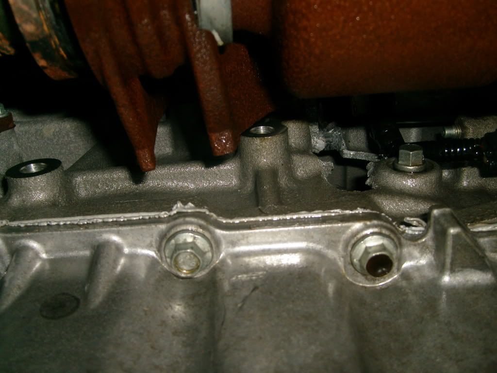

Plus, re-sealing the oil pan last night I had time to look from underneath at the rod and pistons and I'll tell you this; whatever the whether; whatever the abuse there's no sign of damage and wear (i.e detonation, metal floating in the oil, etc etc etc.
I love to be a believer of good things to come but how can you even identify that there is no detonation damage from looking at the back of pistons and rod caps? Plus, none of the cars that I've seen apart and blown have had any detonation damage even on the tops of the pistons.

trickytwelveinch 09-28-2009 09:41 AM

AFcadet 09-28-2009 01:04 PM
Im going to be tearing apart my blown motor this weekend. Ill make sure to get pictures.
I have a similar looking hole in the block...rod blew right through it.
http://i257.photobucket.com/albums/h...t/S7301669.jpg
We will see if the piston is siezed or shows any signs of it when I open it up

Lex 09-28-2009 02:10 PM
Please PM me when you're tearing this apart, I hope to get all the details to learn more from the failure. If you have the correct tools to measure the bore, I would be very much interested in those measurements as I think we'll learn quite a bit from them.

smakdown61 09-28-2009 05:02 PM
I think the block is made of weak material. It should hold the rod in lol.
cld12pk2go 09-28-2009 05:39 PM
Maybe Mazda owns stock in JB Weld...and wants us to patch the holes...
