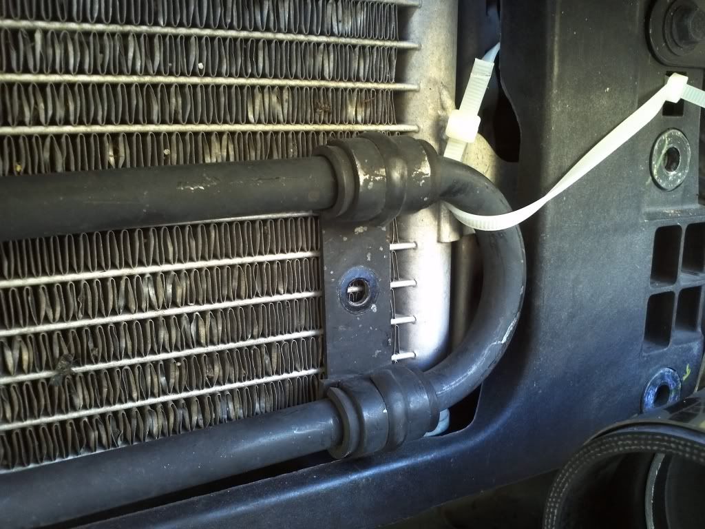

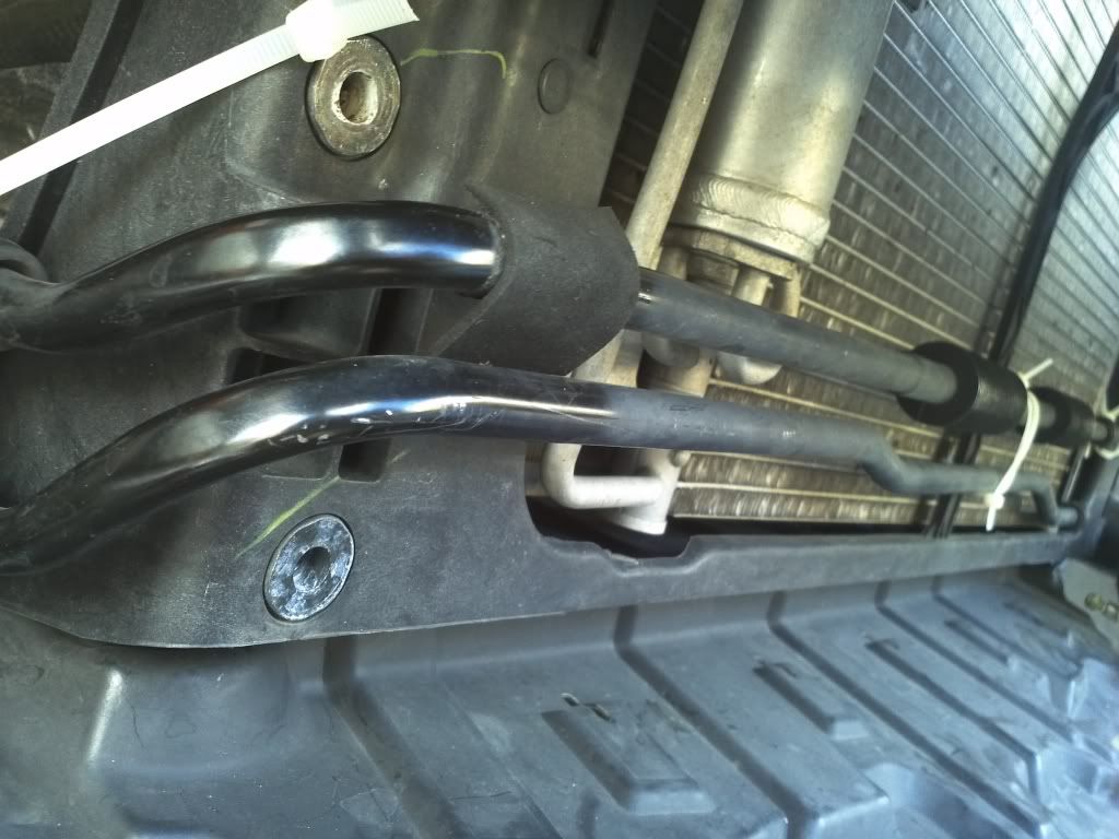

Hey guys, I had a little fitment issue with my bigger core for my CXRacing FMIC.
1 Being that I had to cut a few plastic on the bumper (pushing against the core)
2nd being is that cooler of some sort in front of the radiator.
Can someone tell me what does that thing cool? And is it replaceable by a transmission cooler or an universal radiator cooler of some sort?
If not, I'm probably gonna extend my bracket by about 2 inches toward the front bumper.. Hopefully it'll clear the core. =\
any help would be great! Thanks.
Here's a few pic
(removed the brackets and ziptied it closer to the radiator to clear the core or keep the core from pushing against it.. i know it's ghetto, but it's my temporary fix for now)

Tokay444 09-26-2011 03:23 AM
Don't quote me because I've only ever seen anyone talk about the speed6 one, and that's in a different spot, but I think it the power steering cooler, and yes, it's re-routable and replaceable with an upgraded cooler.
TWOptSL0W 09-26-2011 03:41 AM
It's power steering. It can be moved but be VERY careful
silvapain 09-26-2011 06:22 AM
This.
When in doubt, trace the lines.

xtasy 09-26-2011 06:47 PM
Thanks for the info, I'm just gonna swap that for an universal radiator. If not, I'm just gonna go to my friend and tell him to make me some custom brackets to place that thing else where.

XRJoe 09-27-2011 12:04 PM
X2 on P/S cooler.
Also, if you plan on keeping it mounted that way for long, put rubber isolators between the metal cooler and anywhere it can touch surrounding metal (radiator, brackets, etc). You don't want to wear a hole in that or your rad.
