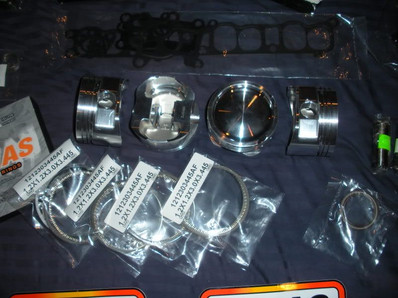

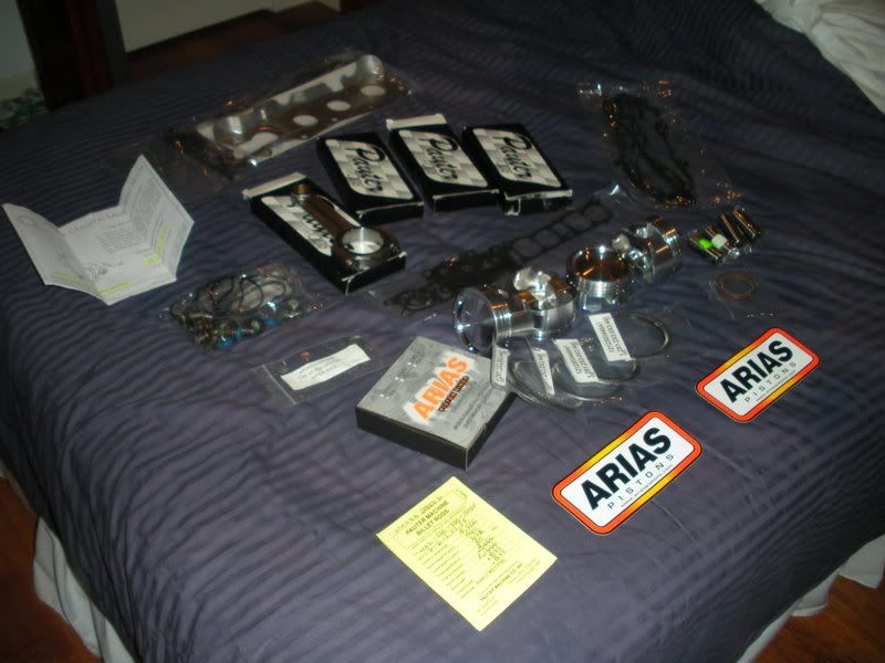

some of the goodies came in today
still waitin on some other things hopefully xmas time it gets built
andre0121 is offline   Reply With Quote

awesome... enjoyed the pics, since i never got to see mine.... let alone sleep with it, like it appears your planning to do

lol thanx randy im actually pissed cuz now i wanna see wat whoosh is bringin to the market w/e....
meh... theres always next year if whooshs is something better. probably billet or something.
what compression did you choose?
