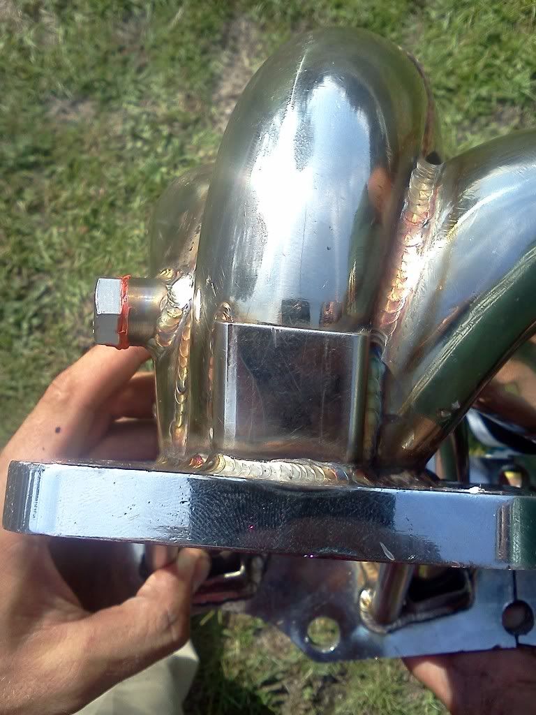

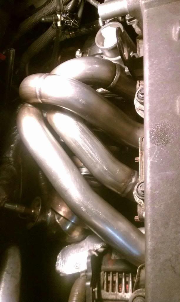

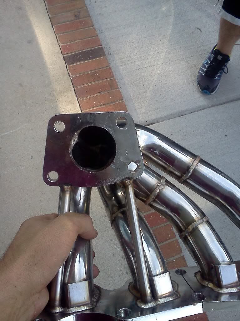

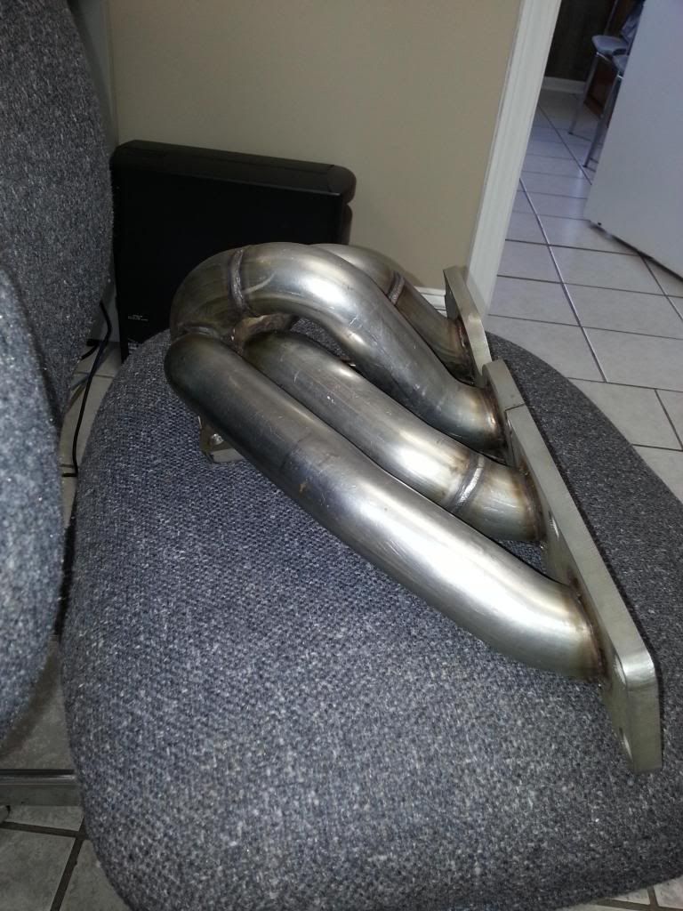

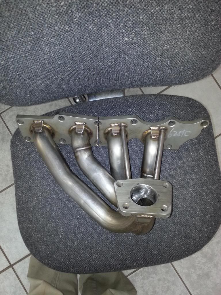

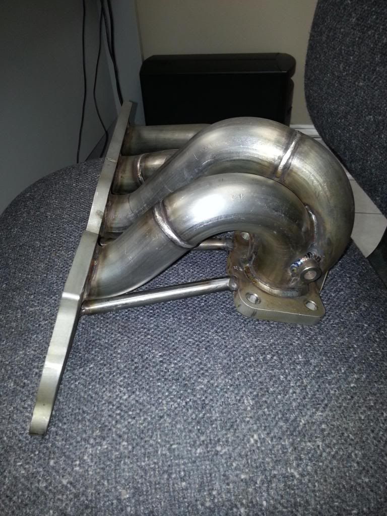

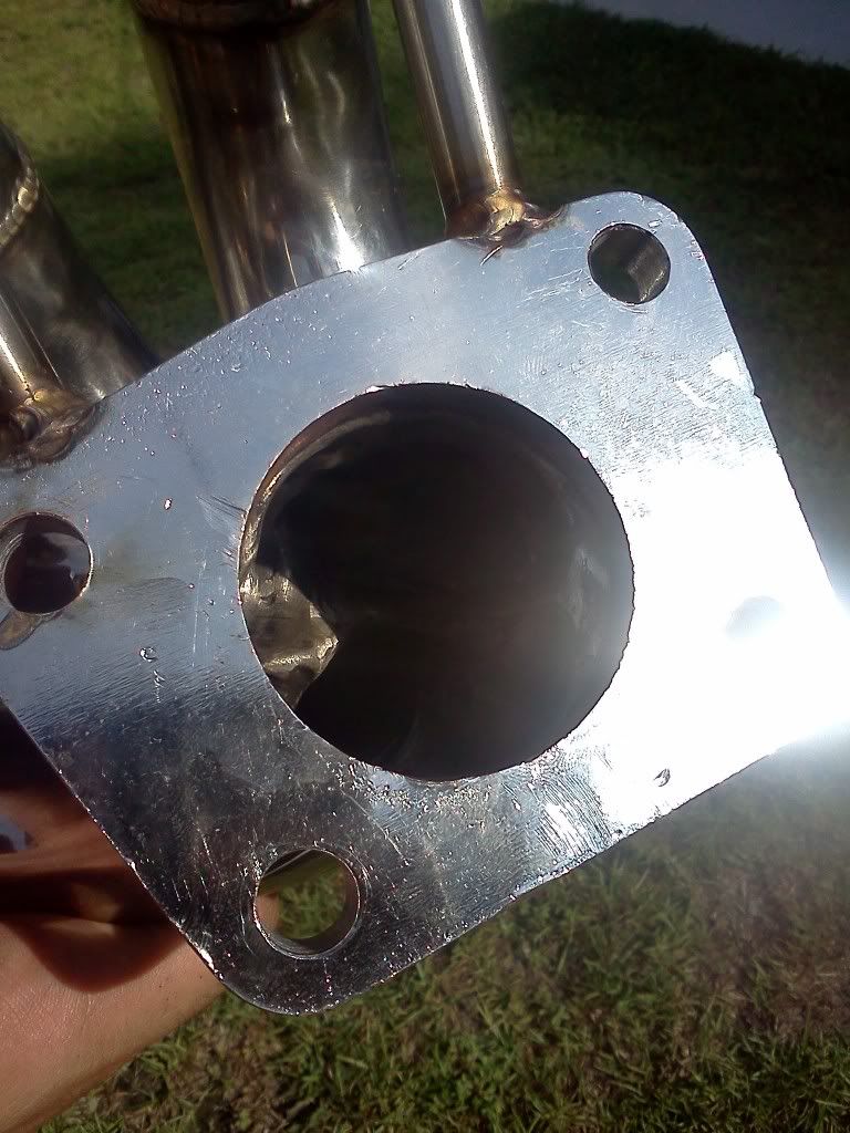

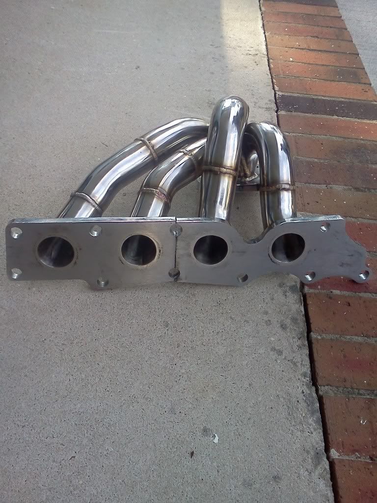

OK well this has been a year long R&D on this manifold. XS Power gave me the opportunity to test the prototype and i had no issues running it with my gt3076r.
Well they have sent a couple to local NC guys and @outlaw4ashirt; ran it on his ms6(3071).
Here is the prototype/ final product. They have made about 15 of these and are in hand( No GB here)
This is not a for sale thread, i am simple trying to inform.

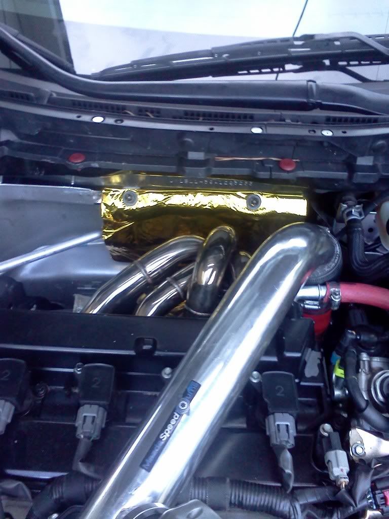

I'll be testing one on my car in the coming weeks. I just had it coated and will be heat wrapping it today. I'll put this thing through hell with my gtx3076 under. Ill once again be tuned by the freek and will post before and after comparison dyno sheets.

UPDATE: Mine was coated and baked 3x last night, I'll be doing a full DEI heat wrap today and tentative plans are to install on my next day off this coming week. Staybroke saw some great gains already with his VD he posted, I'm hoping to see similiar if not better gains with my setup as well as all the coating and heat wrapping to help dissipate under hood temps as well

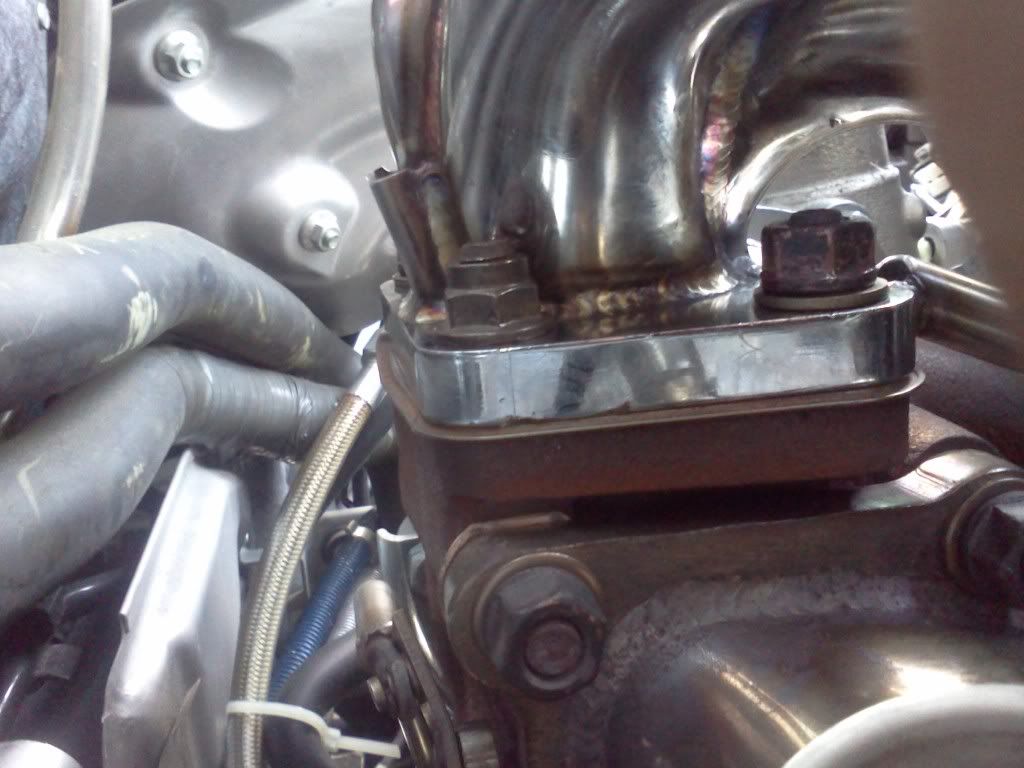

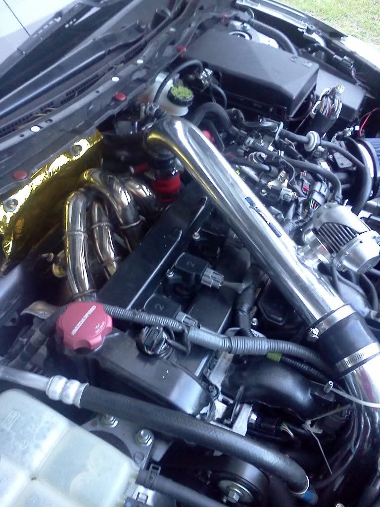

LumberJack 08-31-2013 11:57 AM

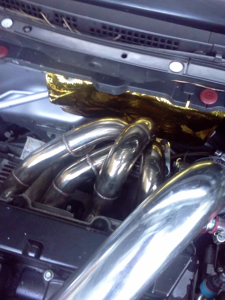

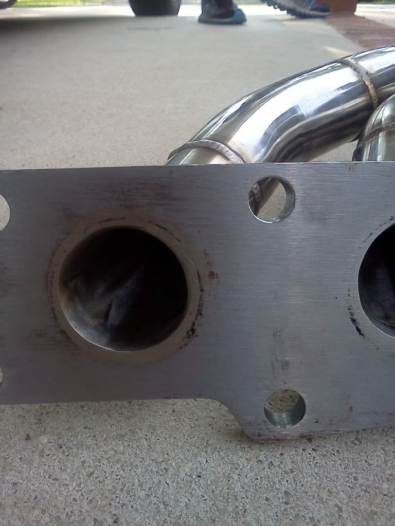

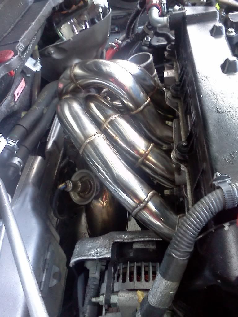

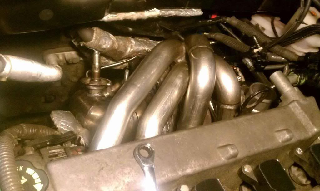

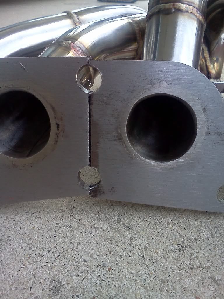

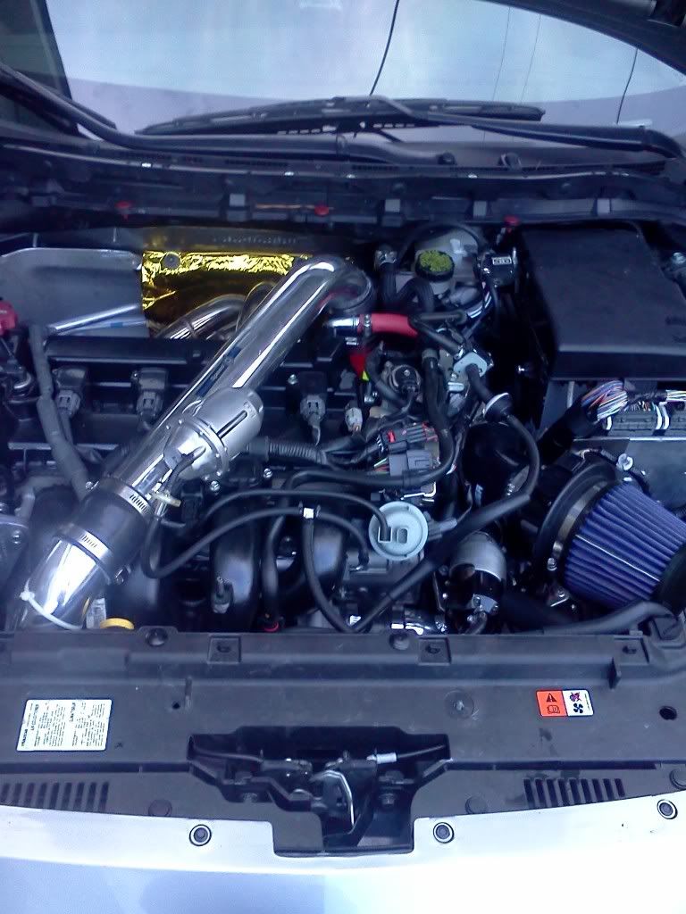

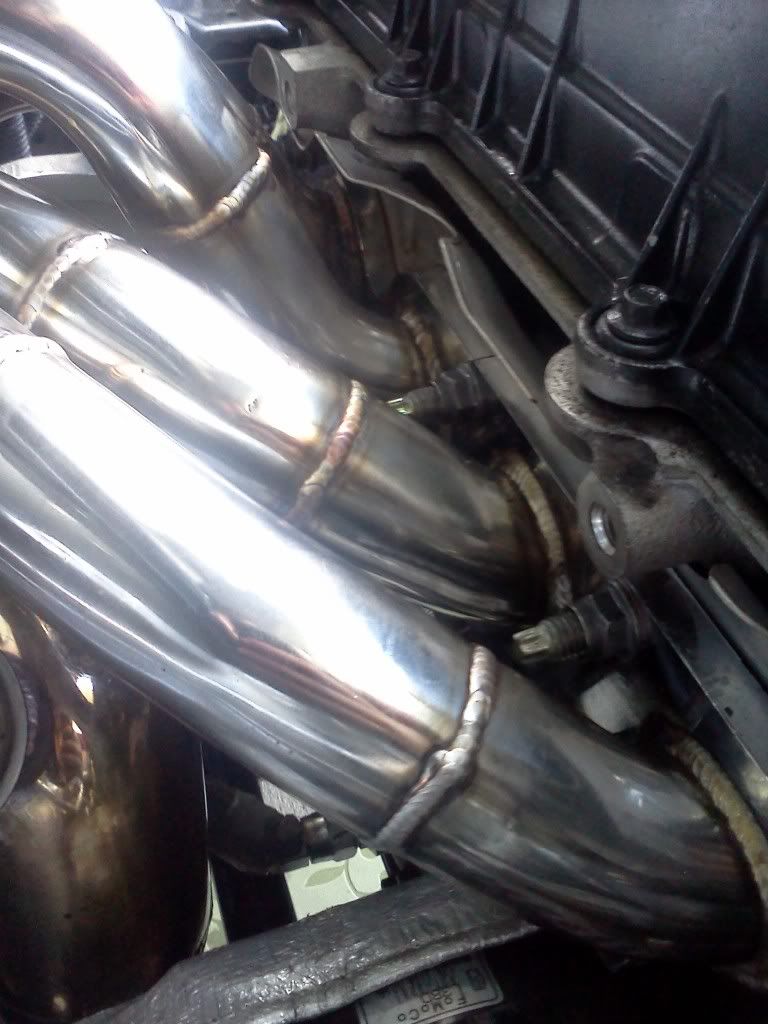

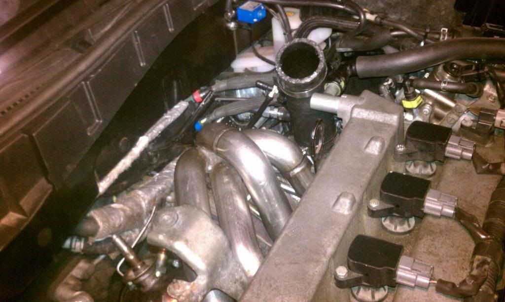

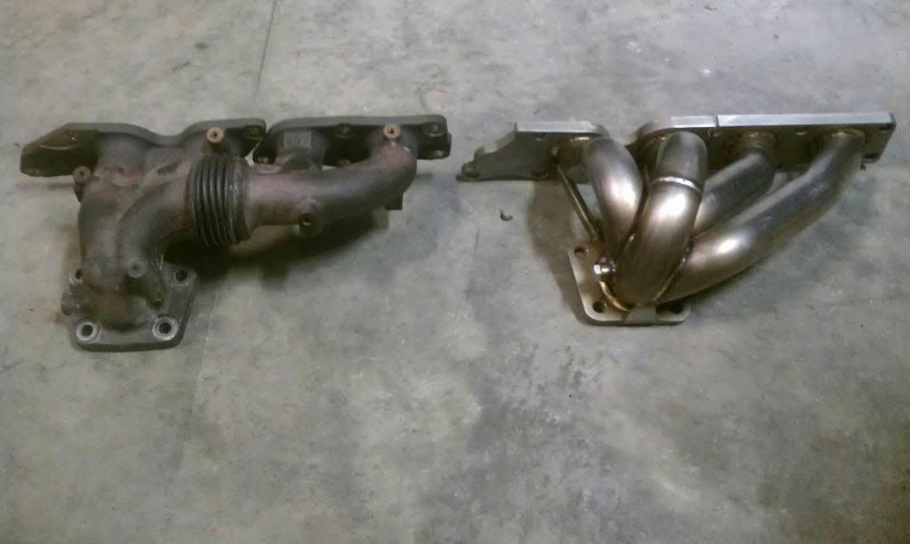

Well this was long over due and it took a little longer then I wanted, but the manifold I had to test is on the car and has been on for roughly 2wks now.
FIRST: As far as the install went, and my review of the manifold I have some mixed reviews on it thus far. It does seem to be a quality piece, welds aren't the worst, but aren't the best. The bracing they added is a nice touch if you're running a BT setup to help support the extra weight.
STOCK MANIFOLD REMOVAL: Removing the the stock manifold and doing the swap from the top is pretty straight forward and simple, depending on how small your hands are and the size of wrenches you have getting to the last couple manifold bolts requires removal of the entire EGR valve, I found it to be much simpler and allows you much more room for working.
INSTALL: The manifold goes is with ease between the firewall and the block no problems there. The toughest part is getting the head flange to line up entirely and getting it go on essentially. Some pry bars and a dead blow mallet helped with this part... This is where I began to run into my biggest issue... Once the manifold was flat to the head the turbo did NOT line up with the merge collector and the flange. The entire flange/collector area was off by approximately 1/2 to 3/4" this may not seem like a lot, but the turbo will not move that far to the right no matter how hard you try and what tools you use. Next, pulled the manifold back out to look everything over again everything looked fine, put the manifold back in and same thing happened. At this point I'm frustrated beyond words, this is just not lining up what so ever. @UnknownSuperhero; who graciously provided his garage space and tools up for this install and the idea of trying to get the turbo on the flange first then getting the manifold on the head. After some serious prying and (hammering) on the flange we were able to get everything on. Everything going well now we start bolting everything down and run into the next issue caused by the flange pulling the turbo to the drivers side of the car my turbo (gtx3076) now hits an exhaust stud on the head and I have no way to get the bolt back on. At this point, I'm so frustrated and annoyed I really wanted to just go back to stock and have this manifold fixed and redone with all the fitment issues I've had. Well, once again I'm convinced I've come this far that I need to finish it out, we pry the manifold away from the head and somehow create just enough room to get the bolt back on. All fine and dandy we start bolting everything down. The manifold was tightened in the proper sequence to ensure it sealed evenly across the head. Manifold is now on and everything is put back together and we fire up the car for first start up.... HUGE HUGE HUGE MASSIVE exhaust leak coming from every part of the manifold to the head. We did the ol'e BBQ lighter flame test and sure as shit leaking everywhere. This manifold is as tight as we can possibly get it. I used the provided gasket for testing, (big mistake) this gasket is way to thick for this type of application and does not crush enough to seal to the head. It's now midnight, I'm exhaust and have work in the morning, I drive the car and baby it home tell I have time to pull this all back apart and redo this and install a new gasket.
INSTALL CONT: Few days later I had the chance, I purchased a brand new OEM gasket from my local mazda dealer for this. @mWindu; and @msantana101; I can't thank you both enough for helping on this night to get everything re situated. Well, this part was much quicker now that I have 2 others helping and everything is fresh and the bolts were easy to break loose again. I'll keep this short, taking the manifold back out we ran into the exact same fitment issue with the manifold again on the re install. I must add that there is also a flange angle issue, this moved the bottom of my turbo towards the block, exact opposite of the steedspeed tilted manifold and makes the fitment for GT series turbo's very tight and not what I would call ideal in anyway. Now I know these were supposed to be final prototypes and the last revision, but they need some more work IMO. They were hand welded in a jig, my conclusion is that the jig was a little off from the cad drawings and design. Back on track, after re installing and dealing with all the same issues, the head is tight to the block and we fire the car up, no crazy major exhaust leak this time thank god. Heat cycled it and drove the car around let it cool down and re tightened everything.
POWER GAINS/SPOOL: Well, I was a little disappointed in this to be 100% honest. I was expecting to see some spool gains, ability to lower wgdc due to the fact that this should be flowing much better then our stock manifold. I saw absolutely zero spool gains, was not able to lower any wgdc and saw approximately 8-10whp gain from roughly 4200-5500rpm. I sent some logs over to Justin (atvfreek) for comparison and see if any re tuning was needed. My tune was still spot on and no adjustments were needed. You'd think something would be needed with adding such a significant flow mod over our stock exhaust manifold. This was a little disappointing to me. You'd honestly expect to have some changes be needed for something like this. What can you do though, right?
I wish I had all the pictures to post of this install to show all these little things I'm talking about, but thanks to some asshole the other night who stole my phone I have nothing (fuck shady people) side rant ended lol.
I hope this will help some people and @StayBroke; in getting some of these little last issues fixed and addressed. Thanks for letting me test this manifold. I've been beating on my car a lot more then I normally would just to really put it through it's paces.
FINAL IMPRESSION: Depending on the price of this unit, which is unknown to me at this time this would be a huge factor in my decision. I'd say this should sell somewhere between $350-500 that is my OPINION after testing and seeing the quality and results. This manifold to seems to be a more middle of the road option like the steedspeed or older dnp and pg manifolds. I do not see this manifold being beneficial for people trying to make big power on a built motor due to the lack of spool and power gains I saw on a GTX3076. If this had a longer length merge collector which is ideal for higher hp this may have helped, but that's neither here nor there. Hope this helps everyone.

Well you're still leaking exhaust from it...and honestly like I said before one test makes nothing scientific fact. I still haven't seen VD's or logs either.
Everything you are saying could be 110% fact. I am not disputing that...but it could also be an anomaly or you having other issues with your car. That's why scientists test things over and over and over again. There are a shit load of variables. You've come to a lot of conclusions based on your own experiences, which is understandable. Other people haven't had those experiences, and to be honest there needs to be a lot more info and testing before an OVERALL consensus on this manifold is reached.
LumberJack 09-03-2013 11:51 PM
This exhaust leak just started with and got worse all within a few days. I 100% assure you I have nothing else wrong with my car. My car runs well and strong, I am and was still making 400/400 once I put this manifold on which is what I was making with a stock manifold on the exact same map. As stated before freek found there to be no tuning or any changes based off of multiple logs, that says a lot. An exhaust manifold should require quite a few changes IMO and most others opinions.
Staybroke posted logs and a VD back within like the first 10 posts. He gained ZERO spool from this manifold. Realistically VD isn't a great tool for showing changes on an exhaust manifold due to the immense variables when taking a log to input into VD.

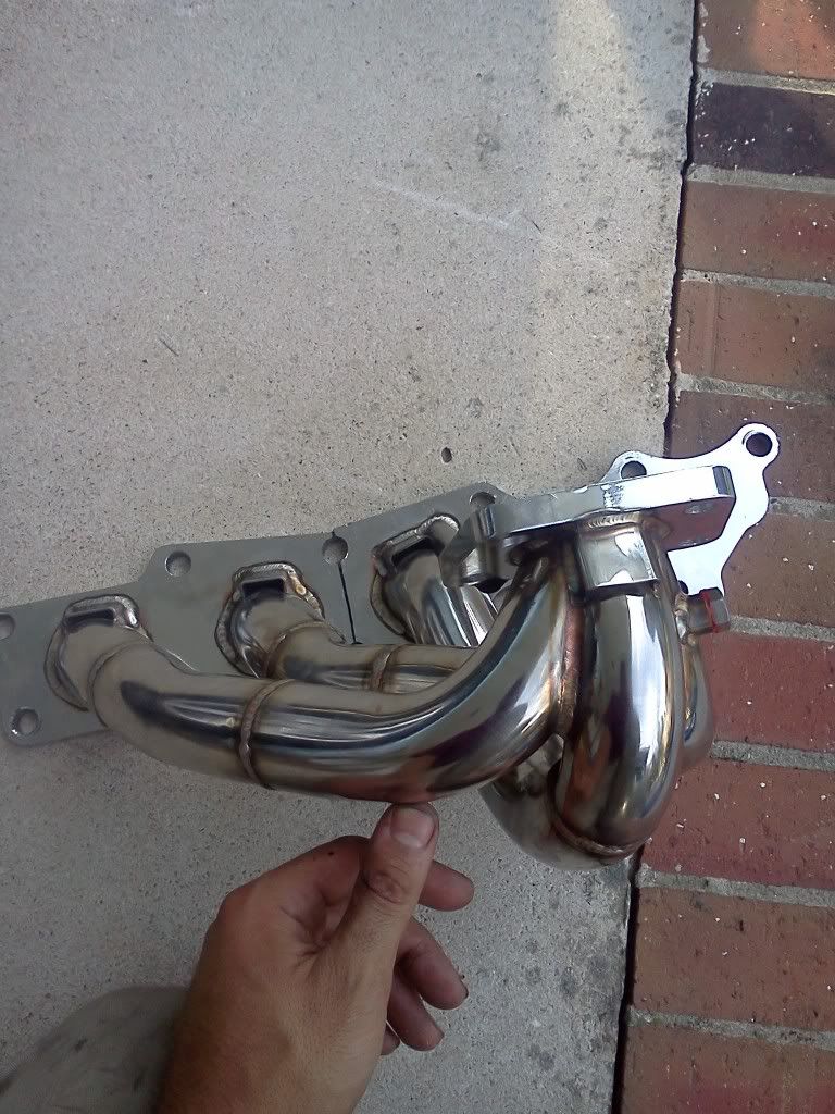

BigRedSpecial 09-05-2013 05:05 AM
I hadn't given any thought towards collector design until I read this, so I took a look at my rapebuilt... sweet jesus; the collectors are coming together at a 45* angle.
Koke382 09-05-2013 08:28 AM
Wowzers
I need to donate
Sent from my SPH-L900 using Tapatalk 2
Matrix311 09-05-2013 09:29 AM
Is that good or bad?
BigRedSpecial 09-05-2013 09:34 AM
Bad according to this thread... You want them to merge as gradually as possible
Here's the best picture I have:
http://www.mazdaspeedforums.org/foru...621_005100.jpg
LumberJack 09-05-2013 10:00 AM
Below is a picture for demonstration and representation purposes. Notice how long the merge collector is and the longer sweeping angle of entry into the merge collector. Regardless of the platform this manifold is for in the picture. It dictates and extremely well designed and flowing merge collector.
Sent from my SPH-L900 using Tapatalk 4
BigRedSpecial 09-05-2013 10:16 AM
For comparison:
FullRace (best pictures I could find, but they do show the angle WRT the flange plate):
http://i14.photobucket.com/albums/a3...content-19.jpg
http://cdn1.bigcommerce.com/server30....1280.1280.jpg
CP-e:
They all (FR, CP-e and AFI) all merge at a very shallow angle. Compare that to the XS Power or my Full Race... saying they merge at 45* isn't that big of an exaggeration.

Install is complete. Couldn't fire her up because it changed the position of my turbo slightly so I have to get a different coupler.
@LumberJack;
You must have gotten a pretty messed up manifold, because I will be honest...install was an absolute breeze. Went on like a stock mani.
Cross your fingers for me that I dont have a leak!

ATP gtx3071...so same exact compressor housing as you. That bolt by the turbo was definitely close but I got it on in like 30 seconds. I also unbolted the DP from the catback for wiggle room which helped. Did the whole install solo as well.
Also, if you didn't use it last time...trust me, use copper spray. That shit is amazing at stopping leaks before they start.

Reused the gasket..so we will see. If there is a leak I will be getting a new OEM gasket and replacing it. I know you are supposed to but I have reused it before and it was fine. We shall see.
h0ckeyman 09-06-2013 11:04 AM
Ok so, my boy Lukasz is always clutch and had a coupler for me to use for now. Thanks again man.
NO LEAKS! Thank god.
So I took it for a spin. Spool is definitely quicker, not AFI quicker but noticabley better. I also took a quick log and goddamn. VD is showing about 25WHP more than I have ever shown on VD. WG duty % is down 5% up top as well. Now this is only one log, and its a nice and mild day today, but VD is showing 385whp, I usually VD 340-360whp, I always take logs at the same stretch of road as well. I am not saying that it is conclusive that this mani has given me performance gains...but it's looking good so far.
Overall, @LumberJack; I think my results are just as trivial as yours. We need more testers! Just one result is only a small piece to a large puzzle. I hope you get another mani to try because I suspect that the one you had never sealed correctly to the head or something. My install was so much easier than yours too. Maybe the head flange on yours was slightly warped or something. Also, dude...use copper spray! That shit is amazing.
I have a lot more testing to do over the next couple of weeks and I will let you know my final conclusions but I like the mani so far.

Well glad to hear everything worked out for you and you're showing improvements in your logs because like I said I saw 0.
I hope I can get another one here quickly because my car is getting so bad and loud its almost undriveable. I've texted @StayBroke; again last night requesting another like Kevin asked me too, but no response. Hopefully he can get back to me.
GL with the rest. If I get another one ill have it in quickly with new gaskets and copper spray thanks for that little added tip.
