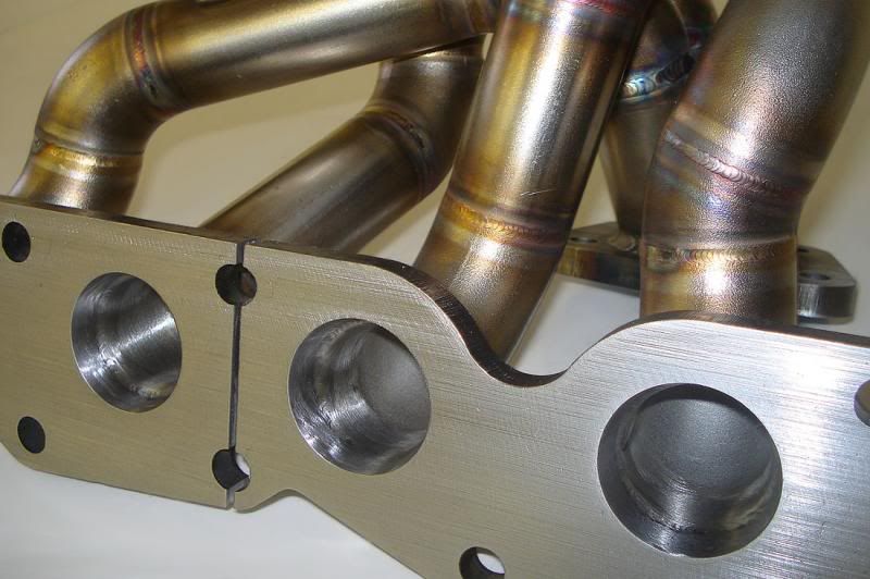

Below is a picture for demonstration and representation purposes. Notice how long the merge collector is and the longer sweeping angle of entry into the merge collector. Regardless of the platform this manifold is for in the picture. It dictates and extremely well designed and flowing merge collector.

For comparison:
FullRace (best pictures I could find, but they do show the angle WRT the flange plate):
http://i14.photobucket.com/albums/a3...content-19.jpg
http://cdn1.bigcommerce.com/server30....1280.1280.jpg
CP-e:
They all (FR, CP-e and AFI) all merge at a very shallow angle. Compare that to the XS Power or my Full Race... saying they merge at 45* isn't that big of an exaggeration.
