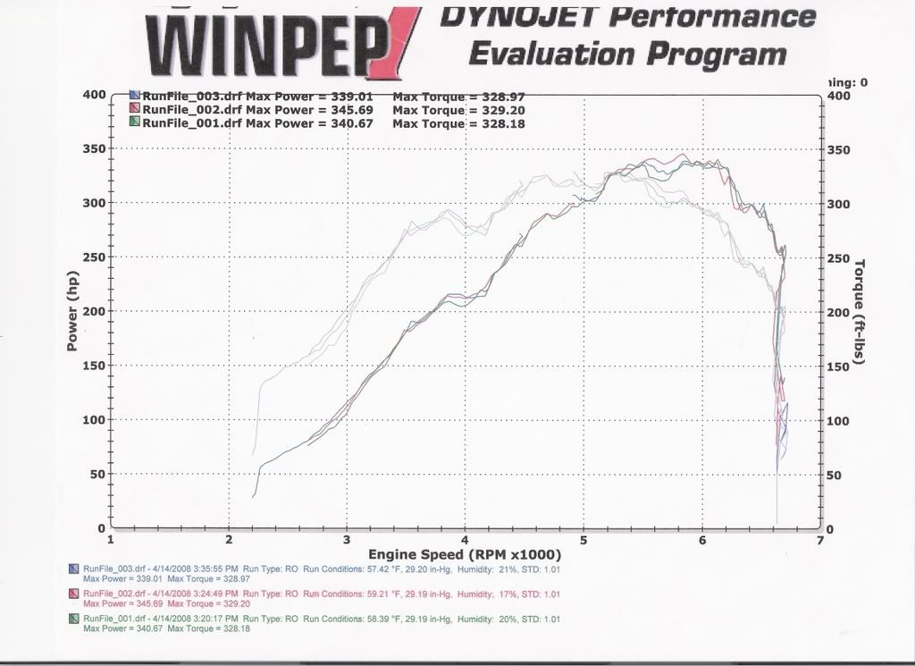

Young Roids 05-07-2008 11:50 AM
According to cobb there is no throttle plate closing problem and the dropoff of power is due to the turbo running out of air. So I will ask in this thread are you guys with big turbos making power till redline?
enganear 05-07-2008 12:09 PM
I have driven Paleriders beast. It was pulling like a scalded ape at 6600 rpm in 4th with no signs of dropping off, in fact it seemed to be pulling harder as the tach climbed (or maybe I was running out of 2-lane road, its all a blur....).
-enganear
phailerider 05-07-2008 12:27 PM
It does in fact fall off after 6400 rpms... but only down to about 300whp.... then the real drop off is after about 6600.
http://i253.photobucket.com/albums/h.../346whprpm.jpg
