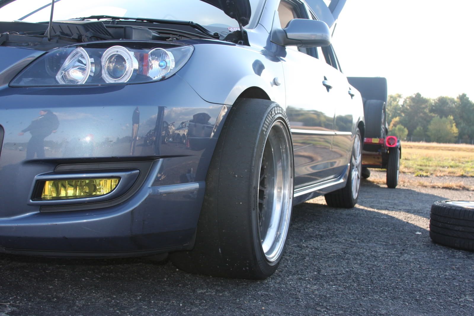

Lymerock 10-29-2008 04:47 AM
Originally Posted by udontknowjack (Post 98642)
damn...i couldnt agree with u more on this chris.....unless u jam some 285 in the front u will have no chance in sm
dont stop at the 285 ;)
the 315 is almost the same diameter as stock, 285 is a hair closer though.... mount tire, bring sawzall. thats not what ya want to do? well then dont play in the big boy classes (dsp/sm) or get used to loosing bad (nationally)
http://i5.photobucket.com/albums/y17...3/8f7664da.jpg
i was thinking seriously about going to dsp, but to do it right, you better have a budget the size of Crazyitalian
especially since custom lower control arms may be legal in 09
