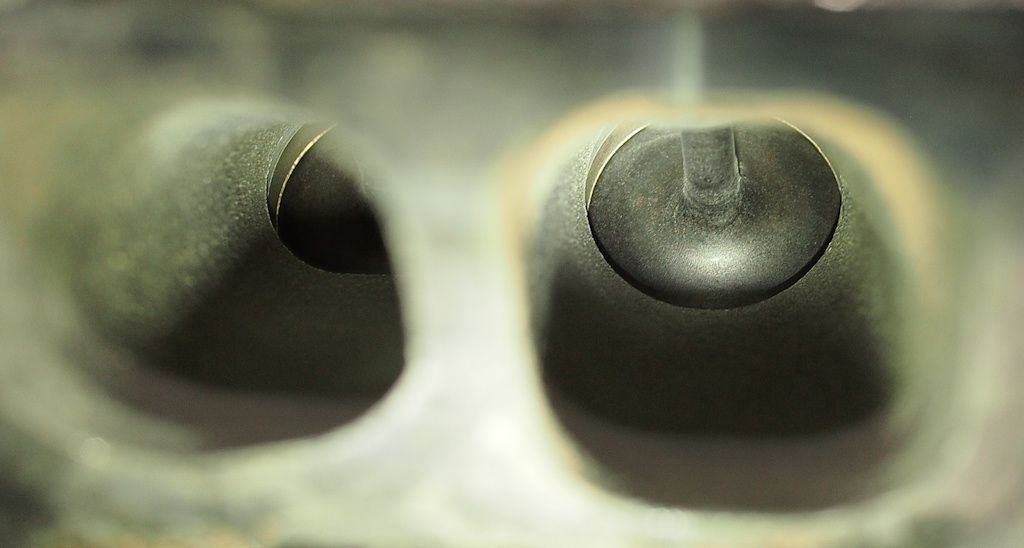

Due to the nature of direct injection, these engines will accumilate a large amount of carbon build-up over time. The only way to remove it is manually scrubbing, or media blasting the valves. Using seafoam/engine cleaners/ect will not do anything measurable to this buildup, this cleaning is basic maintenance in order to keep your engine running at its best.
Do this every 40k miles, and I also recommend deleting the EGR valve, swapping your PCV valve, and installing an OCC kit at this time to keep the intake manifold clean

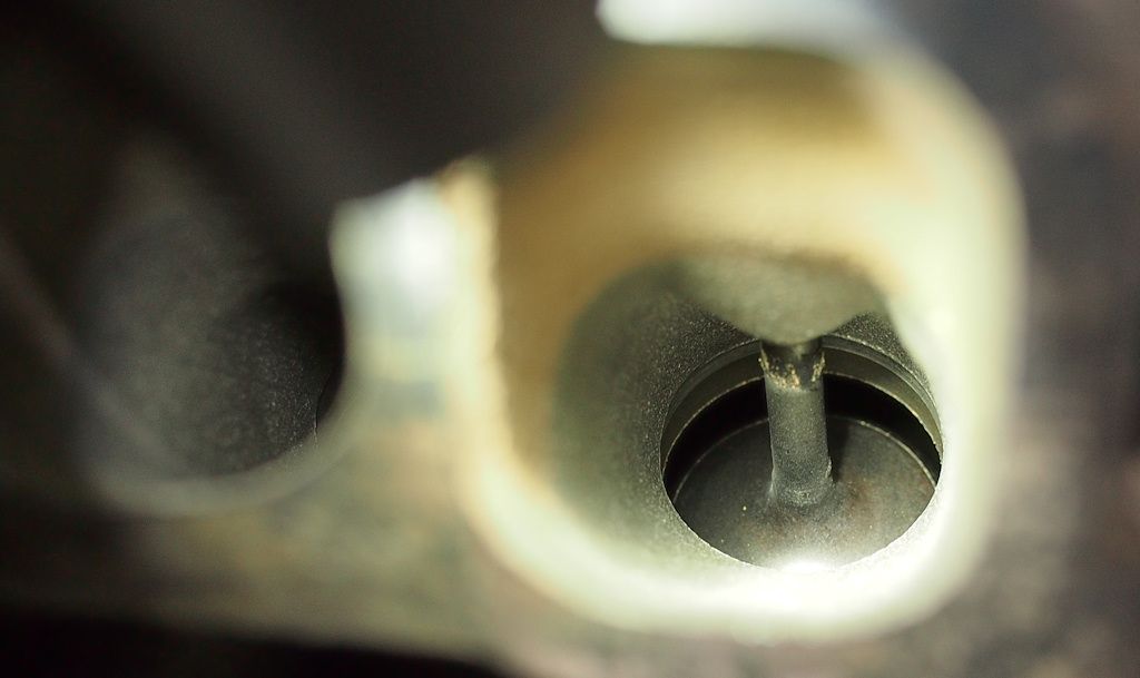

Why clean? Better performance (recovered flow), smoother idle, smoother driving, save money, and to learn about your car!
Here is the BEST method for cleaning your valves: before/after soaking/after a little blasting

In order to achieve these results, the process goes as follows:

Blasting was done in pulses of 2sec for about 30 seconds total, then the valves were nearly spotless! Of course, I kept going to make them shiny and pretty, but honestly, this can be done on all the valves in under 10min.

Did my car yesterday! 50k miles, so it had 3-4 times more shit than on OP pics. Really, it was coming out in pieces like 1/8" thick. I cannot imagine cleaning it out without blaster. Even with blasting it required scrubbing to break some hard spots.
So here is the end result:
Say a-a-a-ah!

damn thats way cleaner than i did, congrats

that looks good as hell good job,how long does took you??
memin is offline   Reply With Quote

14 hours from first bolt to last nut. Including 3-4 hours for B12 soaking and 2 hours to put back damn serpentine belt - crowfoot wrench and breaker bar were what finally did it. The main part, blasting took about 3 hours.
