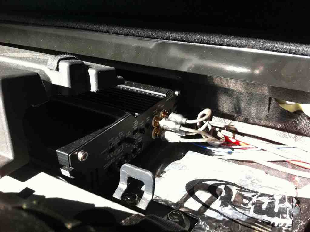

All the wiring around the two amplifiers (Subwoofer and Main).
http://i1139.photobucket.com/albums/...ears/Car/4.jpg
