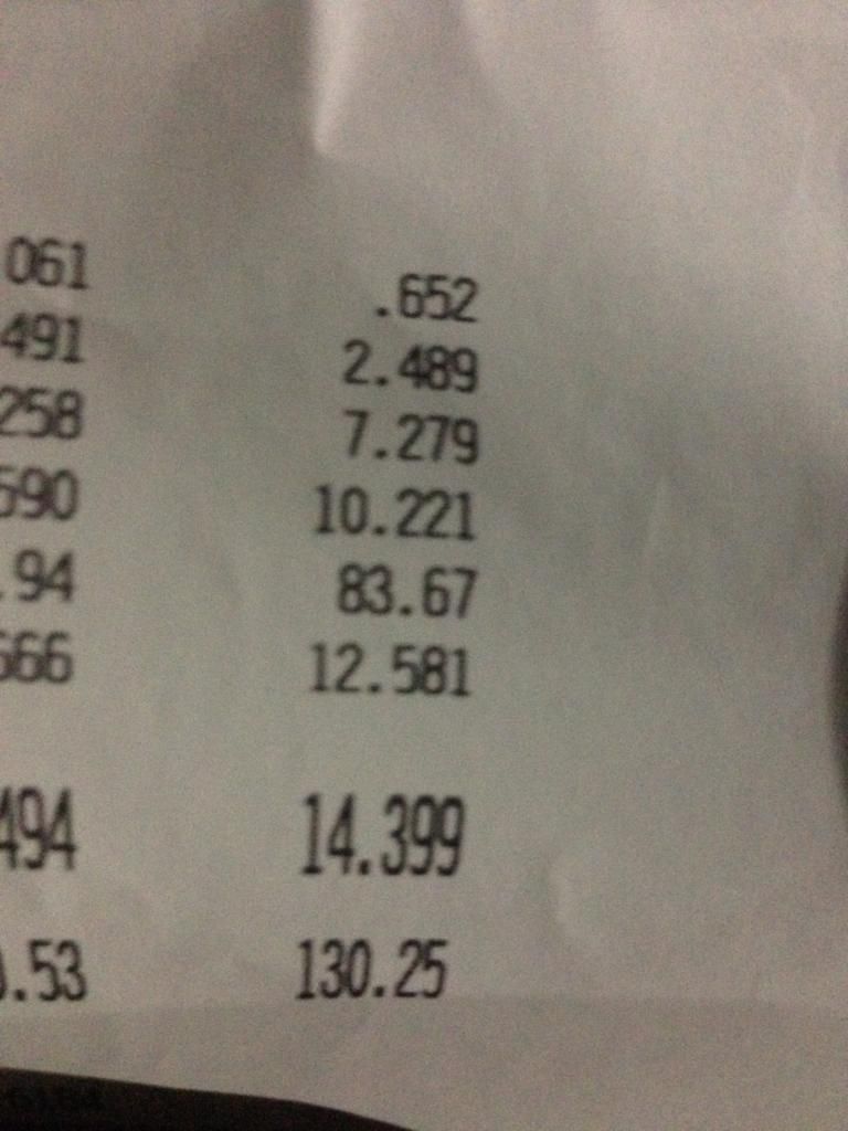

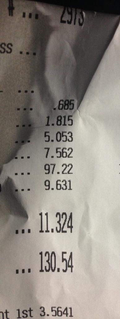

Welp, mildly successful, but completely infuriating weekend. The short version is I got to make 2 passes with the new setup. First was an epic driver fail and ran a 14.399 with an amazing 2.5 60'...@130.25mph. Second run was much better but then I completely blew the head gasket and burned all my coolant out the exhaust at the 1000' mark or so. Even with all the fail the car managed a 11.32@130.54 on that pass. Super pissed that it couldn't just stay together the whole run though cuz a 10.9x @135 was in the bag, I just had to ride it out, but nooooo the head didn't wanna stay on yet again.
Slips and in-car video below. I'll post videos from outside once I get them. The outside videos are pretty good.
Won't have a chance to assess the damage for a week at least and no idea yet what's plans are moving forward. I'm out of play money after doing two full builds this year and I'm just done building it KNOWING where the week spots are and not being able to do anything about it. Oh well.

I'd say you lost both runs... pretty badly. :)

Good stuff, amazed it did 1.8 on the 2nd run the way it bogged, lots of potential..just weld the fucking head on and be done.

Yep, so I have very little actual in-car experience drag racing, but from watching tons of guys here on MSF and reading a lot of tips from guys like @rodrigo; and @Darksun280; I think the biggest reason most people have 60ft problems is because they end up shifting to 2nd before the 60ft cone. I think that's probably where the most time is lost, not carrying out first gear far enough. Luckily with this gearing, I get probably an extra 10ft out of first gear, so I was able to get well past the 60' while still pulling through first gear.
There's still obviously a ton of improvements I can and will be making, but yeah as far as the head goes, I will literally be swapping motors if I can't find a way to keep the head gasket happy this winter. I'm still holding out hope on a couple ideas I've got bouncing around though, so not giving up quite yet.

You are a hot mess where do I begin
1.81 is acceptable for now untill you get more comfortable
3.2 seconds to get into 2nd gear is terrible. You gonna have to get the timing down to snatch 2nd faster. you killing the momentum of the car. turbo probably falling all out of boost on your shift lol/ That .2 -.3 tenths you are loosing down low is really hurtling your E.T
How dare you pic up 33 in the back half but only trap 97 to the 8th. You should be doing 101-103 to the 8th. That means you got no momentum for the start of the race. You not getting that sling shot effect. a snappier 1-2 shift or more tire or less weight probably need one or the other.
I showed this vid to ant but you need to see it too. Video your self banging a 1-2 and there compare it to raif.

Lol. I would expect nothing less from you in the criticism department, and that's what I like.
I couple things in my defense. As far as the 1-2 shift goes, I could definitely use work, but there are two things that were working against me on this run that I couldn't control.
1. As much as I do love this gearing and think it makes it considerably easier to run a faster time than using the GEN1/ 6 gearing, it's not a close ratio trans at all. If I had a little more rpm to use in 1st, it would help me hit 2nd gear at a more reasonable rpm. Right now, I drop from 7800 at the top of first to just 4100 grabbing 2nd, just from the gearing.
2. Being my first time with the WOT box at the track, I really think the Ignition cut time is a little too long because there is a distinct delay from the time I grab the next gear to the time the car picks back up again. I'm not talking turbo lag either, it feels different, more like the old post-shift stutter type issue. I previously had the WOT box on Auto which cut for up to 350ms, but I had lowered it to 175ms for the track. I feel like it helped some, but could still bring it down even more.
As for the 1/8 at only 97, that's a product of me running too low of boost in 1st and 2nd gear, having a slow 1-2 shift, and not really getting back into power due to gearing until 95-100mph in 3rd. Again, the gearing is great but there are still some slight trade offs.
Lastly, with the speed on the back half, I should have easily picked up near 40mph on the back half, but after looking at the logs, I really lost all power just before 7k rpm which is where I'm right before peak power normally. I mean shit, I picked up 47mph on the back half in the first garbage run haha. On this run, I really should have been banging rev limiter in 3rd through the traps at ~136 but I had to bring the fail at the end of the track.
With all that said, keep bringin the criticisms and ideas on how to get faster, so I can show you DSM's what's up at the Shootout next year :)
EDIT: I fully plan on the car getting more tire and less weight for next year, so anyone with suggestions for the tire or areas for weight savings, please let me know.
