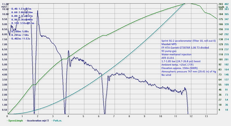

It had been the greatest drag event of the year in Ukraine on saturday 150 miles away of my home. It was way better traction there - aviation concrete versus slippery asphalt I've used to. So I had to raise LC revs from my usual 5,800 to 6,600 to wheelspin. Though I still had wheelspin to the end of 1st gear and missed 2nd gear several times. It's becoming my headache - I miss 2nd gear every time it wheelspins at 7,000+ rpm :worried:
So I've managed to drive the whole distance only three times and each time I had random problems like fuel cuts and limiters. And there still were rich AFR and relatively low boost.
The best run was 11.4.
Now I have several ideas of further time improvement but they all need some time to be embodied so I'll let myself take a lil break.
Though that track has both speed trap and 60ft sensors, they neither showed them to people nor even installed the clock they have :worried: They told only ETs.

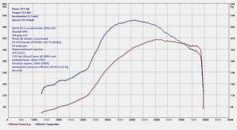

Seriously, I didn't understand what do you mean.. CP-E HPFP still holds 1750 psi to my current rev limiter, injectors aren't maxed out and also 625 ml/min methanol nozzle helps with 75:25 mixture.
I don't know my actual power in 11 sec runs since last time I visited dyno before 12.01 sec run.
And I actually had rich AFR in 11 sec runs, especially in the last ones - you could notice contunious black smoke in my last video.
I'll visit dyno soon I hope, but I already calculated my power approx by acceleration/weight. I'll post some graphs later.

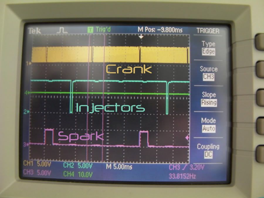

I'm not sure how your measuring dutycycle, but with direct injection, you only get half the normal window to inject fuel (even less when you take into consideration spark advance).
So perhaps your 45% IDC corresponds to 90%????
The AP reports duty cycle appropriately (at least as far as i know), and many people have kissed the 100% mark, and even gone above it a few times. They're probably spraying during combustion.
As RPMs increase, this problem is exaggerated. Increasing fuel pressure helps, but is limited to the relief valve crack pressure of 1885 psi. Bigger injectors aren't available yet. And 5th port injection, like your doing with the meth, is probably the simplest solution. Your 625 ml/min nozzle is probably very similar to what most of us are running (d07) with bigger turbos.
Here's a lil video showing the injector pulse width on a ~360awhp ms6. You can see first hand how the injection pulse width gets very close to the spark.
Here's a pic showing which trace is which:
http://i359.photobucket.com/albums/o...scopeshot1.jpg
Here's the video:
wot.mp4 video by djuosnteisn - Photobucket
If your running stock injectors, and stock fuel pressure, your probably getting pretty close to the limits of the stock fuel system.
Do you have any issues with spark blow out?
My device (MAF Emulator) simply reads absolute injector duty (% of injection time at 4 cycles (720 degrees) period).
From that you've written about AP logging and its ability to show 100%+ values I can make the conclusion that it utilizes the formula to show some 'useful' injector duty, like:
AP INJECTOR DUTY (%) = ABSOLUTE INJECTOR DUTY + (SPARK ADVANCE deg / 360 deg * 100%) + 50%.
In example, some engine sprays fuel strictly till the ignition and it has 18 degrees of spark advance. In this situation my log would show absolute injectior duty = 50% - (18/360 * 100%) = 50% - 5% = 45%. While AP log would show 45% + 5% + 50% = 100%.
Since I already saw 46% of duty in my logs several times with some 18 deg spark advance I believe I've already kissed 100% AP injector duty lol
This is bad news for me.
But good news are that I was running very rich AFR and middle size methanol nozzle. I can still try 12.0....12.5 AFR, some 1000 ml/min methanol nozzle and 100% methanol itself.
Or do you already know some safe way to rise the fuel pressure in the rail ?

While tuning the car at July 2011 I've made 'dyno run' with accelerometer Sprint SG-2 (like G-Tech) on public road. It calculates power by acceleration taking in consideration multiple parameters like weight, chassis rigidity, gear ratio, air resistance etc. But it knows nothing about the ambient air temperature and density, so such run should be considered as uncorrected.
http://mazdagarage.com.ua/pat/www/110713x800.jpg
Two days past I've ran 11.393 with the same setup and tune. I simultaneosly wrote the logs with MAF Emulator (it was posted earlier http://www.mazdaspeedforums.org/foru...49/) and the same accelerometer Sprint SG-2 in 1/4 mile mode (Sprint SG-2 - ..).
With roll-out 0" set it showed little worse time than Race America with its 12" roll-out.
http://mazdagarage.com.ua/pat/www/110715x800.jpg
I've dynoed 434 awhp corrected only at September (http://www.mazdaspeedforums.org/foru...433-wcf-90975/) and actually never tried that tune at quarter mile. 434 awhp were shown with higher boost, leaner mixture and more advanced ignition.
