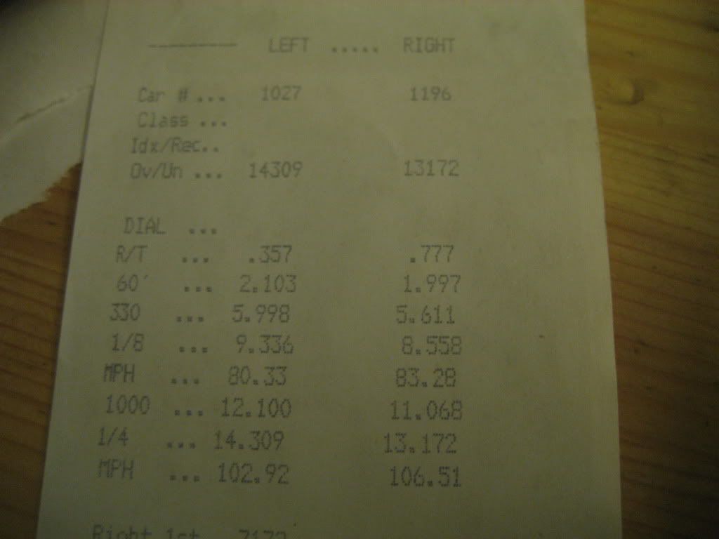

here is the first pass after reviewing what I realized I was doing wrong on launches....(rolling out too softly rather than coming into the throttle harder and quicker)
julio vs me again
his 14.3 @ 102 (missed a gear) vs my quickest pass of the day 13.1 @106.xx 1.960ft
after this pass the next and last 2 for the day were 1.9 60fts as well..... basically 2 major things I was doing incorrectly, my burnouts , because they are first gear and dont generate enough heat needed to last longer.... and my launches increased to 4k, 4200 and 4500 and practically went WOT immediately after slipping the clutch out of the hole..... it worked.
