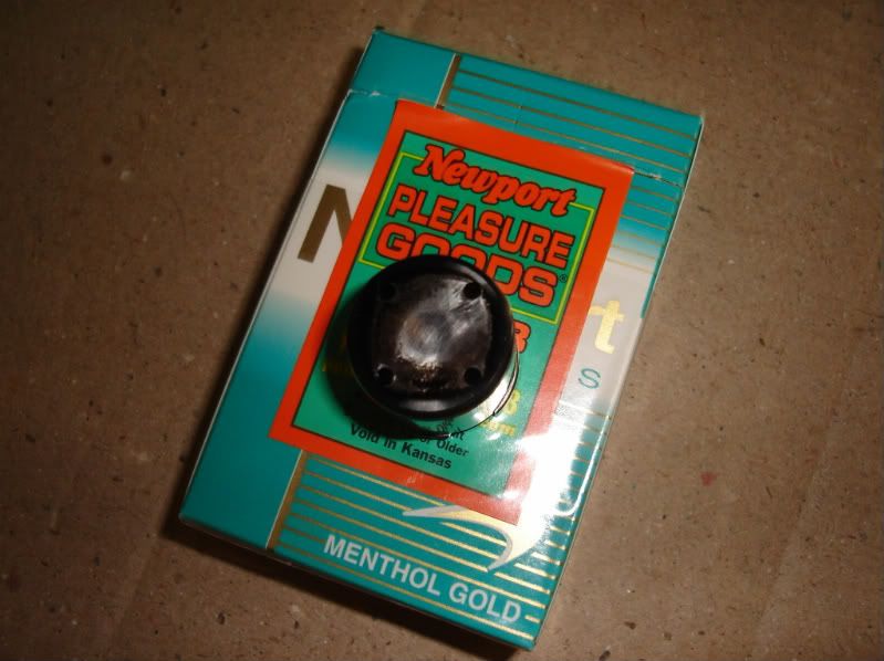

Thanks to owning a gti, and my relationship with cpe... ive come upon some info, you all may find intersting.
Bottom line..... kmd/ autotech replacement internals for HPFP's have been having a few issues in the VW community. People have been taking their pumps apart to inspect the wear after some mileage and apparently the cam followers are wearing really badly when using the KMD internals, and instead of fixing the problem KMD now offers a replacement cam follower for $90, and they say it only 'slows' the wearing of the follower.
kmd cam follower - VW GTI Forum / VW Rabbit Forum / VW R32 Forum / VW Golf Forum - Golfmkv.com
APR pump follower after 10k miles:
http://i32.photobucket.com/albums/d9...llower10k2.jpg
KMD follower after 13k miles:
http://i32.photobucket.com/albums/d9...a/DSC00759.jpg
Also, KMD has released their "V2" as they call it, which is a TOTALLY redesigned kit. I imagine that might worry some people to know that KMD had to totally redesign their kit. Apparently the pump seizes and the piston shears away from the plunger, which is obviously no good. The KMD kit seems to be the "go-to" kit as far as internals go, but I've never even heard anyone bring this up yet in the Mazda community. It will be interesting to see what happens, as the vws were far ahead of us as far as these pumps going out. Incidentally, as far as I know, the APR pumps have not had any problems whatsoever. That includes both the vw versions, and the cpe/mazda ones.
KMD HPFP rebuild V.2.0 - VW GTI Forum / VW Rabbit Forum / VW R32 Forum / VW Golf Forum - Golfmkv.com

Anyway, these examples are EVERYWHERE.... The Autotech and KMD internals are rumored to be the same parts too. They were "revised" at exactly the same time, and in the same way. That's speculation, but it seems pretty odd anyway.
Has anyone looked at their cam followers after getting some mileage on their KMD pumps. Also, if it isn't common knowledge.....the pumps were redesigned at some point, you might might want to find out if you have "V1" or "V2".
Originally Posted by Kid55
Hi guys,i did search but nothing solid came up.
I would like to know how do you know if you have the Revised/Ver2 KMD hpfp? Or if KMD started selling the revised version a while back already,that would rule out the possibility of the old version still being sold.
you take a picture of it post it up and I'll tell you. The ond version on the piston was a uniformed color the new one has two different colors. on the end of the piston specifically is a dead give away not the tip/plunger side the other end that works the comrpession has a flat bottom with a darker grey section then it leads into the uniformed colored piston.
And again, finally.... the CPE/APR pumps that many of you have been getting from me or cpe, to my knowledge have not been having any problems. In the VW community, the vast majority of gtis use the apr unit, and there havent been any failures. In the mazda community, as weell... CPEs rebadged apr pumps, which are weight balanced and individually flow tested just simply seem to be holding up better.
For a long time now, ive basically said and felt that the CPE unit was not necessarily a better bet. Maybe it was, in theory only. The results didnt necessarily indicate that there was much difference tho. That, for me, now changes. Even the comments Jon at ptp has made about his observations now have alot more weight. I never thought id say that, but now i am. Anyway....I thought you guys should know.

due to the nature of my relationship with both Ken and CPE.... i dont want to weigh in much more to this discussion. I used both pumps on my car and i never had issues with either. If the kmd/autotech internals that have been sold as "kits", in this community were gonna fail...it was always my believe that it would occur immediately.
Im in communication with LOTS of dudes, and i have not heard of any internals failing over LONG TERM use, in the mazda community. that needs to be clear at this point.
But... again, that doesnt mean it has, or hasnt been happening. this thread was to bring up discussion for you all. I sell apr/cpe pumps and i dont want this to be construed as some big sales pitch. Obviously mine cost a hell of alot more, and that may or may not be worth it. Thats for all you to decide.

I had my CPE pump in for about 8K before the motor blew and my follower looks flawless. i'll post pics tonight.

I have read up on the VW issues as a friend has a GTI. The worn follower is a big issue and the car will not run right. The Mazdas are only seeing noise at this point. All pumps becides CP-E's use this kit. I am curious as to what PTP is working on as well as Kevin "Haltech" because according to his signiture he runs his own pump.

I am pretty sure when I looked in the Mazda head with my pump removed there is a 3 pointed rocker that is the very end of the cam shaft. The VW failing followers are in the head not inside the pumps right. When building the Mazda pump I didn't remove any bucket shaped followers like I remember the pics of the VW being.

the world is definitely not coming to an end here, i just thought it would make for interesting discussion if some of you guys with some older pumps took a look.
john at ptp, has been harping BIGTIME on this and i always felt it was nonsense until i did some digging. jordan had talked to some engineers at apr, and apparently it is a VERY big deal with the vw guys as far as competiton goes. I dont think we have the same issues here, just cause bottom line is that, at least in the short term.... these pumps have not been failing. i know Phil said he knew of some... i wish hed share. ive not heard of that.

yea when i did my pump i never saw a piece that looked like the ones in the pictures

thats cause its in the head and u diddent need to remove it to swap pumps or internals

so if this piece is not one that we are swapping how is it being affected? do the new internals put a different stress on them? or am i just mistaking parts for something else?
it isn't in the head. If he saw the triochial lobe with the pump off and in his hand, it's not even a part of our set-up. I have not looked myself though.
outside of the head there is a separate chamber for the fuel pump lobe. the separate chamber has the cam follower in it. I have my valve cover off and that chamber removed, I'll snap some pics tonight.
