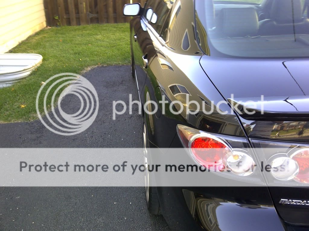

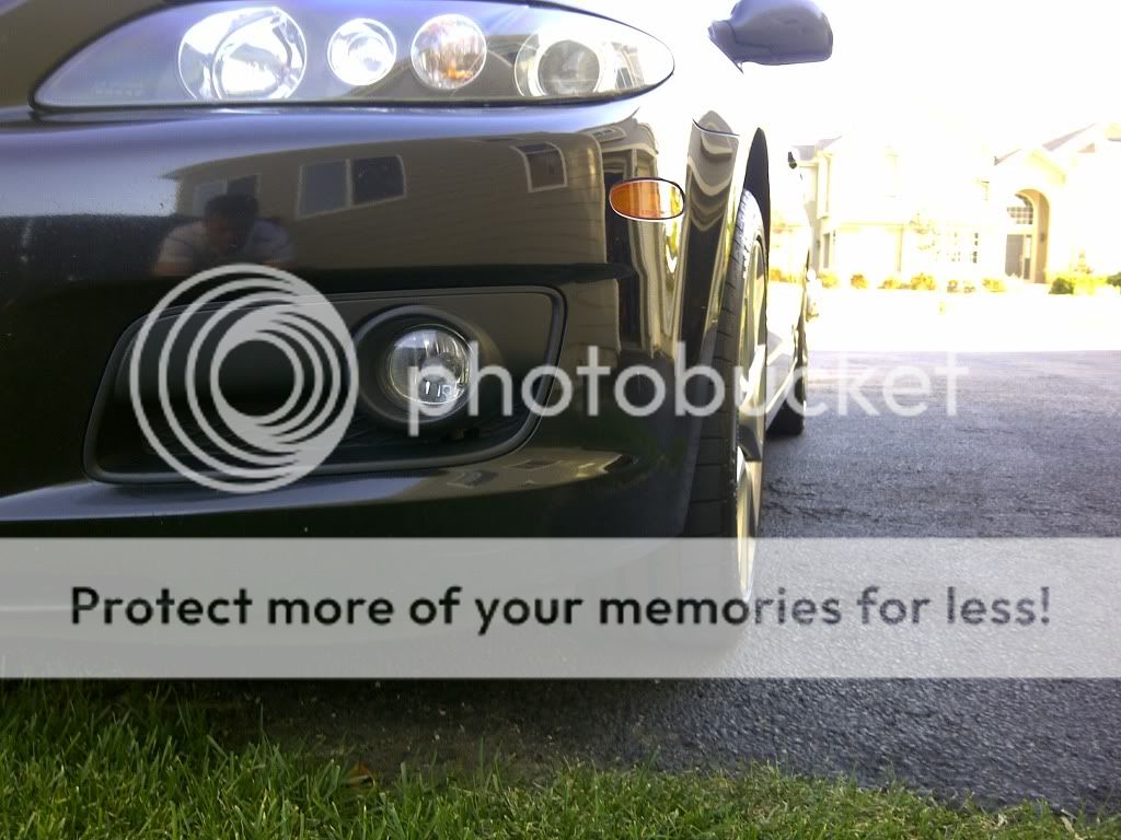

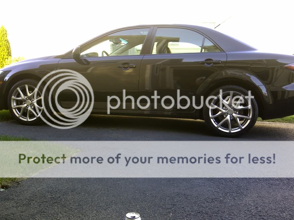

OK. so the 40th anniversary rims are on. I think they look perfect fo the car. I know it needs "moar lower" but that will come in time. The RX8 Wheels are the typical 18x8 +50 and they have PS2s on the front and Toyo R1s in the back. Fronts are 235/40/18 rears are actualy 245/40/18.
At this point NO rubbing, but I hardly ever drive with ppl in the car as it is my daily. It looks like to do 245s on the next set of tires I should to a moderate roll of all the fenders just to be safe. I have to admit these rims fit perfectly for this car (almost like they should have been there from the factory) and the are nice and light. Plus being a rotary guy, its cool to see the rotor design in each of the spokes.
Here are a few shots of them on my car.

You have Black Mica Speed 6 not black onyx thats the color name on the regular 6. Also its not a great idea to be running different size tires on awd car the height has to be the same all around.
I gotthatzumzum 10-26-2011 05:31 PM
Looks decent but different size tires on an awd car? May want to do some more research before you drive for a long time with those...
Masterofnone 10-26-2011 06:13 PM
^^^^ this, your rear tires are a full inch larger in circumference than your fronts. That can't be good for your PTO.
maritime ms6 11-12-2011 12:11 PM
Rims look good but I agree with previous posts, might be running into trouble in the future with differents size tires front and rear with awd.....
