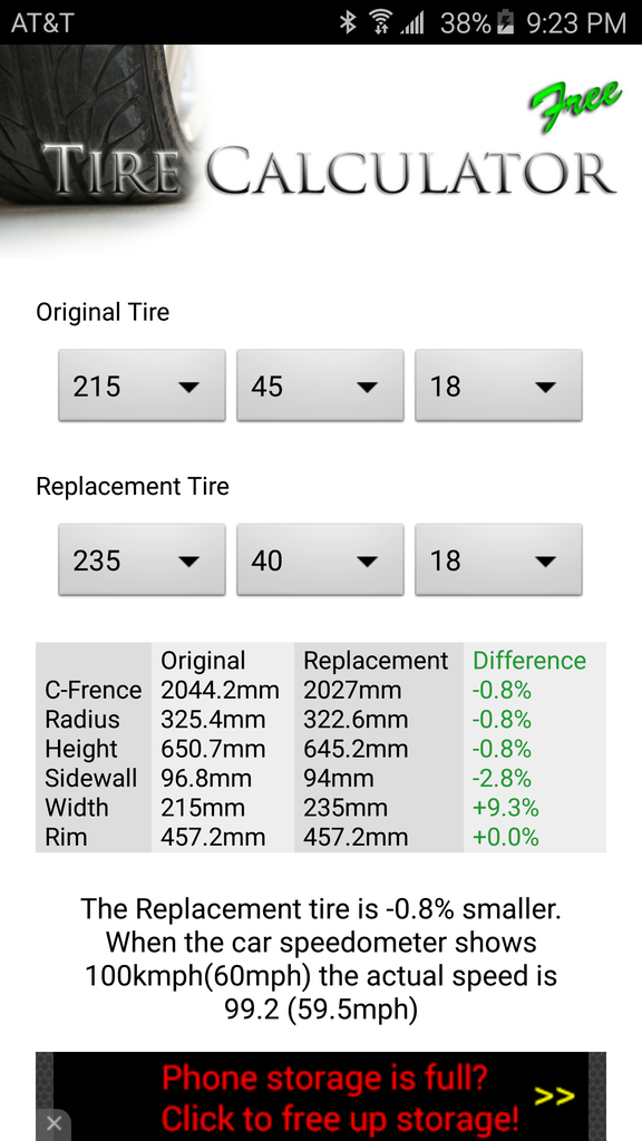

ArmanRus 06-20-2015 08:10 PM
I would do 18 x 8 +45 with 235/40 tires. That will put you much closer to the OEM diameter so you're speedo won't be off by much. If it does rub in the rear (I highly doubt it will), it's very easy to do a mild roll on the fenders.
ssspencerjr 06-20-2015 08:12 PM
Thanks for the information. How does this affect ride and performance with a narrower sidewall?
ArmanRus 06-20-2015 08:28 PM
It won't have a narrower sidewall (don't forget that it's a ratio) from a 215/45/18. Well technically it is narrower by 2.8mm, but that's splitting hairs. A 245/40/18 will be much, much closer, but you will might want a wider wheel with a proper offset for that.
http://i282.photobucket.com/albums/k...0-21-23-41.png
Good luck!
ssspencerjr 06-20-2015 08:29 PM
Good luck!
Wider than 8 inches?
ArmanRus 06-20-2015 08:34 PM
Yeah. People usually run 18 x 8.5 for 245/40 tires. This is the set-up I have but if you're not willing to do extra work, stick with 18 x 8 and 235/40.
ssspencerjr 06-20-2015 08:35 PM
Thank you. I'll probably do the 235/40 setup It seems to be the max tire for the same overall dimensions per your advice.
