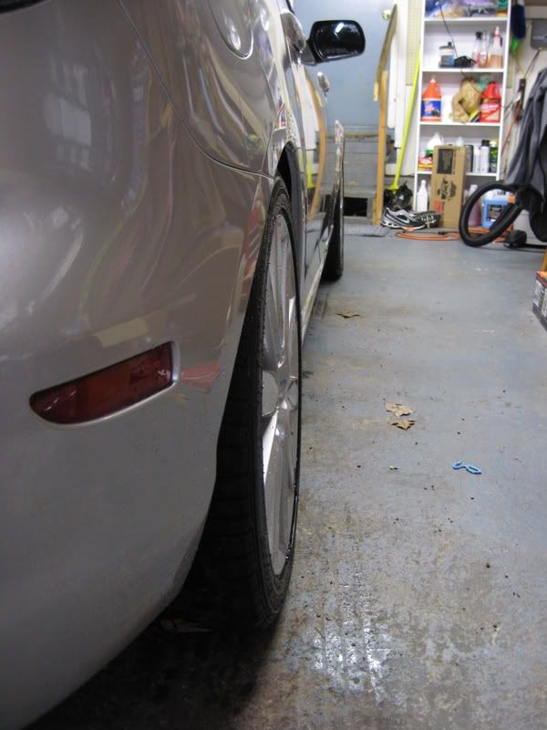

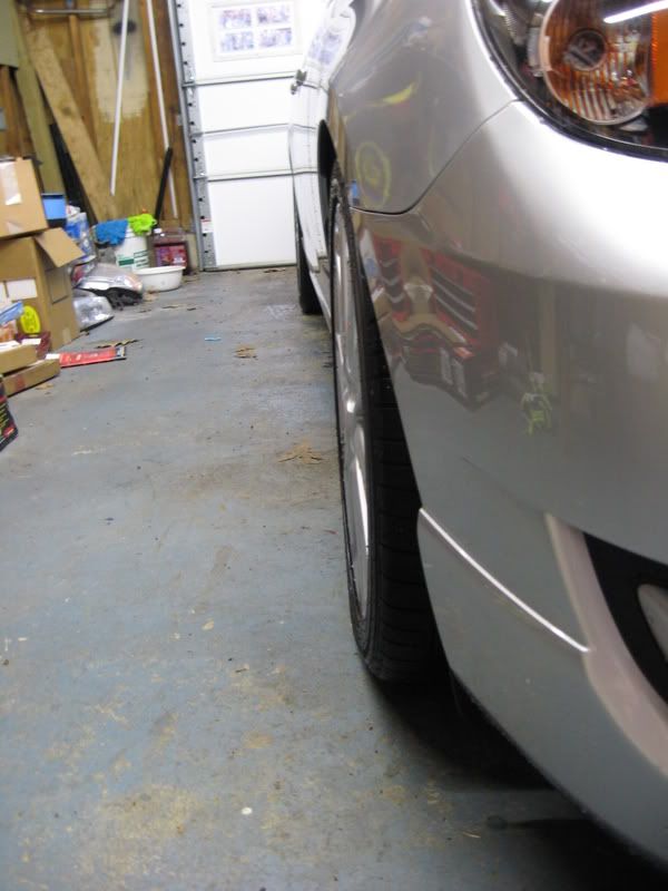

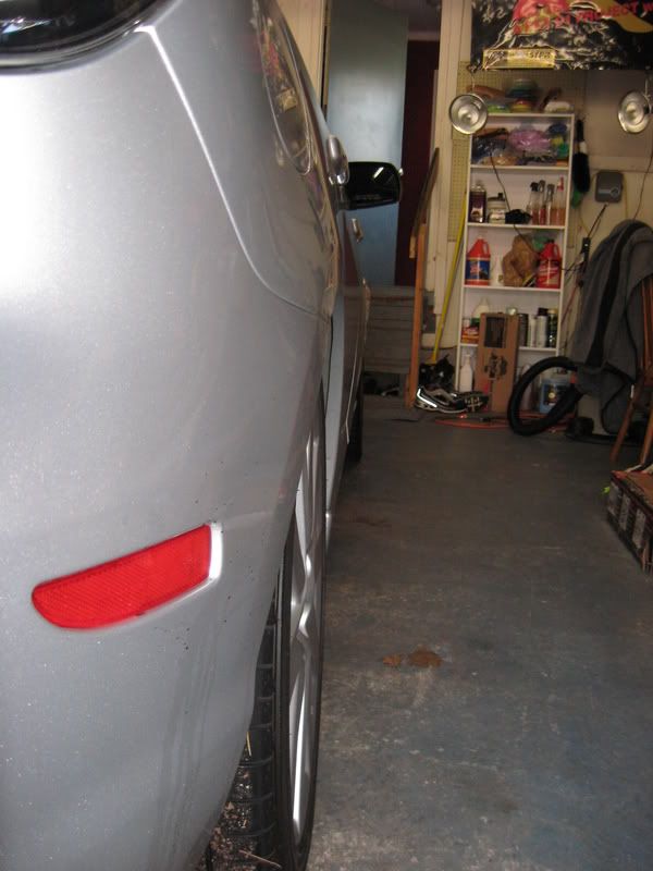

before-
http://i175.photobucket.com/albums/w...s/IMG_1714.jpg
after-
http://i175.photobucket.com/albums/w...s/IMG_1723.jpg
before-
http://i175.photobucket.com/albums/w...s/IMG_1713.jpg
after-
http://i175.photobucket.com/albums/w...s/IMG_1725.jpg
before-
http://i175.photobucket.com/albums/w...s/IMG_1183.jpg
after-
http://i175.photobucket.com/albums/w...s/IMG_1720.jpg

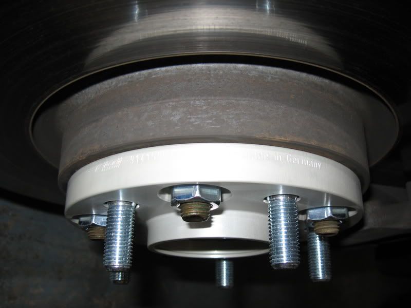

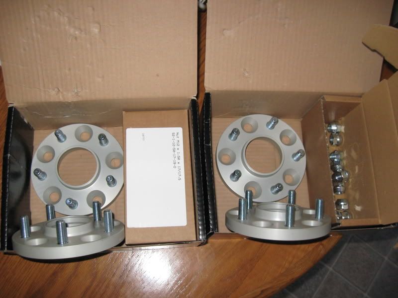

the spacers-
http://i175.photobucket.com/albums/w...s/IMG_1718.jpg
http://i175.photobucket.com/albums/w...s/IMG_1709.jpg
http://i175.photobucket.com/albums/w...s/IMG_1711.jpg
http://i175.photobucket.com/albums/w...s/IMG_1716.jpg
http://i175.photobucket.com/albums/w...s/IMG_1717.jpg
i'll get some better 'after' pics, but the wheels are significantly bumped out now. they do NOT rub under any circumstances; i drove around under all kinds of conditions and haven't rubbed once.
the setup this is equivelent to is a 18x7.5 42 with 225 tire, which is a common 'well filling' wheel combination.

IAM, yes, speak to Aaron at JSC!
regarding Ichiba or any other ebay brand...
these spacers essentially hold your wheels on your car, since they are studded. i trust the materials, measurements, R&D and machining of eibach. i don't use knock-off wheels, and i would not suggest using knock off studded spacers. if you were using regular hub centric spacers, with either the stock studs or longer studs, that is a different story, but this style, where it is bolted to the hub and then the wheel bolted to the spacer....i'd only run a mass market heartily R&D'd product.

doesn't the rim now sit on the end of the shorter studs.. instead of flush against the hub?
Nliiitend1 05-21-2009 08:50 PM
No. I believe they protrude into the "void spaces" on the mating face of the wheels, if that makes sense...
I would imagine there are some wheels that wouldn't work with these, depending on their design.
thanks...yep. you are correct as some wheels don't have those negative voids.
