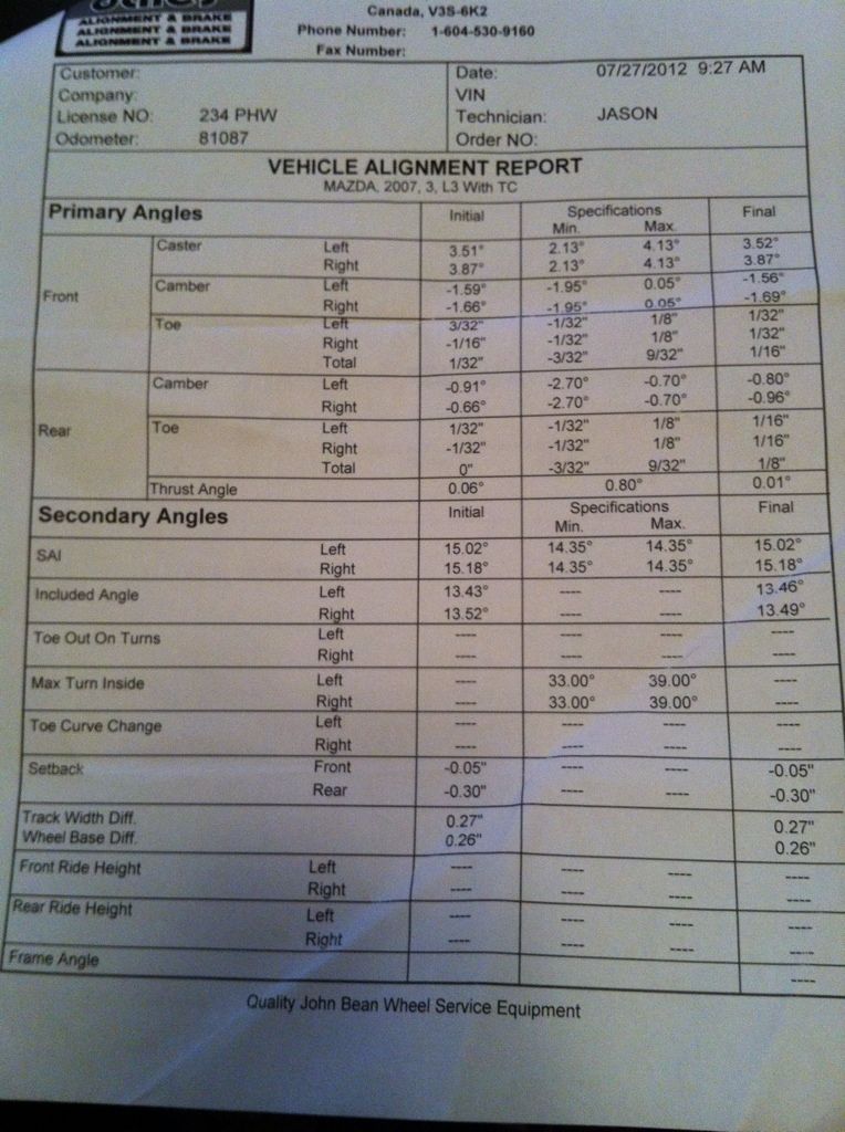

Bringing this thread up again.
I have a Gen1 and at the beginning of the summer installed Gen2 wheels with OEM tires. By the end of the summer, the inside edges of the fronts are basically done. That's in around 6k miles of spirited driving. I haven't had issues like this with my other tires on the car so I suspected alignment which was off so I got it realigned with very little toe in the front and rear.
COBB springs and Koni FSD shocks are installed. I have attached the alignment specs which are fine AFAIK.
However the wear continues.
For all you Gen2 owners, did this wear happen once you switched tires as well? I am thinking the Dunlop design with a very stiff sidewall is putting a lot of wear on the inside edge even with mild camber. Basically I want to narrow this down between either still looking at alignment or if it's a tire issue.
http://www.mazdaspeedforums.org/foru...1&d=1348783334
theurgy 09-27-2012 04:38 PM
Lex: Did you go see Jason at Dale's?
He and I have had discussions about how the "Mazda Spec" for the rear camber is way too wide.
That aside, I thought you weren't supposed to put any lowering springs with Koni FSD's?
Also do you have rear camber arms installed?

Lex 09-27-2012 06:07 PM

I did not see Jason and the front is actually killing the tires more than the rear but unless I get camber plates can't really do much. Toe is essentially zero. I do not have camber arms either since the COBB springs don't really lower the rear at all. The FSDs are valved just fine for the COBB springs, no issue there and the drop is very mild.
Nliiitend1 09-27-2012 06:21 PM
Check all of your bushings over and inspect them for play.
The dynamic nature of the rear toe (the way it changes more significantly through the suspension's range of motion than it does with many multi-link setups, providing a passive rear steer effect) on this car can definitely exaggerate tire wear abnormalities due to bushing wear.
The bushings in the "toe links" and the forward trailing arm/"control blade" bushings, as well as the camber arm bushings are all essential to that geometry functioning properly.
We all need to remember that static alignment numbers only tell us part of the story, and that there is a lot going on when the car is moving about which those numbers can't tell us much.

Nliiitend1 09-27-2012 09:13 PM
Originally Posted by Lex (Post 1652993)
Thanks for the tip. Most of the wear I am seeing is in the front however and there is nothing loose about the front suspension (or the rear for that matter). Any tips there? Is the camber really enough to cause severe wear in the front?
I honestly don't see anything alarming on your alignment sheet, to tell you the truth. :hmmmm2:
I run similar numbers (about -1.4° camber, ~4° caster, and 1/16" TOTAL toe OUT - in the front) and with regular (perhaps more frequent than most, at ~3K miles or so) rotation I don't have any issues with irregular wear...
:dunno:
Lex 09-27-2012 09:29 PM
:dunno:
Neither do I so this is why I am suspecting the tires are prone to it. I run 32/32 pressures daily.
@theurgy thanks for posting - your front alignment looks very similar and it looks like you have camber arms in the rear. Any strange tire wear and what tires do you have?

theurgy 09-27-2012 09:43 PM
No strange wear and I'm running Hankook Ventus V12 EVO's.
Lex 09-27-2012 10:37 PM
This is where the plot thickens. I found a local set of OEM Dunlops that are literally new that I am tempted to pick up to replace the current ones. I got one summer out of these tires (albeit I did need an alignment for a few k miles there) - but in any case I'd like 2 summers out of the tires.
Funny thing is that a lot of Gen2 people are having this tire wear issue along with regular Mazda5 and Mazda3 people overseas where the cars came with the same Dunlop 2050s. Something's fishy here.
theurgy 09-27-2012 10:51 PM
Very interesting and yes I know that deal for those tires.

FLip 06-07-2013 10:22 AM
Good Afternoon,
I bought my speed3 in June of last year. I currently have 15,000 miles on the car and my inner tire wear is massive. I took it to a local place to get it realigned, with the specs of 0 toe front and 1/16 inner toe rear. I took it home yesterday and my stearing wheel is off by about an inch or inch and a half. I called them today and asked about this and they said to bring it back in. They called and said with this current setup there is not much they can do with this. Has any one else ran into this? My specs are from the last alignment.
Left Front
Camber -0.7
Caster .....
Toe -0.01
Right Front
Camber -1.1
Caster ....
Toe 0.00
Left Rear
Camber -1.8
Toe 0.09
Right Rear
Camber -1.8
Toe 0.08
Do these numbers look ok? Or should I take it some place else?
(edit)
And Im sorry I should have said its a 2012. I didn't want to make another thread over this issue.
Nliiitend1 06-07-2013 10:56 AM
If they can't figure out how to center the steering wheel, you need to find a better alignment shop, IMO. :rolleyes:
El_Diablo 06-07-2013 11:15 AM
Originally Posted by FLip (Post 2102777)
Good Afternoon,
Left Front
Camber -0.7
Caster .....
Toe -0.01
Right Front
Camber -1.1
Caster ....
Toe 0.00
Left Rear
Camber -1.8
Toe 0.09
Right Rear
Camber -1.8
Toe 0.08
(edit)
Your Right rear toe adjustment is out of spec which in turn means your cross toe is out of spec which can cause increased wear. Without the front camber it indicates that they didn't properly align the alignment heads. While this can give you toe and camber its not as accurate as taking the extra 2 minutes to set up the heads correctly.
I would request my money back and find a better shop.
