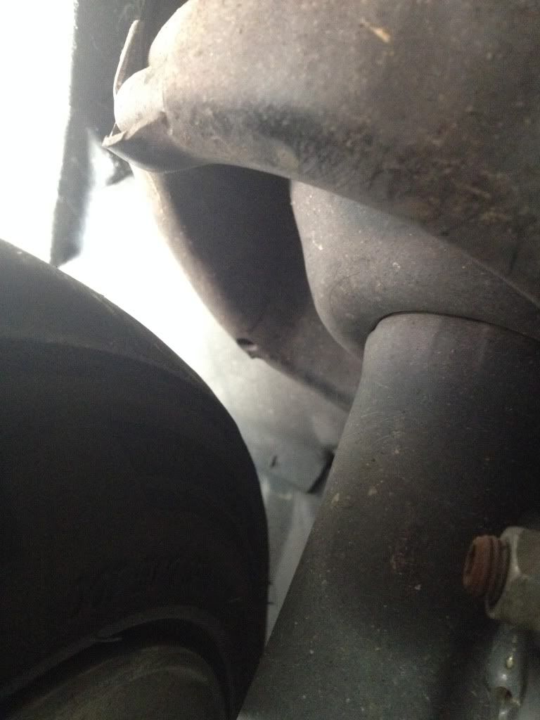

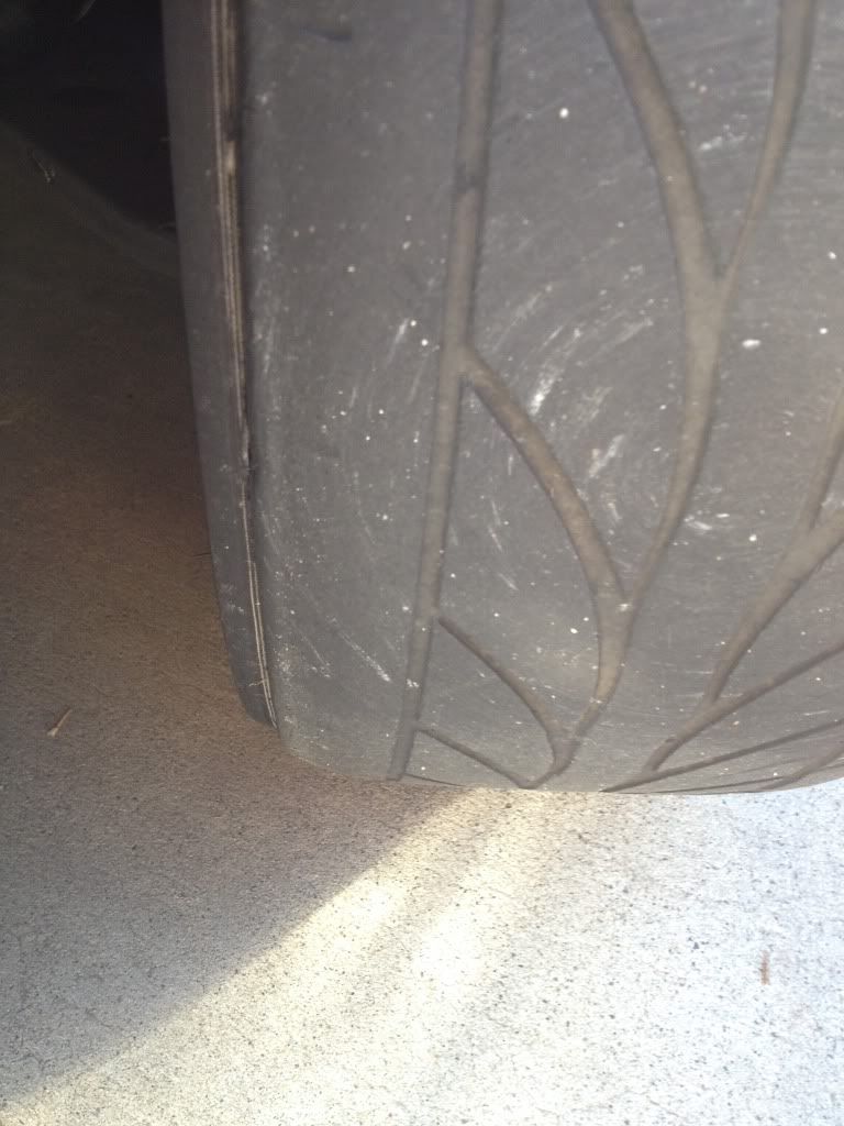

2008MS3GT 11-09-2013 12:03 PM
i know this has been an ongoing thread with many people asking questions, but what would cause the inner part of my tire to rub on the strut? im running stock suspension, stock rims and 215/45 hankook v12's. is that a severely worn bushing? ball joint? or can it be as easy as a totally jacked up alignment? car drives straight without any noticeable issues related to poor alignment. but then again, i am a relative newb. i am looking at running some 225/45's next and dont want to ruin a set of brand new tires. especially since the larger size will be that much closer to the strut
CrawlingMS3 11-09-2013 12:15 PM

2008MS3GT 11-09-2013 12:30 PM
Ok thanks guys. I'll have an alignment shop take a look. Here what the issue has caused:
You can see where it has rubbed on the strut where to end of the coil is

And the tire
http://i1127.photobucket.com/albums/...ps5d092847.jpg
Glad I caught it now. That's for sure.
Nliiitend1 11-11-2013 12:20 PM
That's not from rubbing on your strut.
The position of your tire/and wheel relative to the strut and spring perch does not change (outside of a *very slight* amount due to "wheel flex").
GODspeed7 11-11-2013 03:39 PM
I am going to agree here considering this is exactly what my stock tires looked like when I pulled them off. Found out from some very smart people (you and dan) this is a toe issue.
