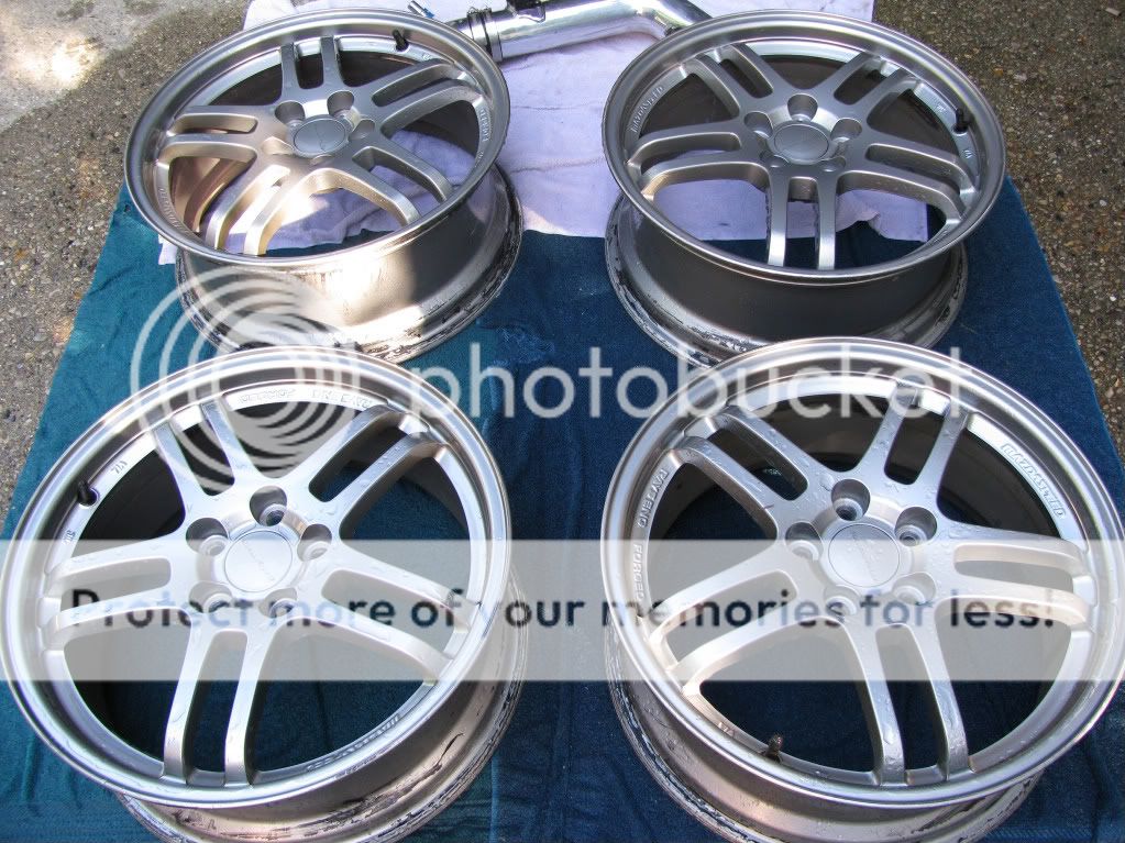

Lug Nut Question for the Forged Mazdaspeed Wheel
http://i710.photobucket.com/albums/w...o/IMG_0207.jpg
I just picked a set of 4 used Mazdaspeed Lightweight forged wheels from MiltwonSHO. Unfortunately, they didn't come with lug nuts. I know if you buy a brand new set they come included.
Does anyone know what type of lug nuts will work with these set of wheels? Tuner type skinny? Conical (bulge) or Acorn? I think conical, right?
I know the size 12mm x 1.50. Should I use the OE lugs? I, currently, have on my MS6, Kazeras which use a taper/shank (I thnk and probably don't work)
I was thinking of getting black chrome lugs. I painted my calibers red but not else on the exterior is red.
http://memimage.cardomain.com/member.../466348_63.jpg
Is it worth it to get Gorrilla? Muteki? Any other brands worth looking at (but not too expensive)? I am interested in splined or heptogonal(sp?)
I'm planning for the new wheels next year so I am gathering everything up. Any information is greatly appreciated. Thanks.
Wastegate13 10-24-2009 08:58 AM
I used Mcgard spline drives on the set I had.
PS: If you look at the lug area it's apparent that OE lugs are not to be used. When the wheels are bought new they come with their own lugs.
Poohster 10-24-2009 09:10 AM
Thanks. I realized from various reading that lugs come with new wheels and OE shouldn't be used. I wasn't sure since these are Mazdaspeed wheels that they might be spec'd for OE application. But they are Rays wheel so I was looking conical bulge 12mm x 1.5 closed spline drive black chrome or started thinking about red. I haven't made up my mind and welcomed opinions.
I take it you are hapy with McGards? Thanks again.
E4Performance 10-24-2009 09:27 AM
Gorilla Automotive 21133BC - Gorilla Small Diameter Tuner Lug Nuts - Overview - SummitRacing.com
Those are the best deal going. I've got those on my ms wheels. Been with me through 10 sets of wheels in 5 years. Great lugs
Wastegate13 10-24-2009 10:06 AM
I love the Mcgards. They've been on 4 sets of wheels with no discoloration or signs of wear. I like the fact that they have a rotating collar on the end so that when you are torquing your wheels they don't mar the finish and help to provide a more even torque across the board. I would highly recommend them.
djrivera 10-24-2009 12:45 PM
Or you could just get some black rays lugs...i mean there expensive but will def. look good with the wheels for sure
