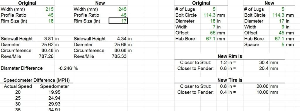

My Excel calcs going from stock GenJuan rims to 17x9's:
http://i158.photobucket.com/albums/t...17InchRims.jpg
You will want a 245/45 to maintain speedo accuracy.
Wastegate13 12-11-2011 04:15 PM
Only if you don't plan on lowering or with soft springs. He'll need the extra ride height or the slightly shorter sidewall to keep the rear tire off the fender.

Dru 12-29-2011 01:10 PM
Originally Posted by MS3-a(sore)ASS-rex (Post 1162561)
So right now to run a 17x9 +43 wheel with 255/40 tires I'll need to roll the rear fenders, trim where the bumper meets the fender and use either a 3mm or 5mm spacer in the front. Did I miss anything?
Edit: I'm assuming camber will also be a necessity to an extent?
Good info getting thrown around in this thread.
I have purchased some RPF1s 17x9 +45 and they are fitted with AD08s 245/40s. Planning on fitting the wheels to the car in the next coming weeks, so I might try and post up some info with photos on the fitment.
I'm hoping that I won't have to use a spacer up front and might get away with just a roll/trim! Running stock suspension at the moment too.
