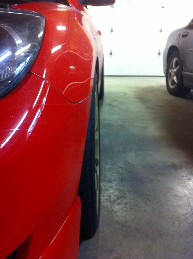

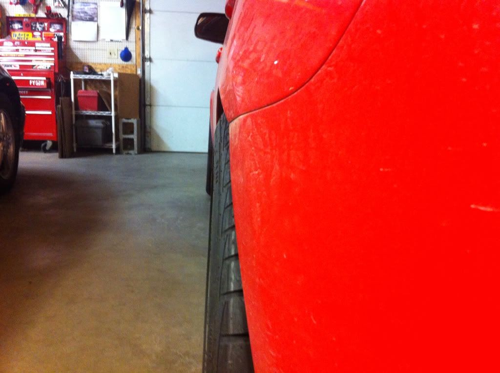

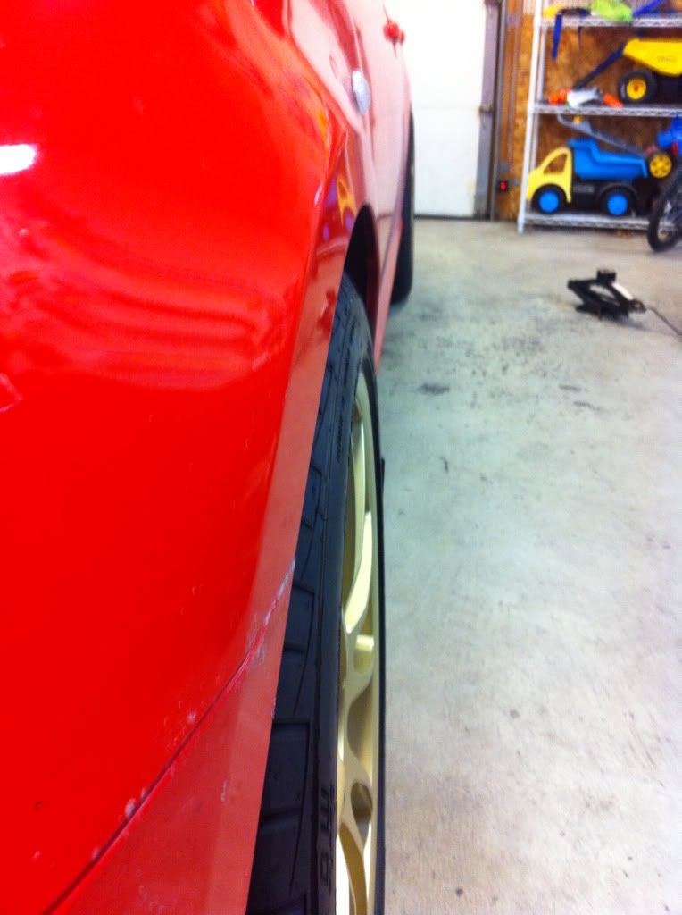

oh snapple...a local guy is selling 245/40/18 Nitto 555's w/ 5k on them for $350! Will they fit with a roll and 3mm or 5mm spacers.
Wheels are 5-ZIGEN Fn01r-C 18x8.5 et48 for my 08 Speed3 with stock suspension for now. Soon Racelands or SenSen/eibach spring combo.
SPEED3 EDDIE 03-07-2012 08:52 AM
They will fit,but you will need to roll the rear fenders or it will rub. Thats the size I had before I went to 235/35/18. And you dont need spacers, should fit fine.

I got the 245/40/18 Nitto NT 555s and they look like they are going to fit nicely on a 8.5 wheel
Downmented 03-12-2012 10:01 AM
Just run 215's f it
silvapain 03-12-2012 11:30 AM
Stretch is for pussies. Get some meat on those wheels.
http://i158.photobucket.com/albums/t...s/c6182dda.jpg
245/40's on 18x8.5's
goob_os101 03-12-2012 12:59 PM
Function over fashion...I got the 245/40/18 Nitto NT 555s. I was gonna mount them up tonight but I haz no lugz

goob_os101 03-13-2012 07:04 AM
so you do you think I will rub with the 18x8.5s with 245/40s on stock suspension?
Widzia 03-13-2012 07:30 AM
Originally Posted by Nliiitend1 (Post 1306536)
Pretty sure that pic was taken right after being lowered off the jackstands. :scratchchin:
He's on KW coilovers... ;)
http://i158.photobucket.com/albums/t...s/28d6f19c.jpg
Damn, that's a perfect stance
silvapain 03-13-2012 08:23 AM
I'm no wheel guru, so I can't tell you for sure. My initial opinion is that if I can fit them on my lowered car with coilovers, you should be able to fit them on the stock suspension.
I'd recommend finding a local NATOR member with wheels similar to the size you want and ask them to let you try them on.
dastpe 03-13-2012 08:32 AM
at +48 you should be okay...not a lot of experience with stock suspension. you may need a 3mm spacer, then you are the same as silva...so whatever prep he did you will need to do (most likely roll. maybe pull/grind rear bumper tab)

goob_os101 03-15-2012 07:49 AM
Originally Posted by silvapain (Post 1309752)
I had to do a roll 'n pull on the rear and grind down the tabs.
I hope to get away with just a roll if I run the SenSen shocks with Ebiach springs. This will give a very subtle drop.
