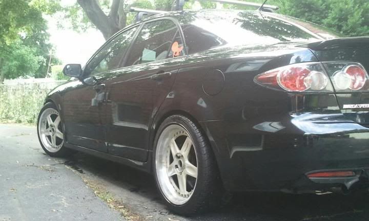

^^^ okay...
current set up..
18x8.5 & 18x9.5
VOLK CV-pro (f0rged.3pc)
lips need a lil work.. No center caps... but otherwise.. not too bad...
they spin true...
only major issues.. is the 265 tire on the rear.. hah
need to get my rear CO's dialed in...

Your diff is going to break. Why would you ever run staggered rims on an awd car in the first place. Especially that extreme of a difference.

Those forged 3 piece rims must've been pricey.
But I see you are rolling 265 series tires? I've never heard of anybody being able to stuff that size tire on a 6. I think 255 is, or was generally accepted as the limit. How'd you do it? Must take the perfect combo of wheel width and offset. If you aren't rubbing on your suspension, I don't see how you have paint left on your fenders.

Seems like at his height, as long as the suspension is stiff enough, he will not be rubbing in the rear. @:: Gusto ::, what is the offset on those wheels, and what width tire are you running in the front?

@:: Gusto :: your exhaust surrounds are mashed...

Although i don't agree with the running of a staggered setup on AWD, his setup isn't going to cause issues. And if you think it is you must not be thinking very hard or you would see that it isn't the width that would cause issues, its the rolling diameter of the wheels, so if he had 17" in the front with 18" in the rear, that would cause a huge problem. But he isn't,
@caesura Do your homework and apply some knowledge before opening your mouth with the intent to bash.
@:: Gusto ::, well played sir.
Also, my wheels are not EVO X wheels, they are Sonic Tuning ST120s 18x8 +35

Okay, sorry you are correct, I always thought running a staggered setup on awd ruins the diff but I researched and it appears if you have the same rolling diameter then you are good. Thanks for correcting me.

This has to be the perfect example of under education. I mean yes it looks good but running taggered sizing on an AWD car is FAIL. Your abs system, and entire AWD system itself hates you.

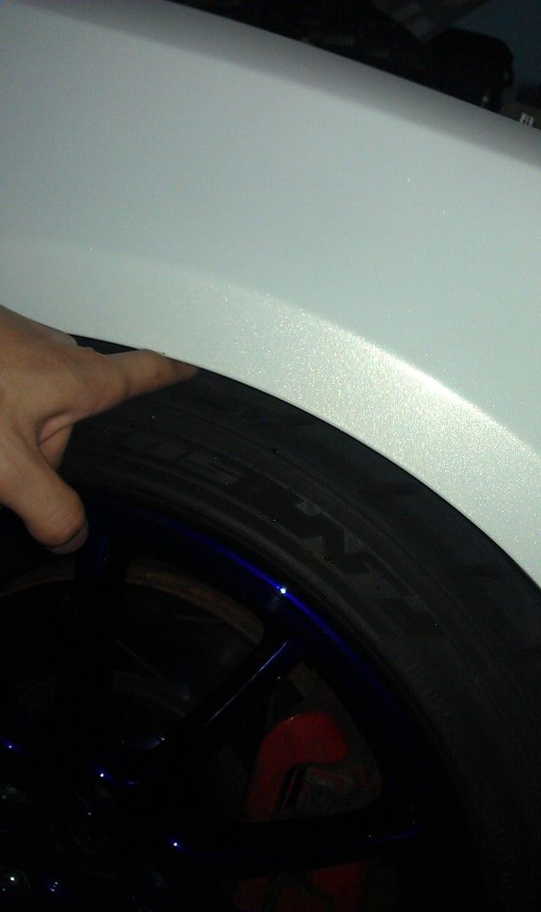

Okay guys....so I'm on evo x wheels....and my fronts are basically finger gap if that, and my whole wheel well liner and everything is all cut up and breaking off, so I'm basically hitting the top of the tires with that lip u can see sticking down from muddle of fender well ((white pinch well looking thing)).....What can i do to prevent this...I'm on a 225/40 up front....so what can I do, smaller width tire or what? Since I do want to go a tad bit lower.

order stiffer springs. pull the front fender. trim wheel liner.

Thanks! I will trim the liner this weekend! But what springs do you guys recommend?? I just ordered w.e bc came with on the extreme drop package about a yr ago....And I was planning on going.stiffer springs, looks like its about time.

call BC and ask, or call Stance and ask them, im almost 100% sure both those companies have stiffer springs as well as springs that allow you to go lower.

Thanks...yeah I was looking up sumthaiguys setup, he ran a 9k/7k from what I read, idk I'm also gonna contact bc.....I'm going lower and new wheels with a more aggressive setup!

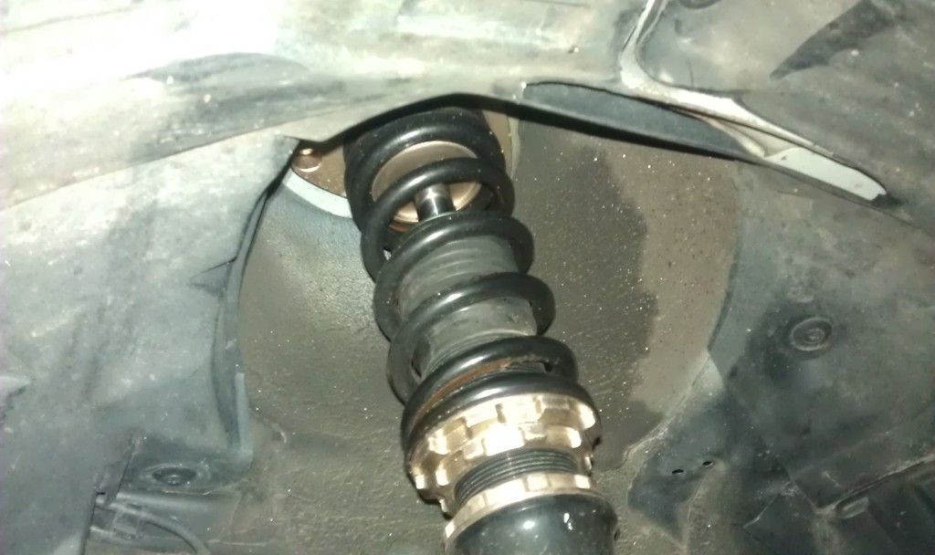

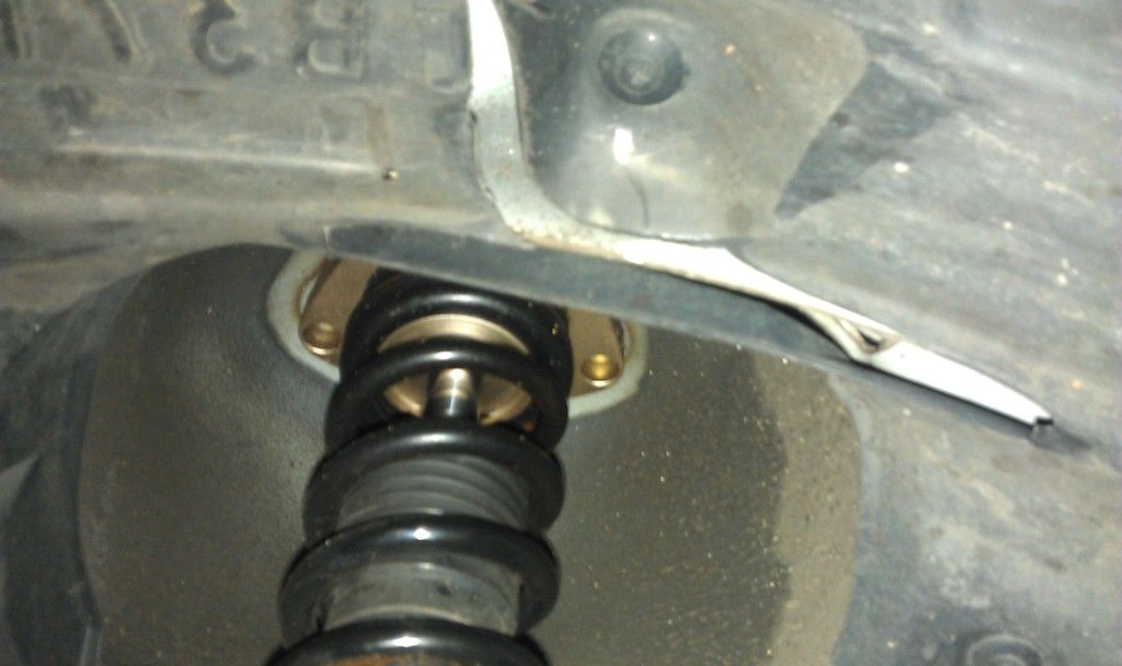

the rolling difference on my tires is like .03% .... your are pretty much allowed up to a .3%....
I do still rub a bit.. i'm running 1click back from full stiff in the rear..
barely get rub... on the edge of my fenders.
Ive been in talks w/ BC for stiffer spring rate in the rear... & apparently nothing is offered at this time. I'm going to have to source out a heavier set else where.
I rolled my rear fenders a few weeks back.. & dumb ass me was in a rush & not thinking about the small dent I had in my rear fender seem.. & i buckled my quarter panel.. hah
O well... might call dent wizard.. or just take it to a shop & have it cut & flared-out a bit more... so i can run my 10.5" wheels alil better.. hah
its a 235 frnt & a 265 in the rear
the rear offset is PERFECT!!!
about 1mm between my rear lower control arm..
on jack stands w/ the car in 1st you really get an appreciation for it.. hah
It's so damn close its scary.. hah
@Downmented : you should be a mod for this forum... heh
Yea my exhaust shrouds are smashed.. I have 2 spare sets... heh
my car used to be a lot lower... use to tuck tire in the rear w/ my old set up..
& well .. since it was on springs.. come winter.. it got into a battle w/ some froZen snow.. & broke.. o well.. - ill toss the other ones on @ some point.. I only leave those on for the reflectors.. when my car is parked on the street...
