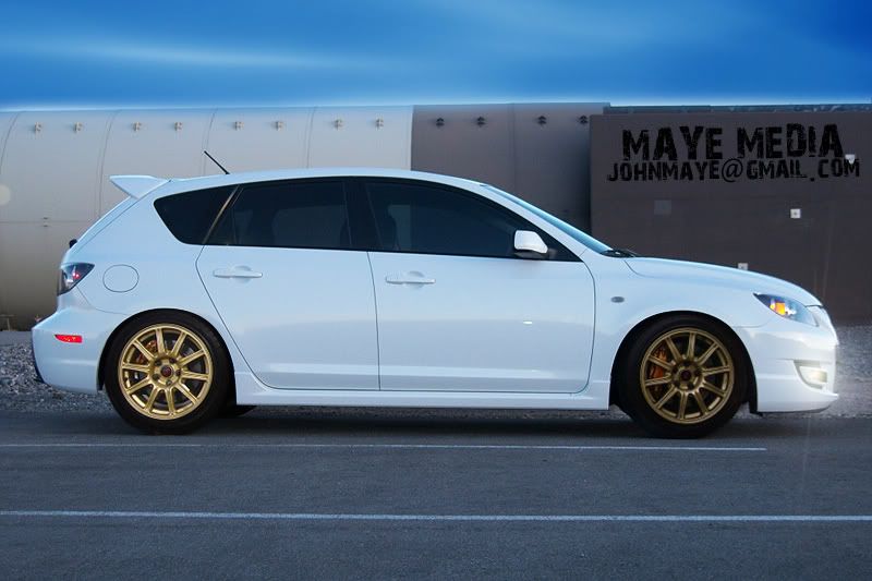

The bore on the STi wheel is smaller and you have to take them to a machine shop. I was thinkin of getting these for my CWP and had someone do a photoshop of them on my car.
http://i72.photobucket.com/albums/i1...da3-on-sti.jpg
Hypnotized 01-22-2009 06:46 PM
Yeah i figured it wouldnt bee easy.. The bronze sti rims look damn good on the ms3!
