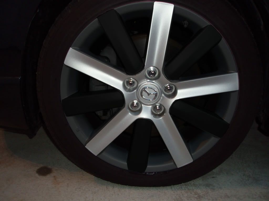

So I've been pondering painting my stock rims. I'm not sure how durable it will be or how to do it myself as well. I was wondering if anybody had some tips or has done it before. Also I'm not sure on either a graphite color to match my car or black. Lastly I'm not sure if I want all one color or these two here that my friend drew up. Any suggestions on those as well?
http://i289.photobucket.com/albums/l...%203/jeff3.jpg
http://i289.photobucket.com/albums/l...%203/jeff2.jpg

if you must go with two-tone do the second pic. lesser of two evils. i'd go with solid colors though.
hnda etr 04-06-2010 10:32 PM
Two tone makes it look like spinners... Esse...

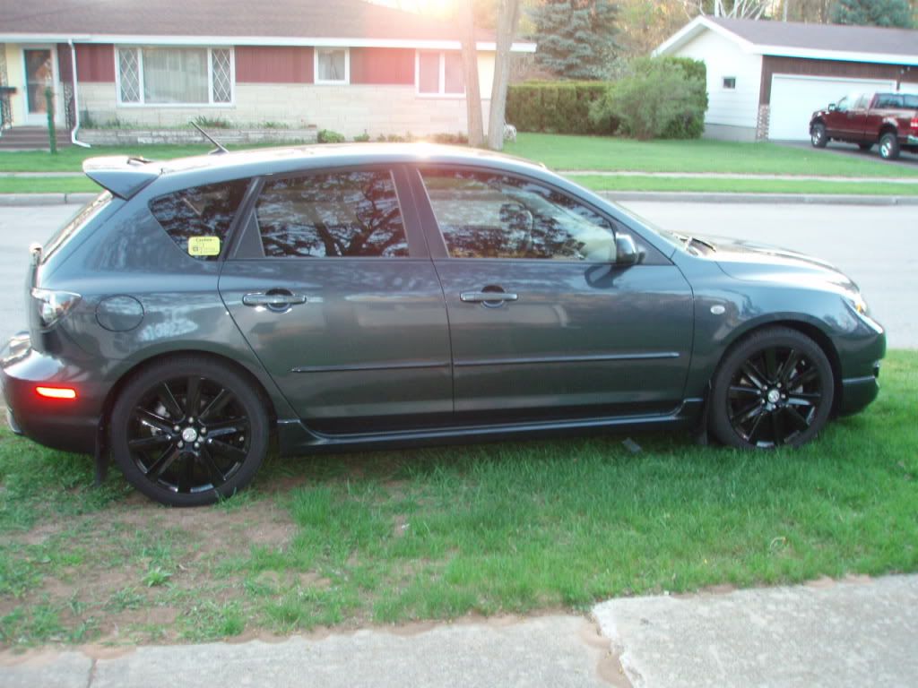

U can do it dude it is easy. Not that durable, but u can just add additional coats. I can tell u how do it in 2 seconds its really easy. Put the car on jacks and take wheels off, wash & dry them, scuff w/ scotch brite, wipe w/ a tack cloth, spray adhesion promoter, 3 cans duplicolor wheel coating black, 2 cans duplicolor wheel coating clear, and your done. You can buy all tha shyt at pep boys. Just be ready for the extra attention the car will recieve. And u still need to keep them clean, they turn brown with brake dust. Good luck.
http://i62.photobucket.com/albums/h1.../JAMESMS38.jpg

That looks very good on there with all black. Glad I'm choosing that one. Once the weather gets nice again and I have a day off I will be getting these done. Thanks alot for the help and picture.

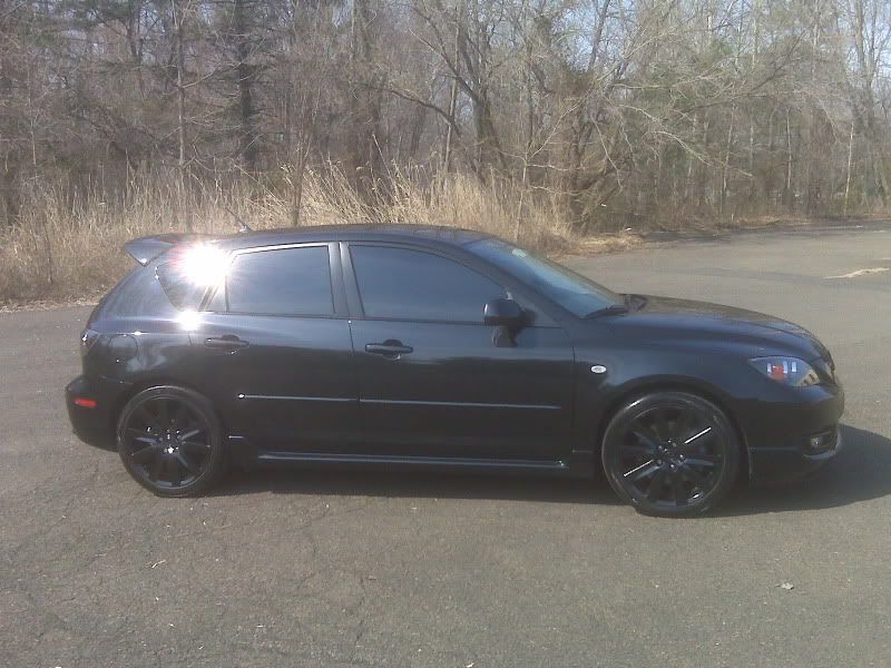

Finally got them done. I had to bring them to a shop to get done. Turned out decent. They just didn't get the center cap. Doesn't look that bad but I'll get it black eventually. I would have done them myself, but I just got a full-time job and now have almost no time to get anything done like I wanted.
http://i289.photobucket.com/albums/l...3/P5030729.jpg
