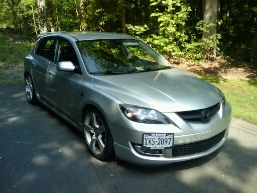

i have 245/40r18's up front and 215/45/18's in the back i rub on full lock left or right, but not bad.
http://i9.photobucket.com/albums/a96...-31_152237.jpg
also i'm lowered on h&r's
i'll go out and take a better picture if you want me to

you don't have to take any more pics, but please tell me how you did your grille. it looks sick! and also, I'm planning on getting H&R's with 235/40/18 tires. think i'l have to roll rear fenders?
