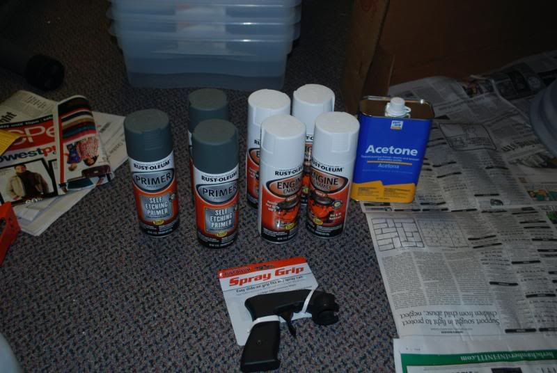

Stuff you need:
-Acetone
-At least 2 cans of Primer (if the metal is bare use a Etching primer, if not use a standard automotive primer)
-At Least 2 cans of Colored Paint (in this case Engine Enamel, as it came in white and is a --high temp paint, so no chance of pealing due to breaking temperatures)
-*Note* screw the comfort grip spray can attachment i purchased, its useless.

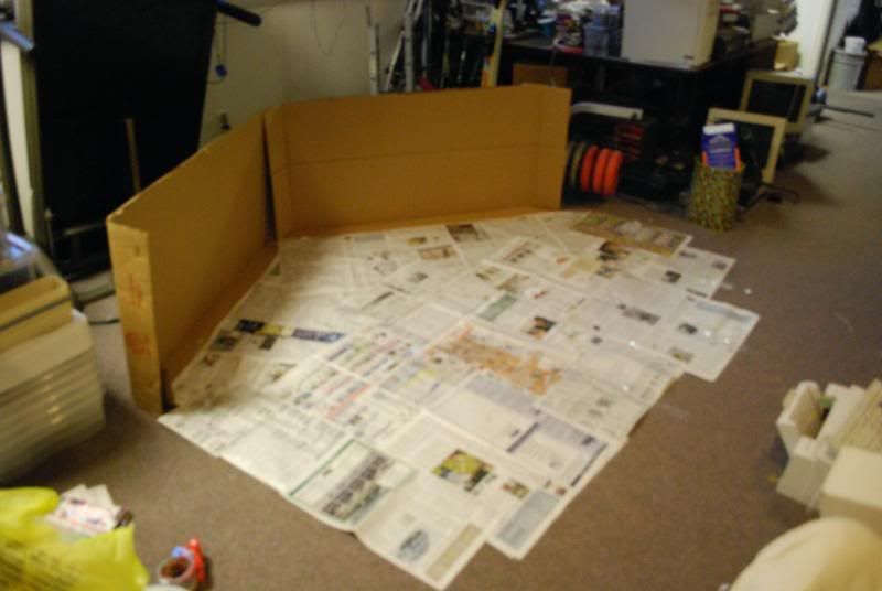

Tape off a good place to paint, i did it indoors because its too cold to spray paint in Ma allready.
http://i88.photobucket.com/albums/k1...DSC_0042-1.jpg
Gather Supplies:
http://i88.photobucket.com/albums/k1...z/DSC_0053.jpg

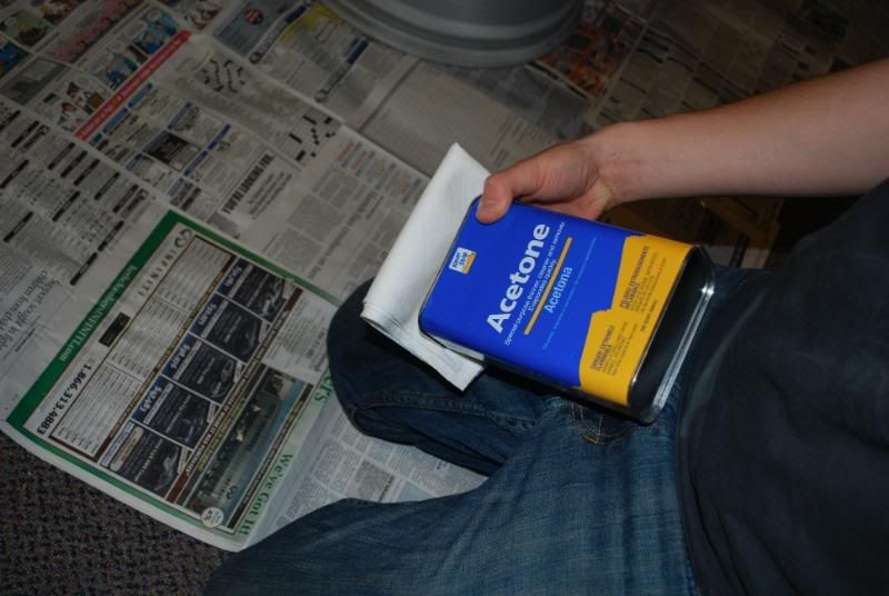

Use acetone to clean up the surface one last time before painting
http://i88.photobucket.com/albums/k1...z/DSC_0054.jpg
http://i88.photobucket.com/albums/k1...z/DSC_0056.jpg

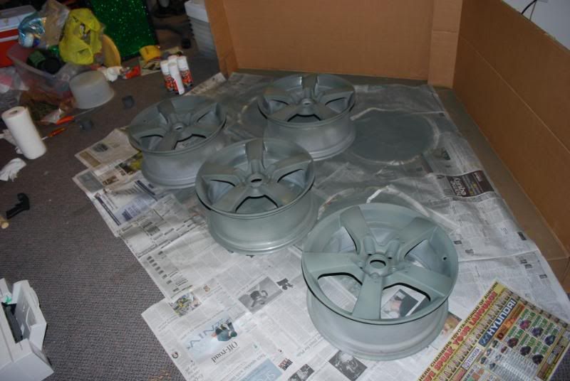

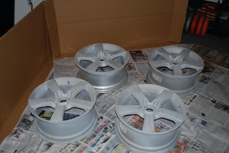

Shake Self Etching Primer for 2-3min then spray light coats across the wheels
http://i88.photobucket.com/albums/k1...z/DSC_0065.jpg
Spray 2nd coat of Primer, its important to get good coverage as this is the base for the colored paint to hold.
http://i88.photobucket.com/albums/k1...z/DSC_0068.jpg

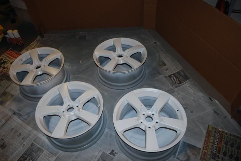

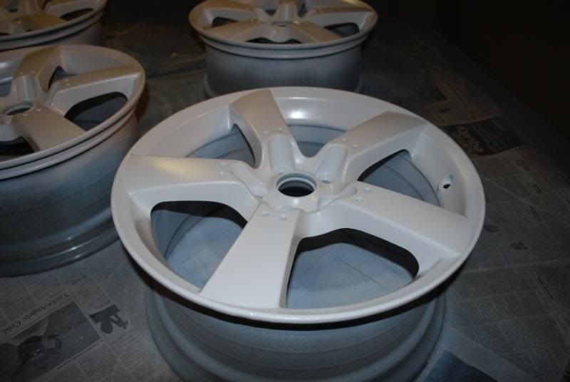

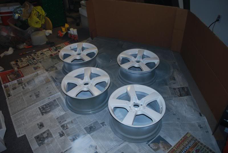

Next shake the White Engine Enamel for 2-3min to make sure the paint is well mixed, Then spray first coat
http://i88.photobucket.com/albums/k1...z/DSC_0070.jpg

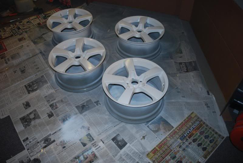

Spray 2nd coat, its crucial now to make the coat smooth, otherwise there will be obvious high-and-lows
http://i88.photobucket.com/albums/k1...z/DSC_0072.jpg

Small fail... you should paint the backs of the wheels first to avoid overspray onto the face of the rim when you paint the backs. That is uh, if you are going to avoid major fail and paint the backs at all, LOL.
I probably wouldve done at least one coat on the inside, but i dont think its MAJOR fail. who here cleans the inside of their rims? it will just be dirty on the inside anyways.
jamesthebikeguy 11-17-2009 07:25 AM
No fail at all, only had the face of the wheel soda blasted, so the inside of the wheel still had its paint, the wheel's inside is a light grey from the factory.
Originally Posted by Hank3 (Post 358127)
Any clearcoat on them?
No clear coat, we shall see how it holds up, i didnt want to clear them for risk of ruining the look.
Plus Engine Enamel is some damn thick paint.
No need for 1 coat, it still had the factory paint in there.
