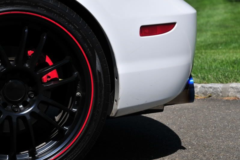

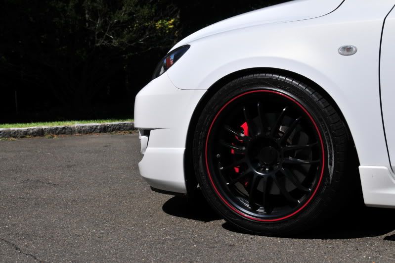

PANDAnic17 09-17-2009 05:12 PM
i would go with 235's with that wheels specs. i have the same wheel but mines is 48et and i did some minor rear fender rolling and cutting just not to rub... i have yoko's sig series thou and im dropped with H&R's Ssprings. idk maybe if you get the more rounded edge tire you may not have to do some cutting but for sure you need some rolling to do. here some pix of mine...
http://i663.photobucket.com/albums/u...7/DSC_0360.jpg
http://i663.photobucket.com/albums/u...7/DSC_0361.jpg
Originally Posted by SRTie4k (Post 313477)
Looking at a set of Rota SVN's, 18x8.5 with an offset of 45mm. Are these going to fit on stock suspension without rubbing with let's say a 235x40 tire?
and plus your 45 et? oh boy....i believe your going to rub even with stock suspension. i suggest roll your rear fenders first just to be sure and may be there is not cutting need to be done if you choose to stay stock suspension.
