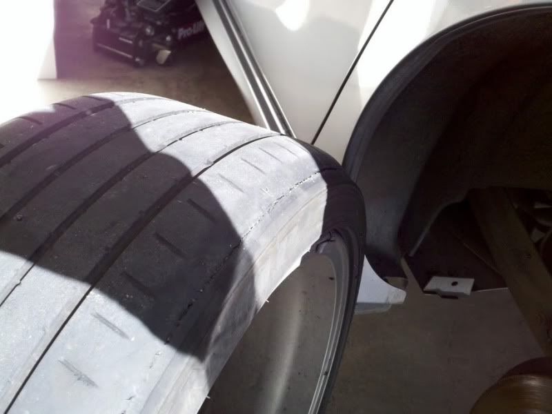

I misread the numbers, my apologies.
Was looking at your new front and rear and was thinking I was looking at rear before and after...
At any rate, if your toe was at -0.02 degrees before I have a hard time believing that it was causing you tire wear issues.
And just so you know, it will CERTAINLY scrub the insides of the tires with a bit of toe-in, unless you're running 0 or positive camber.
It's only so much an OEM spec issue in that the OEM ranges are too large (i.e., you can still have an alignment withing the OEM spec range).
The OEM range is ridiculously large and allows for this to happen.
Good point, and the more I think about it, I'm hoping I have not exacerbated the problem. My thinking was that, if I had a bit of toe-in, the action of driving down the road with that would slightly counteract the negative camber, and place the load more on the inside tread and less on the inside shoulder. If there is no toe-in, then you're strictly dealing with the negative camber in a straight line.
I'm going to try driving with this setup for a bit, and then check the tires. If they are wearing faster, I'll go back and have all the toe-in removed from the front, and toe-out removed from the rear.
Thanks very much to everyone for their input.
Is this normal tire wear?
I know, which is why I've posted about it in this very thread more than once:
This is why I always get a performance alignment on ALL my cars right after I buy them, regardless of whether or not the car is new. Factory "alignments" (if you can actually call the controlled assembly that they do an "alignment") are sketchy, at best, especially on a budget-oriented Mazda...
If you're simply going to try and "get it in the green," you're doing it wrong...
You should have specific values for your alignment that you're trying to attain.
The ranges that are in those machines (and the ranges that are in the FSM, for that matter) are ridiculously large, and you can end up with a pretty shitty alignment if all you're doing is making sure you're "within spec."
Do you have any camber correction parts??
If not, I suggest just getting your toe setting set at or very near zero at both ends (I actually run 1/16" toe out in the front to aide turn-in), and having the alignment guys get the front camber/caster as even as possible from left to right using the small amount of "wiggle room" in the front top strut mount bolts.
Sorry, but I can't agree with you.
As has been pointed out, an alignment that is "in spec" can still be horrible for proper tire wear...

Sorry to bring this old thread back, but it's better than firing up a new one.
Just had an alignment done at a local dealer who said the rear negative camber issue is w/in spec, and is not adjustable (I didn't know that). So I'm curious if anyone w/ stock suspension is still having this rear tire wear issue due to negative camber.
Seems Mazda designed the car this way, but it's eating my tires on the inside edge. Shit ain't right. It'd be awesome if we all blitzed MazdaUSA w/ this issue and they opened a TSB for it.

What is your rear toe set at?
Honestly, you should be able to run some pretty aggressive negative rear camber without a ridiculous amount of inside wear if your toe is at or very close to zero...
At any rate, I suggest replacing the rear upper "camber arms" with adjustable SPC arms since that will give you the ability to put your rear camber pretty much wherever you want, and will also give you the ability to fix any from-the-factory cross-camber you might have due to manufacturing and assembly tolerances. As a bonus, you'll get a little more responsive handling from the removal of some of that unwanted rear negative camber.

Thanks man. My numbers:
Rear: Left
Camber: Actual: -1.7 Before: -1.7
Toe: Actual 0.10 Before: 0.13
Rear: Right
Camber: Actual -2.3 Before: -2.2
Toe: Actual 0.17 Before: -0.20
How do you feel about these numbers, Nliiitend?
Thing is, one can look at the tires and easily deduce that they'll wear unevenly on the inside. The outside edge of the tires aren't even in contact w/ the ground. It's like the stock spec is set for a Formula 1 car.
I'll check out the SPC camber arms, but I'm not excited about altering suspension after some trouble w/ Tein coilovers on my old car.

I run zero toe in the rear.
Yours could be set way more precisely (at the very least they should be equal from left-to-right so that your car isn't "crab-walking" down the road). Some like to run a very small amount (like 1/16" TOTAL - 1/32" on each side) of toe in...
As far as your camber goes, if it were my car I'd do something to correct the cross-camber (either adjustable arms or the cheaper alternative - camber bolts that replace the outermost attachment bolt of the camber arms with a cammed bolt - picture below)
As far as the SPC arms go, they are honestly an OEM-quality piece that was most-likely designed as a collision-repair part (to fix issues that might otherwise require a new rear subframe). They use OEM-style bushings at the attachment points and are no different than the OEM arms other than the fact that they have a very robust threaded end that allows you to lengthen or shorten their effective length.
They aren't the easiest part to install due to some clearance issues with the passenger-side arm, but it's do-able.

All Mazda 3's chew the inside edge of the tires. The rear camber is far negative, and non-adjustable.
We get customers ALL the time that are pissed because they need tires at 20k miles...and that their 10k mile old tires are roaring down the road because the inside tread is so cupped and chopped.
It is what it is.
It is what it is.
Dude, did you even read this thread?
All it usually takes is setting the toe properly to fix the major wear issue...

Im just letting you know what I see on a daily basis, chill out.
Are you trying to tell me that insane camber isnt going to wear the inside thread? Really?
Define "insane camber."
You can easily run ~-2º to -2.5º on these cars with zero toe and not see crazy uneven wear if you follow proper tire rotation intervals and don't spend all of your driving time on straight highway slab.

The rear camber specification on them are what I would consider insane camber. It's almost like it's set up like an autocross car.
Here's what I know. Tire wear is one of the most common complaints on the 3's.
It doesn't MATTER if the tires are perfectly zero'd on toe, and it doesn't matter if the tires are rotated properly, the fact is that almost every set of tires I've ever done on a mazda 3 had excessive inside shoulder wear. Often times the outer shoulder and main tread area have 5 or more 32nds of tread remaining. The rear camber kills tire life on the 3's...plain and simple.
Seriously man, I do this every day. Im not an idiot, so stop arguing. If the damn tires are leaning on their sides, THAT side will wear at an accelerated rate. Camber IS a tire wearing angle, its elementary dude. What is your argument anyways? That setting the toe straight suddenly makes camber a non wearing angle?

toe causes wear much faster than camber the same way hard accelerating and cornering on your tires causes wear much faster than simply driving down the interstate.
Toe causes your tires to be turned even while you're driving straight, creating more friction.

That's correct. My point remains however.

I guess all of us with normal rear tire wear must be driving a different car.
You're exaggerating the amount of uneven wear that is caused by the camber component of the rear wheel alignment. Most of it is due to toe. Is camber a factor? Yes. Is it solely responsible? No. In fact, as I said before, you can get away with a lot of negative camber if you have relatively neutral toe settings and you maintain proper tire rotation intervals. Just because you have static negative camber doesn't mean your dynamic camber is always negative... If you had zero camber do you think your tires would wear perfectly evenly across the tread?? Not if you ever spent any time cornering they wouldn't...

Been on this setup for almost 30k miles on Hankook v12s, and it's almost time to change them. I cross rotated all four once at 15k, rotated front to back every 5k, and added a touch more toe out in front to make it -1/16 total. I have no cords showing this time, the tires aren't roaring anymore than when I put them on, and the tread depth is lower on the edges, but still would pass inspection. 30k miles with lots of highway miles, in town miles, backroading, and some drag racing.
Camber will wear tires, but toe is what's killing tires on these cars. If you have a shop that will take their time to make sure that the alignment is exact, roll the car back and forth some to recomp, and get .02 or less thrust angle, then the car will be much more kind to tires.

Originally Posted by 9900rpm View Post
Nate, my MS3 has the same problem. Inside of the tires wear a lot worst than the rest. I ended up getting that Firestone lifetime alignment thing for $150 or something. About to bring it back again. The right rear wheel looks funny for some reason. Top of the wheel (12 o'clock) looks to be pushed in more than the back left wheel. Could be from doing too many burnouts with the E brake up.
<------ like in this picture.
I did the same thing. My tires are wearing on the inside pretty bad. The dealer says the car has a lot of negative camber for handling purposes and all gen2 speeds wear the same way. I then went to firestone and bought the lifetime alignment and had it aligned. They found nothing wrong with the alignment. The technician told me it was the camber and can not be adjsuted cuz the camber arms are not adjsutable. The solution is to buy a set for the rear and the front and adjust it to minimum camber within factory specs that way you get more life out of your tires without sacrificing handling. I will start with the rear ones for now. They are about $180 for the rear set.
I did the same thing. My tires are wearing on the inside pretty bad. The dealer says the car has a lot of negative camber for handling purposes and all gen2 speeds wear in the same way. I then went to firestone and bought the lifetime alignment and had it aligned. They found nothing wrong with the alignment. The technician told me it was the camber and can not be adjsuted cuz the camber arms are not adjsutable. The solution is to buy a set for the rear and the front and adjust it to minimum camber within factory specs that way you get more life out of your tires without sacrificing handling. I will start with the rear ones for now. They are about $180 for the rear set.

Originally Posted by indianaryan View Post
I posted about this before, but I can't find it now. Don't know what happened to it. Here's a pic of my tires after 23,224 miles.
When I had new tires put on and an alignment done (I got the lifetime alignment), The toe on the front left tire was 0.22 degrees and the front right tire was -0.23 degrees. Now they're at .10 and .09. According to Firestone the range is -.09 to .28.
I thought it was a little strange that both front tires had so much wear on the inside edge, but both were completely opposite from each other.
These look like my front tires, I think most MS3 don't have the right alignment. I'm getting 2 new tires this summer, I'm killing the last 2 Dunlops this summer.
Im at 14k miles and mine are the exact same but im starting to show thread. Im fixing to order a set of wheels and go get realigned hopefully not to mazda specs either.
