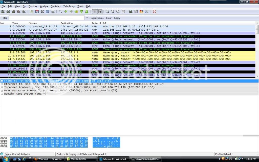

robertof 05-29-2011 08:21 PM
my IP is 192.168.1.x, jwilkins88 is 192.168.1.x
Who else that cannot connect what is your IP?
http://i1047.photobucket.com/albums/...c/capture1.jpg

robertof 05-29-2011 08:29 PM
I understand that part about subnets and subnet mask and hosts, was just throwing something out there to see what's going on. Sorry to get off topic.
Every time I try to go to 184.168.254.1 it tries to communicate to 217.31.57.166, which is what jwilkins just stated above.

29 * * * Request timed out.
30 ^C
I can nslookup fine.
Non-authoritative answer:
Address: 184.168.254.1

Ok, so that rules out DNS. This is really confusing. It almost has to be something on go daddy's side of the house though.
What error is the browser showing when you try to browse to the site? 404?

Interesting, i can't get to your site from both my work computers or my iphone (at&t) or my work blackberry (verizon)
I have dig installed on my windows box. Here are some results.
I don't think it's a dns issue. Might be http/server related on go daddy's side like you said
jwilkins88 06-01-2011 08:40 AM
Yeah... We've ruled out DNS
