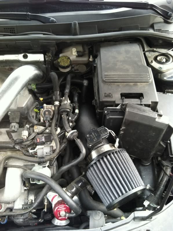

Etipp98 07-07-2012 10:19 PM
My bracket is worthless.... Lol http://img.tapatalk.com/44e4b41b-0a3d-a9ea.jpghttp://img.tapatalk.com/44e4b41b-0a69-1fe6.jpg
tapatawk
taf0422 07-08-2012 08:08 AM
Interesting...my bracket is perfectly placed.
Boost Addict 07-08-2012 08:09 AM
As was mine, I would make sure the coupler is all the way on the turbo and the intake is pushed in all they way.
Mistersix 07-08-2012 08:20 AM
It looks like it just needs picked upward a bit.
Etipp98 07-08-2012 09:57 AM
Coupler is all the way against the turbo since it need to cover the 4 threaded holes on the 4" flange. Is anyone else running this with a 3071 or 3076? If I have mine on the bracket the pipe only goes in about a 1/4 inch on the nearest side and does not hold when clamped.
tapatawk
JBR 07-08-2012 10:08 AM
The intake was designed with a bracket location to fit the stock turbo and big turbos that are in exactly the stock location which most are not. So, that is why your bracket does not match up perfectly. There is no way we could have economically made these to fit every possible turbo application. I suggest making a little extension bracket.
Thanks,
Jamie
Etipp98 07-08-2012 02:35 PM
Figured as much, I don't have an issue not using the bracket, just wanted to point it out so other BT people aren't worried about it not being implemented.
Boost Addict 07-08-2012 02:39 PM

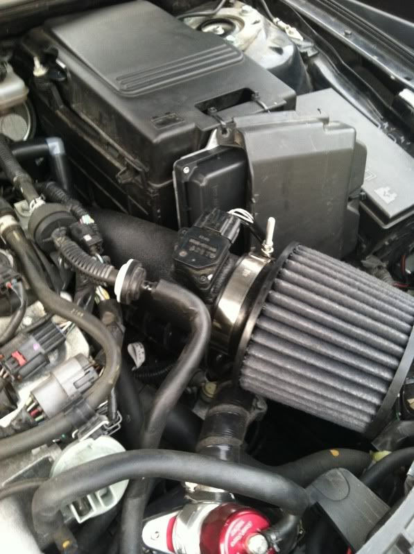

Took the time to clean up mine today. I'm really happy with the placement of the ecu
Attachment 65977
JBR 07-08-2012 02:55 PM
^^Looks great man!! If you get time email me some pics I'd like some for our website.

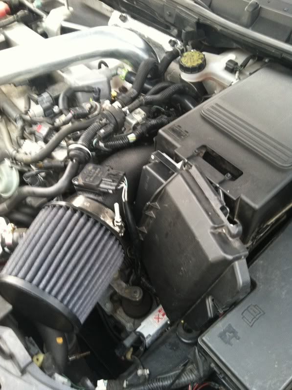

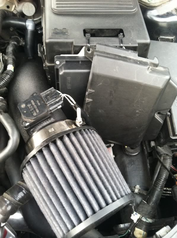

Boost Addict 07-08-2012 03:05 PM
Not a problem I can grab a few different angles
Boost Addict 07-08-2012 04:44 PM
Heres a few more angles, @jbarone PM me your email address and I can send them over to you.

08.5MS3 07-08-2012 05:40 PM
The one piece design and absolute monster of a diameter make me want this fucking thing so badly.
The ECU relocation is the ONLY thing holding me back, I'm a sucker for a clean looking bay.
Very well done, JBR.
silentwolf8 07-08-2012 05:47 PM
It still looks clean even with the ecu re-location.. just a matter on how you do it. lol
i just did mine on top of the fuse box.. and have it slightly lipped under the light housing.
