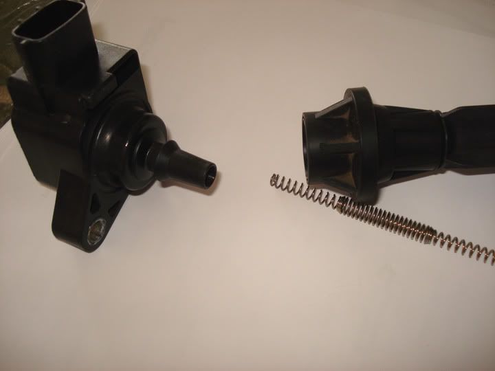

fuuuk what a worry, thank god i found that! how weird, im going to rilly look into it tomorrow, now that i know what problem is. maybe even replace the plugs
id due one tonight, but i have to set up my x mas tree for the boy,
and i rilly need to lean this bitch out before the video....

Originally Posted by rigor View Post
fuuuk what a worry, thank god i found that! how weird, im going to rilly look into it tomorrow, now that i know that is the problem. maybe even replace the plugs
no problem get it running like it should... have you stretched the springs in all the boots?

i did the spring stretch a while back but, im going to make for damn sure, they are making good contact tomorrow...
ding! ding! ding!^^^^ what i said in the first place spark blow out
it was sparking it the boot instead of the cyl
if you looke up in the plug boot were the plug touches the spring, and it looks like someone was drawing zigzags in their with a pencil, i just stretched the spring and fixed it
haaah the
okey was right! lol im so fuckin haddy !!! time to get drunk!
nigor rigor for the win
Sorry can you elaborate?
Also, you're running NGK plugs, gapped at what? Did you change the gap at all?

it was sparking in the boot, instead of the cyl. cause of pour spring contact
ngk gapped @ 24..
no but tomorrow i was thinking of going to 22..
has any one tried copper plugs?
i hear the eriduim is a bunch of hype not much better, if at all??
and that the tiny tip blows off, under heavy boost?
kenne bell recommend copper

ohh and after i fixed the plug, my car quit spraying fuel out the exhaust

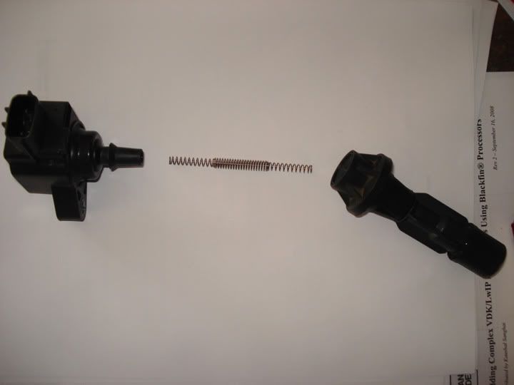

Very nice. And most that popping probably was after fires from all the unburnt fuel. Spring stretch FTW.
And for the noobz reading this thread who might want to stretch the springs, here's where they are:
The boot just pulls off with some love.

more probs with smaller gap 21, so tomorrow im going to try 25-26 see how that goes, it is definitely spark related, if that don't help turd needs to hook me up with the bas !!
i was having problems @ 4800 awful missing
fix spring 1-2 misses 24 gap @6500
close gap down 21 missing @ 5700
so it is moving with the gaps so hopefully can find a sweet spot!
and hopefully leaning it out will help with firing it off!, it could be so rich it's putting out the fire!

no ill wait tell they have something to replace them, if the head goes bad fuck it! i pull the mtr shuv a new gen small block in the fucker, hang a rear end under it, and run a 4l60e, and turbo that instead
i hear no popping under the hood, it is all out the exhaust, after fires do to the spark going out, then getting lit in the collector, near as i can tell!!
im going to try these 2 adjustments today, then im going to leave it alone till some seals come along
their just no win for the old nigor rigor

dang man, i forgot all about the spring stretch. i did that early on and forgot i ever had to. lmao.

i ordered new plugs
their was a lot less missing with the leaning of the map, so hopefully their is more room to lean it even further do a data log on the way home

ok boys she is runnin hot!!!!!
and it is sill in the high 10s low 11s
video uploading now and it sounds good to me
no missing !!!
leaning it out did the trick
