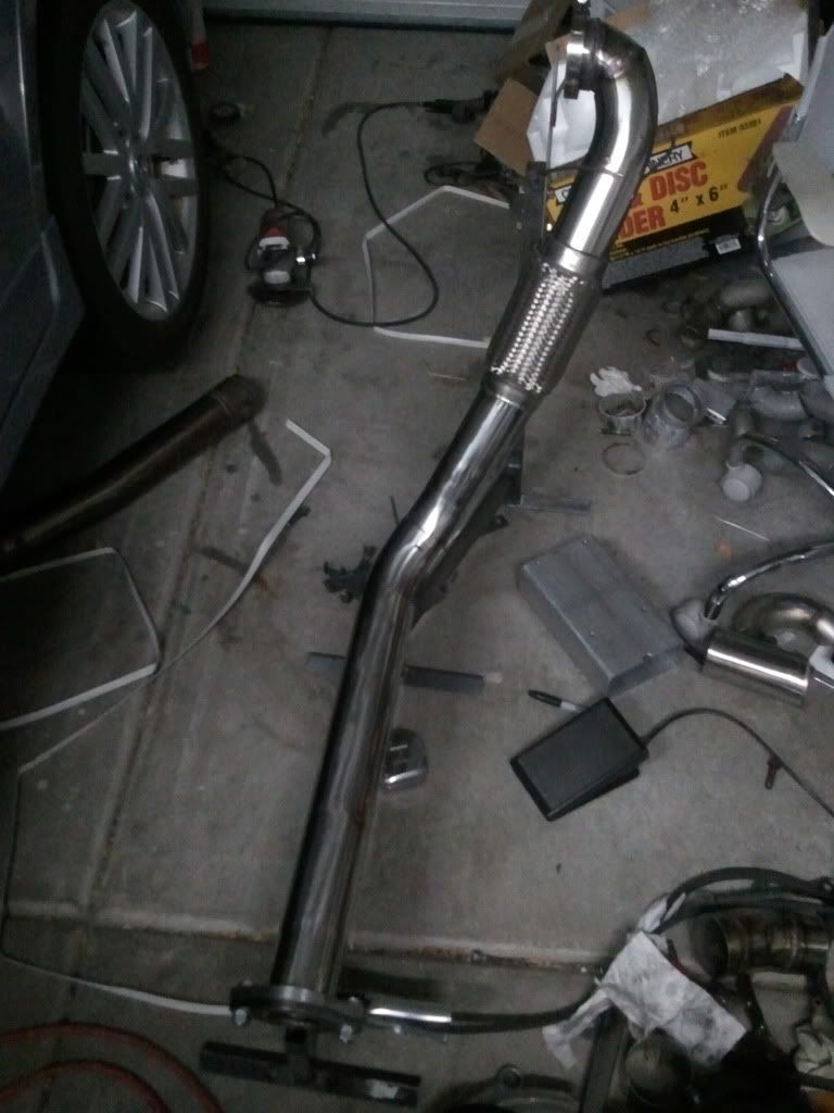

It looks sooooooo good
too bad i have to make a couple tweaks lol. Was too close to the AC line for my liking... and flange needs to be a bit tweaked. But it was damn close for first attempt and cleared the driveshaft tunnel great.
Tomorrow night i'll make the tweaks and get it lined up perfect, then tweak the jig and build a second one for proof.
just realized i said tweak alot... i must be tweaking. Bed time... then day job... then more tweaking

that looks very nice! good work !!
dj's custom fabrication..

dude your finish welds are so smooth if i diddent know it i would just think that thing was fully mandrel bent
lol, that's cause it's not finished welded, haha. It's only tacked right now for fitment

Ahhh now that i look harder I can see the line lol, was gonna say damn thats butter smooth!
I'm absolutely down for one of your DJ Quality Top Mount Turbo Kits as soon as I get back from afghanistan!
