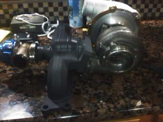

She's here!!!!

VERY nice work leen!!!!!! true twin scroll! beautiful job....

I just fell in love with that manifold!

better shot...... BAD ASS!

that thing must weigh like a hundred pounds with the turbo and wastegates on there, lol.

Ballin, doggy.

jeeez those manifolds are badasss!
very nice quality looking.

Quality is great! this thing will scream for sure! Im very pleased!
its going to be kinda a slow build for me, cause im working 6 days a week and have a 6 month baby at the crib that needs my attention, but all's good. ill get it done! this manny will flow awesome easy to see it, inside... I will start my own thread and all that stuff when things get rolling! ill be redoing my IC. piping and down pipe, intake all custom by me. it will be real cool! and ill keep it all posted!

what size studs are needed for manny? and pitch?

The threads are 10mm x 1.5. I'm glad you like the manifold. It will be interesting to see how the twin scrolls perform.

shitty cell pic and no bolts to attach the turbo lol but you get the idea

I had the SS mani in the car last night, and it looks like you may need a shorter bolt or stud on the top center hole. The counter bore isn't as deep as i thought... I'll look into it more when i get a chance.
And you'll need to use a bolt on the hole behind the WG. Use a stainless bolt.

Originally Posted by mason View Post
ok, cool.. look into that? and when you get a chance also or you might already know, the length on the oil feed and return thats needed?
Oil return i'm not 100% sure on quite yet... and it may require a custom oil flange thingy mc-jig like i'm building for my manifold, but if it does, i'd make it. I want this setup to be as "drop-in" as possible.
For the feed, i'm using a -3 AN (-3 recommended for my turbo) that's 18" long. The modified oem feed comes out from behind the alternator, and is pointing toward the driver's side, so my line loops under and around the manifold, and fits right onto the CHRA. It's kinda long, but i don't think there's any harm in that, and it makes things much easier. A right-angle adapter may be needed to keep the line from hitting the hood when the rotating assembly is clocked vertical. That's how i'll be running mine.
Install day on the ms6 is coming very soon... and at that time, we'll be hashing out these final details, and i'll assemble some ms6 kits to get out there.
