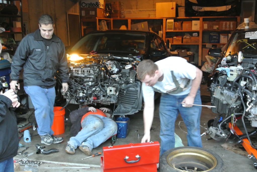

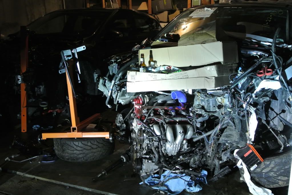

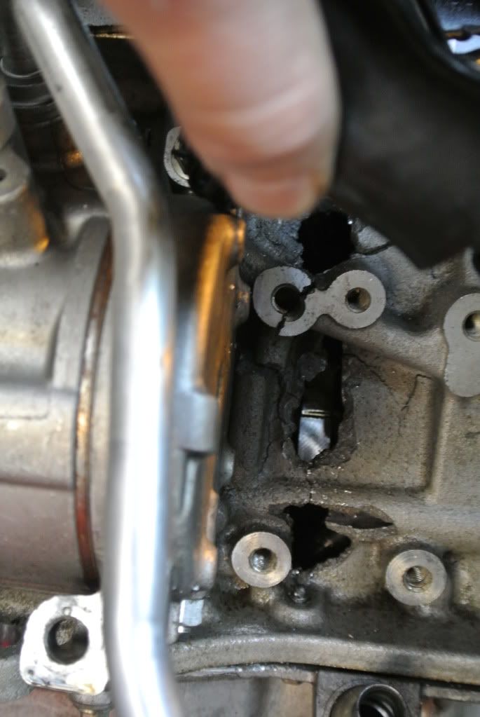

Just a few shots from today... nothing great.
Holes in the front of the block
ms6allen, joel and burn813
My car as it sits
from left: mazda kid, burn813, joel and allen
My garage with super hill billy appearance... i like all of the trash on joels car
Ckmazdaspeed3 is offline   Reply With Quote

So you put Joel's motor back in??? Lol I don't think it will work that way, these motors are supposed to be transversed

Yes, we put it back in...sideways because we discovered we couldn't fit it between the cars with ease.
Someone removed the dipstick, so when we set it down we had an oil spill on par with BP.
Keith, glad to hear you got the axle out, that thing was pissing me off. Let me know if you need more help.

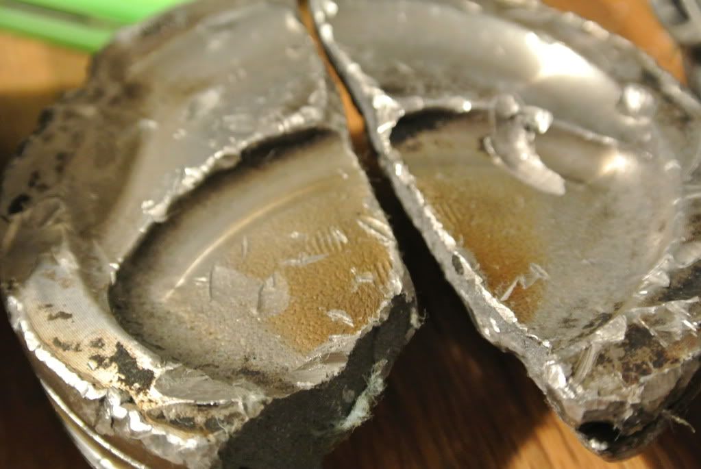

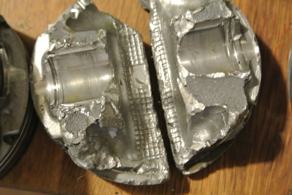

Yeah, so at this point the engine is out. Joel and I started to take it apart last night, but he had to go get the sex (apparently I wasn't enough), so I called it a night.
K1 rods are ordered (confirmed tomorrow morning), Dustin sent a package of goodies and now I'm deciding if I should get a atp gtx3071 internal wastegate and have it ported, or if I should go t3 vband??? decisions, decisions.

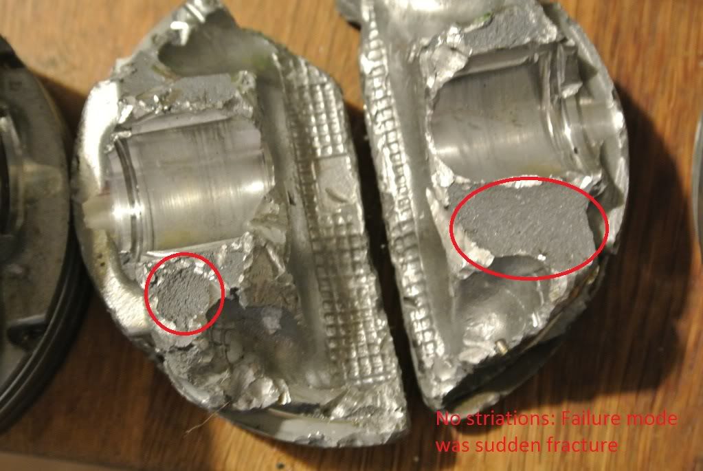

Here is a picture of one of the pistons. I might send Dustin's pistons back because with this sealant here, I think that this may be reusable. Thoughts?
We pulled this out of the holes by cranking the engine... I can't tell what happened to cylinder 1 yet, but this is from two... and the rod is bent about 90 degrees.
Funny thing is, we have only had 2 hang ups... The first was the windshield wipers which are hammered on by the arm of god (I know right... Hey dude, I'm pulling my motor and reinstalling it myself, but can you help me with these wipers?) and pulling the second one (thanks @TRex) resulted in a broken windshield. The other hang up was the axle.
So far the process has been an awesome and fucking messy (thanks for the dipstick Kyle!!!) process and I can't wait to get the block apart.
oh and @djuosnteisn , if you read this, the stock pistons use 22.5mm wrist pins, so that is what I ordered, correcto???
holy god!!! i have never seen a piston completely destroyed like that...congrats!
is your head intact??? valves???

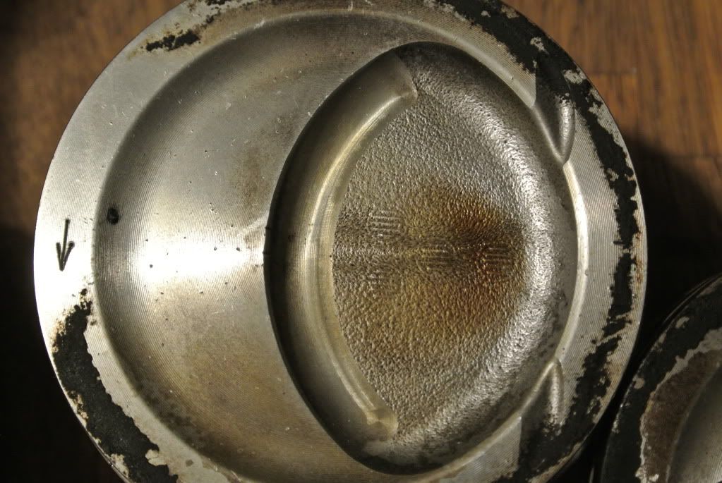

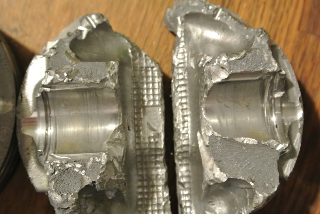

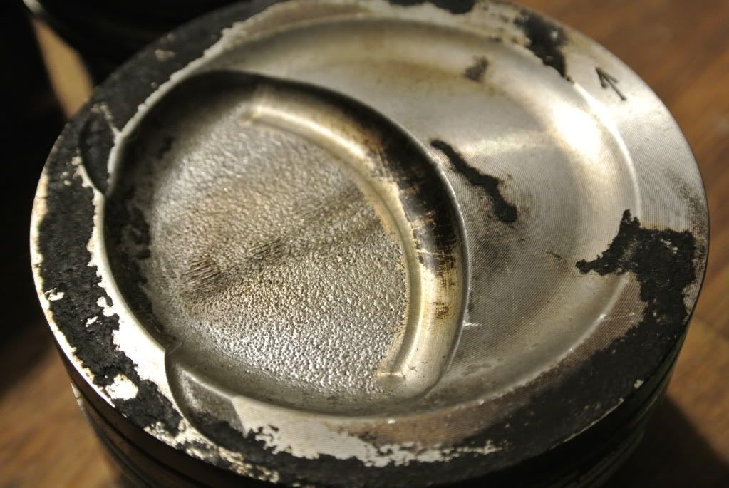

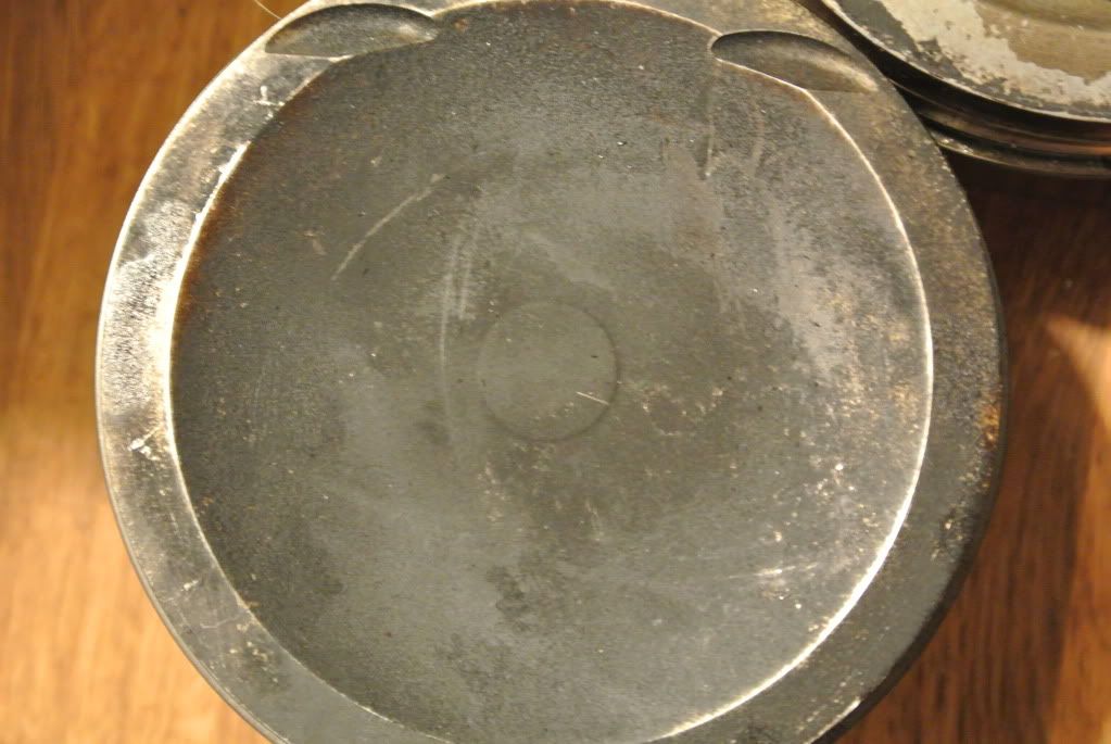

I know that some people wanted a better look at my pistons, so I cleaned them all up and here they are. Also, I had an extra set of gendone pistons thanks to DJ, so I compared them and there are different indentations in the genpu and the genpu weigh 10 grams more than the gen 1. I weighed all four gendone and they were all between 378-380, while the two genpu that I measured were 388-390. I made sure that they all had there rings so that it would be accurate. Anyway, pics for those who want to see them.
@Lex , pm me your address and I'll send you the one that I still have connected to a rod... do you need the rings?
and the gendone
@Dano I think that you were the one who wanted me to clean these off, so here you go. If you want me to take any other photos, let me know.

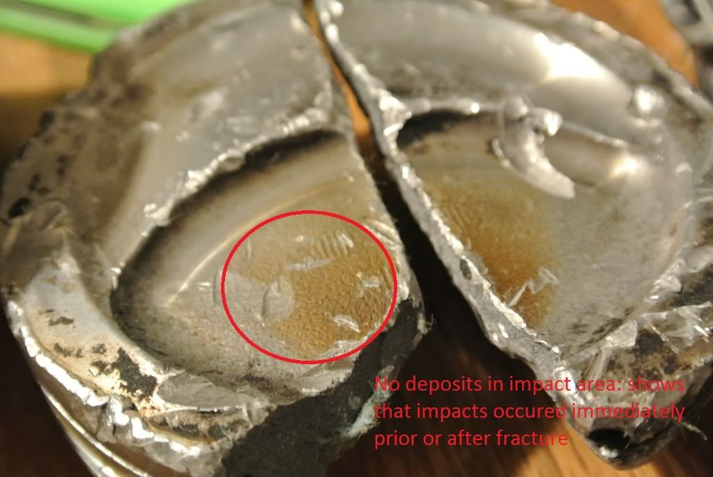

My analysis:

Originally Posted by silvapain View Post
My analysis:
I would say the piston just looks like it got fucked by the rod. Plenty of impact marks on the bottom and at one point after the rod had snapped it looks like it beat the piston till it broke in half...most likely after it beat the wrist pin out, leaving the piston to float about even rotating and getting beat some more by the rod on top. Nothing sticks out as unusual...except for the fact it's broken.

Yeah, looks like the piston was simply bludgeoned by a broken rod. And i'm still of the impression that our stock pistons are pretty damn tough. At least tougher than the rods.

nothing much to add here. From the initial pic it looked like there might have been more carbon buildup which would have indicated some on-going issue prior to ZZB but these pics discount that theory.

Is the rod in too many pieces to identify? If there is still large chunks, could you grab some pics?
I agree completly. When I build my engine I will be using a carillo rod with tapered ends and oem pistons. They are pretty stout.

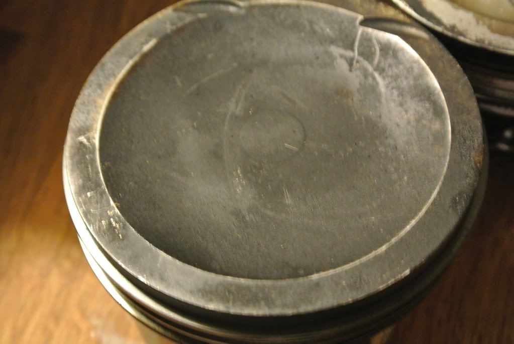

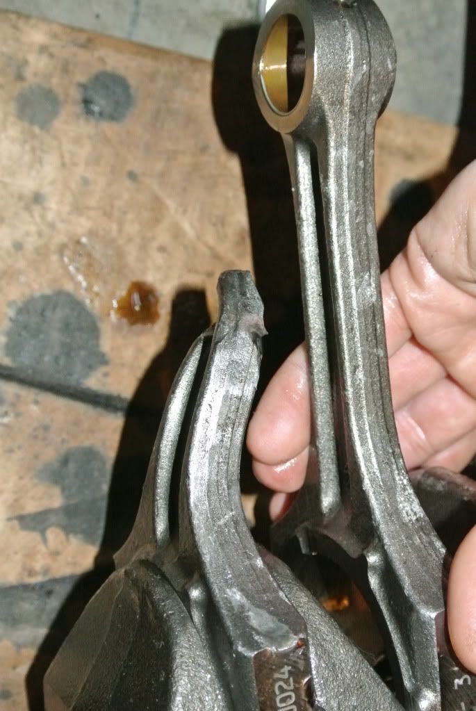

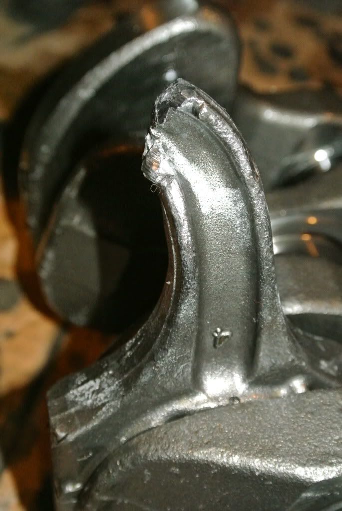

Here are a few pics of the rod... the torx was too chewed up to get off tonight, but maybe another day.
I tried to line them up as best I could.
The string is measured to the tip of the broken rod along the side.
I don't know what this show other than the rod either broke some place higher than this, or it was the piston. I mean, I'm sure that the rod is exactly the length from the crank to the holes it punched in the block... I'll measure that tomorrow.

 Old 01-12-2012, 07:46 PM   #354
that is probably the weakest point of the rod...damn that thing was trying extremely hard to exit the block....some tremendous pressure exerted for multiple cycles to weaken it.
what do your valves and head look like for that cylinder??? got to be fubared.

got cha...hard to tell but there is some shadow around both intake valves..either they are starting to open or are closing or they both could be bent and are def messed up.
look at them compared to the valves in both adjacent cylinders. They are both about the same so they are both prab just open.
I think you'll def need a new plug in that cylinder
mazda did some major reworking of the piston face for gen2.....looks like they were working on flame front travel/atomization of fuel.
if I decide to do a budget build I may try to get some gen2 pistons fo sho if they can be had for much cheaper than aftermarket. Believe it or not I would think Mazda would know more about flame travel than any aftermarket company on their platform. DI is still relatively new but I haven't looked around at aftermarket pistons.
