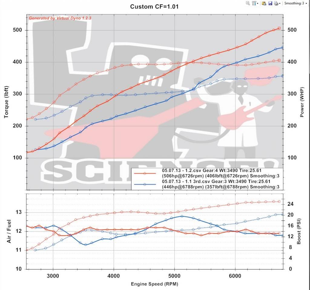

The GTX 30s and this EFR have similar looking maps, yet when I look at most reverse taper GTX 30 vdynos I see a normal ish looking K04 curve most of the time...Example being Matrix311's car (whom I think you're tuning right now).
In my case I am typically at peak power in the 6500-6800 RPM range running the GTX3071 at full tilt...
Red is a 4th gear pull...WGDC is going to 100% around 6000 RPMs after reverse tapering targeting ~400wtq up to that point...
What fuel/mix and meth?
Edit: Fixing post;
I know this doesn't count, but 4.76 60-100 time in this log, which felt amazing.
The only thing I can think of to explain the sudden huge jump in power is the reduction of IDC. Grant it, this log has 4 deg more timing up top, but the main thing I think is that I'm probably no longer spraying too far into the compression stroke and possibly during the power stroke.
At any rate, I'll be backing this log up with yet another tomorrow, and finishing up the boost /timing curve as well (I've got a bit too much torque around 4500, so probably pull half a degree of timing).
After that, it's probably time to hit the rollers.
My bad on editing your last post on accident...meant to reply....
I have been running ~E30-E40 coupled with about 900cc/min of meth (about 16% of total fueling at peak power)...
cld12pk2go is offline
330wtq is too much at 4500rpms? Why?

I'm going off of the 1.09 numbers as some locals believe it to be more accurate/in line with their real dyno numbers. I want to be at or just below 350 just to be safe.
...Plus there's an ugly torque bump in that log. Lol
I can only speak to my dyno results, which were much closer to the 1.01 values...
Either way when your current torque target starts to feel slow, you can always work it up... That is the beauty of BT...

1.01 usually always measures right on for hp. But I find even that is a bit favorable for tq when actually on the dyno.
