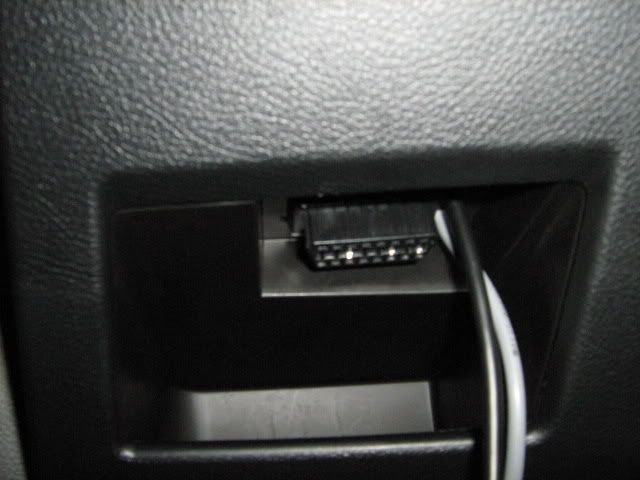

I just did this...
If you pull down the left most panel, after removing the fuse cover, there is enough room to squeeze 2 wires alongside the obdII plug itself.
You don't have to cut if you don't want to.
I'll edit this in a second with pics...
The last thing I need is thanks to @dougefresh_ ... an obdII splitter seen here:
Amazon.com: Cable, J1962M to 2-J1962F, Splitter Cable, 1ft (145802): Automotive

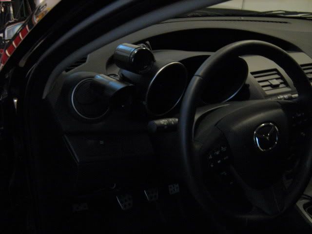

Would you be able to take pictures in the day light that would should more detail?
