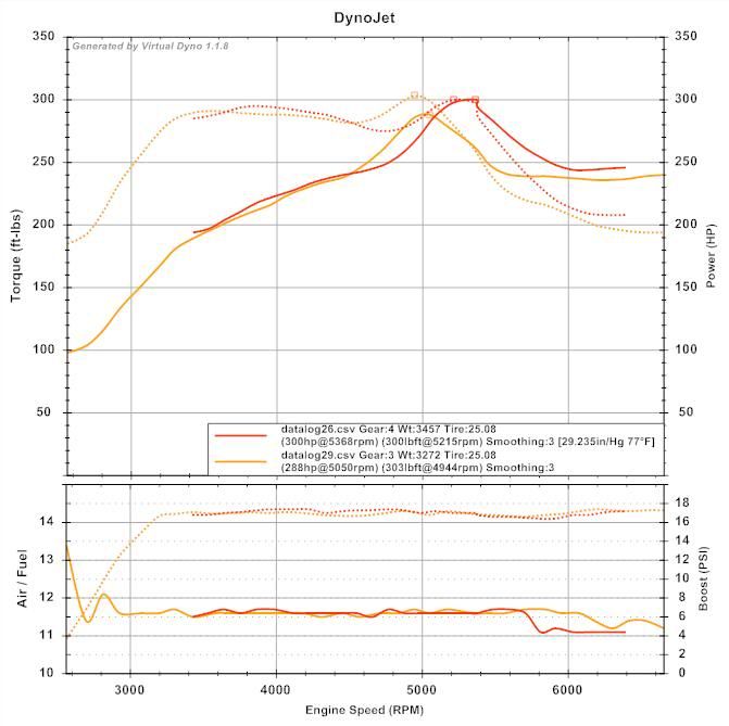

Default My first virtual dyno
Hi guys,
I figured I'd try out this Virtual Dyno thingy with my latest map settings and logs. Can you take a look and tell me if this seems right and if not what should I check or what settings I need to change? Mods are in signature. Remember this is a self-tune based primarily on @Bucker 's "ATR Cheat Sheet.pdf" with 6 iterations of logging and self-tweaking.
Is it possible to have 308whp and this smooth of a powerband with no exhaust work whatsoever ?
Smoothing is set to 3 and dyno is Dynojet with a correction factor set to 1.09
I also attached a full screen shot of the Virtual Dyno program so you guys won't think I'm Photoshopping stuff. Let me know if you want to see my logs.
( 2012 MS3 + @Bucker ) = VOODOO
melbaro likes this.
2012 Black Mica MazdaSpeed3
Street creds:
Last edited by fortressofcomfort; 04-08-2012 at 11:53 PM. Reason: Dynojet type and attached full screenshot

Change your CF to 1.01 and see what you get.

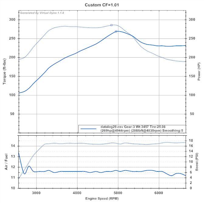

I figured something wasn't right. OK I changed it to "Custom" Dynojet CF of 1.01 and reran the run. See thumbnail. 286whp. Seems more like it.
Still, since this is with just intake and tune, and are good smooth numbers, this points us again to "something has changed on the exhaust side for 2012" theory, no?

Smoothing 5.
Intake test pipe tweaked ots stage 1 map. 135000kms Genwon with 165psi compression in cylinder 3.
What were you saying about smooth?

Smoothing 5.
Yeah yeah yeah, I know you have it out for me Tokay. That's a smooth curve. It really doesn't look like a real, typical DISI K04 curve to me though. Compared to what I just got out of VD, It is down 30 lb/ft and you are running a test pipe. Must be due to cylinder #3 right? Couldn't possibly be due to Voodoo, Unikorn, simply GenPu right?

Put your smoothing to 5 and watch were that 30 lb/ft goes.
