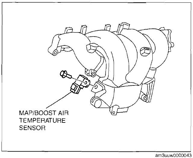

I just got done installing the Corksport Turbo onto my car, and when i went to drive off, my AP will not read boost. Any suggestions? I connected everything correctly, I assume. Also, the Traction Control light on my dash has been constantly on after the install.
And can anyone tell me what this connects to? After I got done cleaning my valves and got my intake manifold back on, I had this left over connector with no home... It's next to the intake manifold on the passenger side...
Attachment 217050
Attachment 217051
Code Monkey 11-25-2015 11:13 AM
That's a connector for the MAP sensor on the IM so no wonder the AP is not reading boost.
boober 11-25-2015 11:21 AM
Where is the other end of this connector?? Bottom side IM?
Code Monkey 11-25-2015 11:27 AM
Yes.
alexwlwsn 11-25-2015 11:28 AM
http://i64.photobucket.com/albums/h1...r_Location.jpg
boober 11-25-2015 11:30 AM
Awesome. Thanks for the info guys. Do you know why my traction control would be staying on after this install? Possibly from this connector?
Djohns 11-25-2015 11:32 AM
It's possible. I'd say plug it in and of the light stays on let us know so we can dive further into it.
boober 11-25-2015 02:15 PM
That fixed everything.
