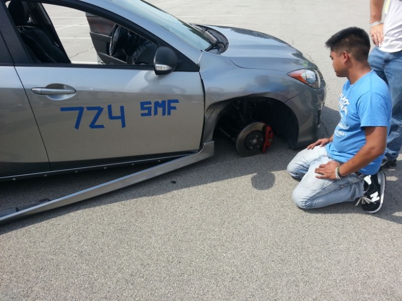

This past weekend CCSCC held a two day autocross event on Sunday and Monday. This is what happened on my fourth run on Sunday.
I figured that would be a good introduction to the issue. This post isn't intended to burn CS, but warn anyone with a similar setup. I consider myself very lucky that the car didn't suffer anything more than the apparent damage, and most importantly that no one was hurt.

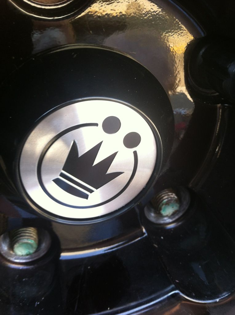

I like most was stoked when my CS custom UPS box arrived (08/22/13), and even more so when I got the lugs out and into my hands. I think I bragged to everyone I talked to about them, and after reading the directions and some posts. I went right to the local Sears store to pick up a 3/8 ft lb torque wrench(08/23/13). This was a huge leap forward for me. My first set of aftermarket wheels (Konig Illusions 18" x 8") with some really bad ass lugs. I installed my wheels and followed the torquing instructions to the letter (65 ft-lbs and check torquing after 50mi).
http://i1061.photobucket.com/albums/...CC54E2E2E8.jpg
I than decided to order a set of JBR 5mm spacers, which arrived the Friday before the event (08/30/13), and I installed them the night before (08/31/13). Now before everyone starts going "why are you running spacers," why not? Is my reply. JBR markets his 5mm spacers just like that other company that shell not be named (SURELY you know who I'm talking about) as not needing extended studs to run them.
Once again I followed CS torquing instructions (65lbs),as well as JBR recommendations for the mileage for re-torquing (i.e. 5,10,15,etc). When I arrived at the event I checked the torquing on the lugs, and then again after my first two runs. It was the forth run that lugs snapped sending my tire flying (again I am very thankful no one was hurt).
So, were does that leave us now...
http://i1061.photobucket.com/albums/...groundwide.jpg
Well, I'm now going to try and provide you all as much information as I can.

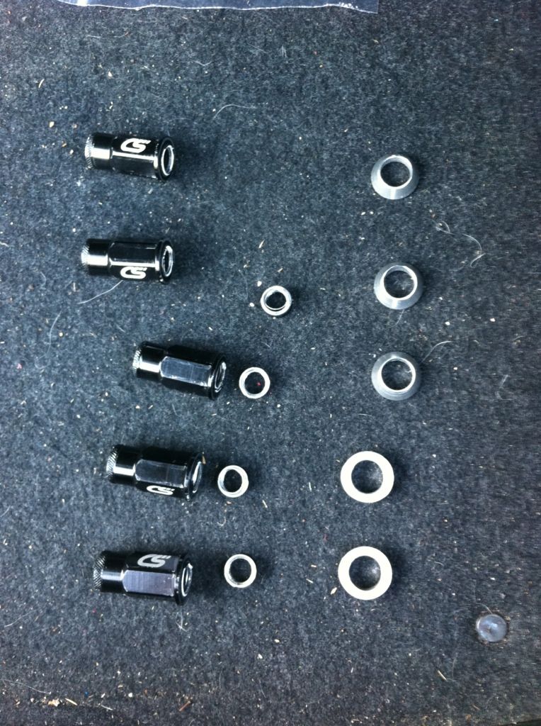

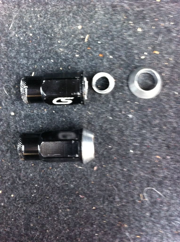

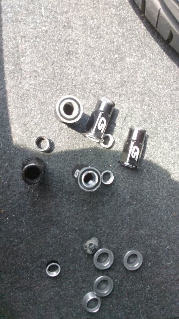

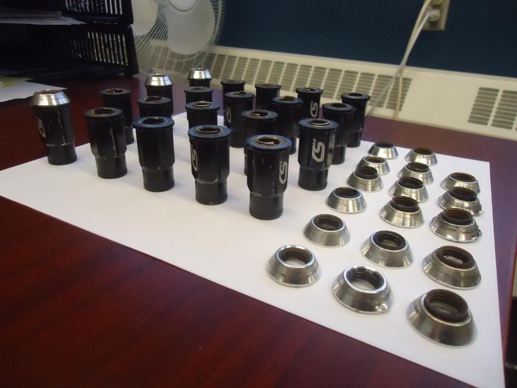

The broken lugs:
http://i1061.photobucket.com/albums/...psa388ed5b.jpg
http://i1061.photobucket.com/albums/...psad14ce6f.jpg
http://i1061.photobucket.com/albums/...ps8c81d675.jpg
The last photo I believe is extremely important. It shows were the weak point is in the two piece lug design. The conical part has a cylindrical shaft of the aluminum with threads in it. This is the piece that snapped from the rest of the lug allowing the wheel to become free.

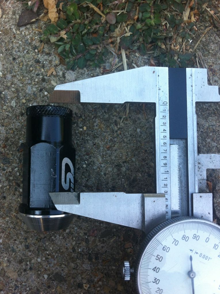

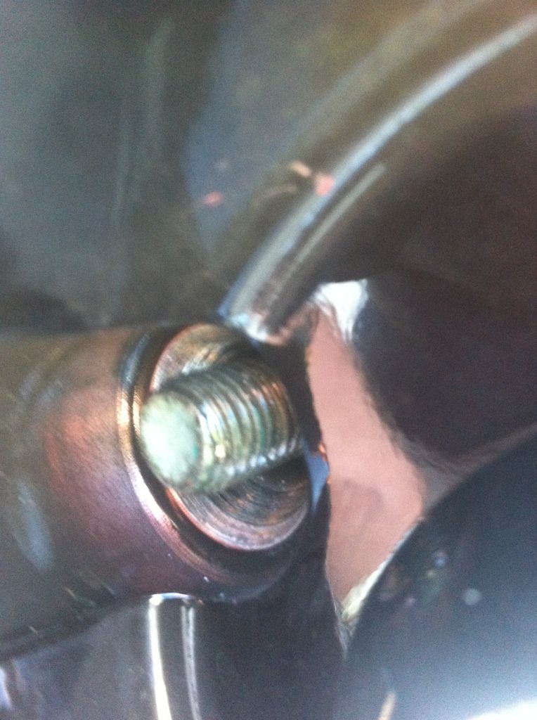

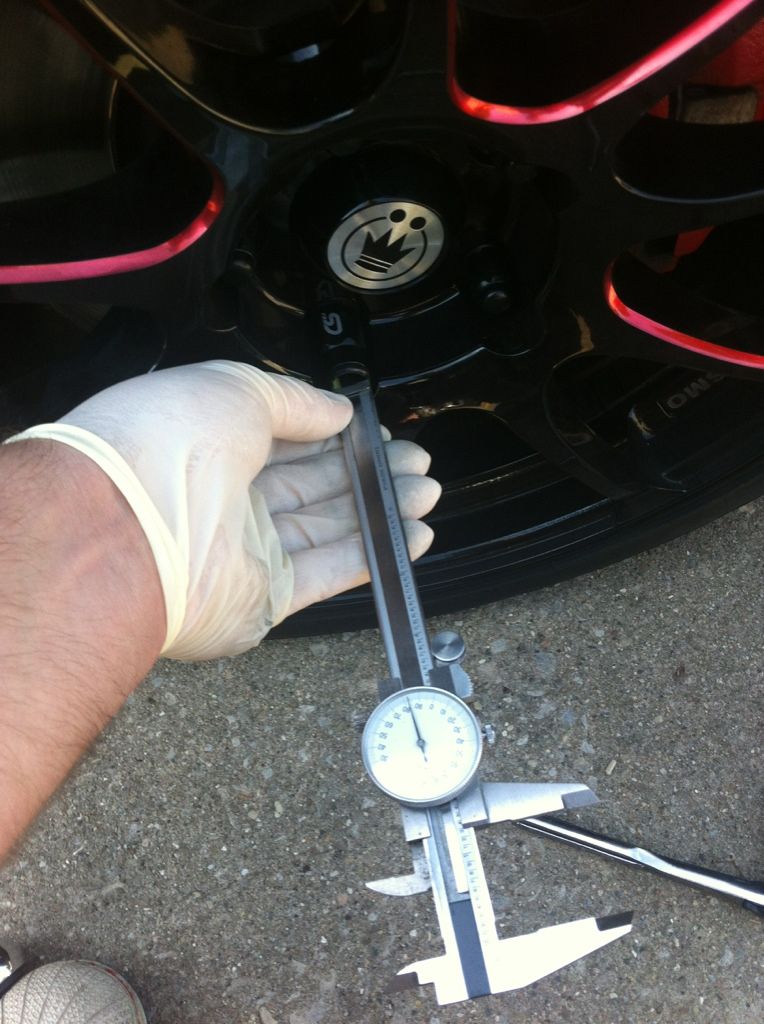

Now before everyone gets crazy... I did some measurements today through the open end of the lugs with and without spacers using a set of calipers.
http://i1061.photobucket.com/albums/...ps52c737b7.jpg
From measuring the depth we can then find out how much stud is actually being threaded into the lug. By then using the outside jaws we can get a good visualization of this by deductive reasoning.
Without spacer:
http://i1061.photobucket.com/albums/...psa9133d12.jpg
With spacer:
http://i1061.photobucket.com/albums/...ps75a65fc3.jpg

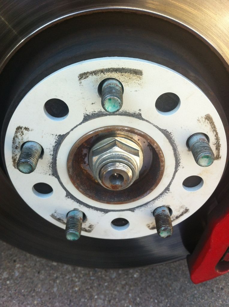

Some other information I can provide (due to Jamie asking if I knew) is the difference in the amount of turns with the lugs. I went a step further, I did it with and without spacers, as well as, the same test on a stock gen pu wheel.
Stock Gen 2 Wheel using Corksport Lightweight Lugs:
Without Spacer: 8 1/2 Turns
With Spacer: 5 1/2 Turns
Konig 18" x 8" Illusion Wheel using Corksport Lightweight Lugs:
Without Spacer: 7 1/2 Turns
With Spacer: 4 1/2 Turns
I believe that information speaks for itself, and I wish I would have noticed how low the turns were with the spacer. I also think it would be unsafe to run these lugs with a stock wheels and spacers. Just my .02. Anyway, the rest of my vehicles suspension is stock and has been so the life of the vehicle (yes I am the first and only owner).
Some other photos I think some would like to see:
http://i1061.photobucket.com/albums/...psf1e15308.jpg
http://i1061.photobucket.com/albums/...ps47285a12.jpg
Without Spacer:
http://i1061.photobucket.com/albums/...psa0aa1d4a.jpg
With Spacer:
http://i1061.photobucket.com/albums/...ps232c20f3.jpg

Just to give a little after story:
The car was jacked up and we stole a lug from each of the other three wheels. I drove it to the pits, made some adjustments to the damaged wheel well, and drove to a local auto store to get some steel lugs.
When my wife and I got home this is what we did:
http://i1061.photobucket.com/albums/...ps879e386a.jpg
And we went back out the next day:
http://i1061.photobucket.com/albums/...ps498541d9.jpg
I did remove the rest of the lugs and spacers from the car, and it will stay that way for now.
I hope someone finds this information useful so it doesn't happen to someone else.

Voltron 09-05-2013 01:40 PM
This happened to me at track., 10 of the 20 lugs broke coming off.
I was stuck with my slicks on, we had to drop the car, and rock the car until the remainder of the lugs somewhat got loose and then use needle nose pliers to twist them off.
Never been a fan of this company.
Will never recommend anyone I know to buy their shit either.
Oh yeah, my car fell off the jack after we rocked it, my side skirt and fender are fucked.
I would be really pissed had that shit broke off while banging down the track.

England15j 09-05-2013 01:50 PM
http://img.tapatalk.com/d/13/09/06/bune9amu.jpg
This is exactly what mine looked like when they failed. I don't use spacers or track my car. They just shattered as I was torquing them down.

@Joel@CorkSport; I had failure of one of my lugs when removing the front driver's side wheel from the car. I've never put an impact to the lugs, and the one time I took it to a shop I was very strict that they not impact it.
That said, what would the damage be? I assume, based on the design, that it would round out the ends but not damage the threads?
I'll address the concerns that @JgamB; presented. I'm running 5mm JBR spacers up front and had issues with the lugs coming loose during a drag strip event. On one wheel, 3 of the 5 were finger tight. I tightened them to spec and kept running. A few more runs later and they were loose again.
Got home that night and torqued them back to 65ft/lbs and never had an issue again with them getting loose. I did not take the car back to the strip though.
Fast forward about a month and I'm at Gingerman Raceway doing a pre-race inspection. Some of the lugs weren't quite 65ft/lbs, but they were in no way finger tight. Retightened them with my torque wrench (Crafstman) and double checked them with @kritz;'s torque wrench. Everything looked good and worked fine during the track event.
Got home from EMWNM and went to swap my front brakes. 4 lugs came off the driver's side just fine when the 5th one sheared. Note, this was when taking the wheel off of the car. Since it was the last lug, I was supporting the wheel so it didn't have additional forces on it.
I've not yet taken the rear lugs off, but I will do that this weekend.
I filed a support ticket with CS and they have offered to send me a replacement lug. I just responded and asked them to wait until I get the others off the car before they take any action.
Honestly, I don't feel comfortable running these on the car and will be switching to gorilla lugs that I had sitting around.
EDIT: Not sure if it matters, but I'm running 17x9 PF01-SS with hub-centric rings and 5mm spacers.

torq 09-05-2013 07:07 PM
I had a similar issue happen to me with these lugs, I put them on in the spring, torqued them to 80 ft/lbs, didn't touch them until fall when I went to swap them out and about a quarter of them came apart similar to the OP's when I went to loosen them. Had to take the broken ends off with needle nose.
http://i.imgur.com/TzQmFN5.jpg
Was going to raise a ruckus but decided to put it down to experience, out of the blue they sent me a replacement set saying they found issues with the run that I had bought. I'm scared to put them on a car though.
