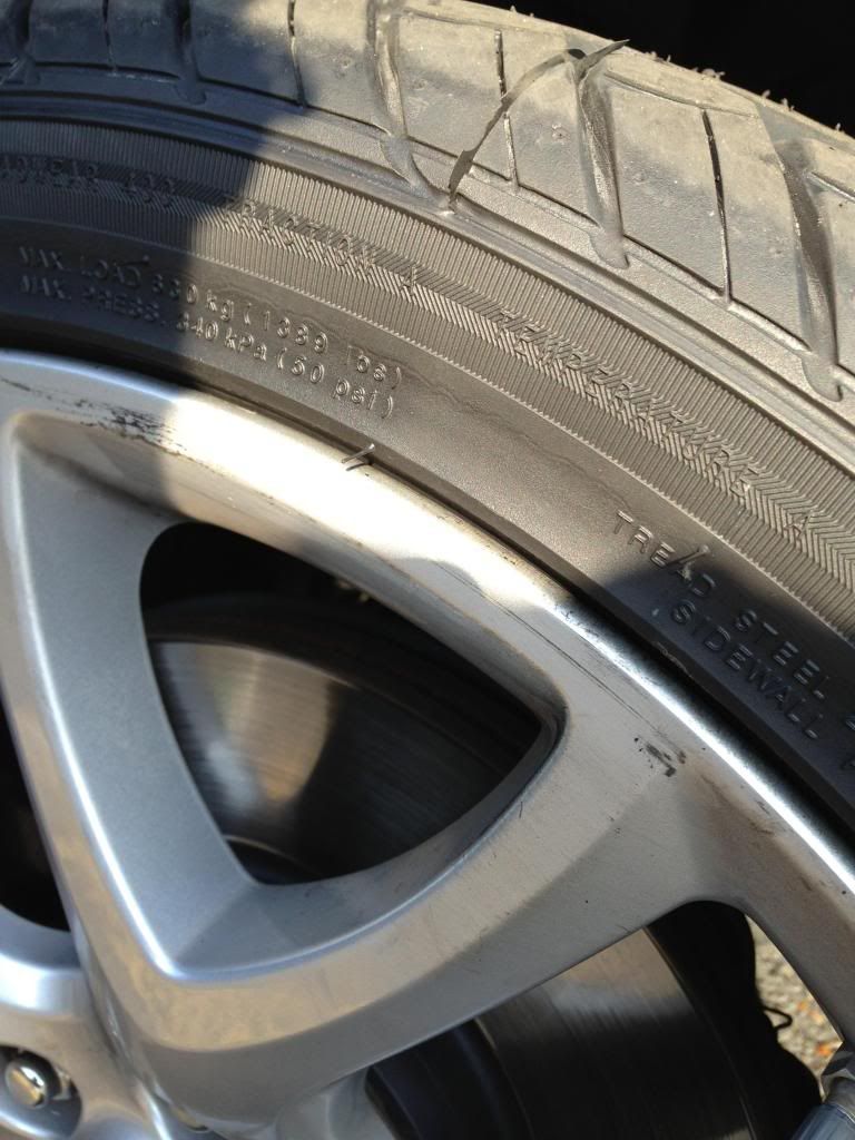

Thanks guys. Just stopped by and showed him the rims. He stands firm that with his machines, it is not possible to scratch the rim the way mine are scratched. I let him know they were clean before I arrived, and that the rims all have the same matching marks around the edge of the rim. But he did let me know of a good shop that I can take it to so they can be sanded down and sprayed haha lol.
Ya win some ya lose some. Tony sure is a swell guy.
Ill post some pics up, hopefully they dont come out mega huge.

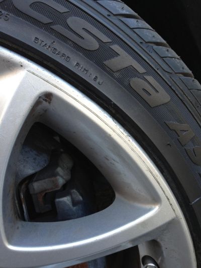

First, sorry for the huge pics Ill try to resize. And my rims are still dirty as hell from the installation, I didnt want to clean them up or touch them before taking it back in.
Maybe because of this????

The tool that pulls the tire off the wheel revolves around the wheel and it is possible the tech made a mistake and it did that. No real otyher logical reason IMO why a perfectly symmetrical gouge should be there.
Your wheels are dirty, tho. Would be obvious if fresh if the area was clean too. And holy rusted brake pads!

lol bullshit. that is certainly from the machine. When you pry the old tire over the plastic
"non marring" head it puts pressure on the face of the wheel there. If the head isn't in good condition or there something in there from an old shitty steel wheel or something then it will do that every time. Or if the wheel wasn't level when they clamped it down in the machine it can do that. Call corporate and raise hell.
haha for some odd reason the drivers side brake pad decided to rust, I know I know it looks like shit. But the rest are ok for some odd reason. Been meaning to take care of that.
Yes, and a perfectly symmetrical gouge on multiple wheels, after a tire install.

This is the part that's blowing my mind. A dumb tech and a tire iron on a tire machine did that. Unless you let a woman drive your car, they do the darndest things...
Seriously tho, I hope you don't sit on this, the longer you wait, the less likely anythings going to be done. Good luck.
