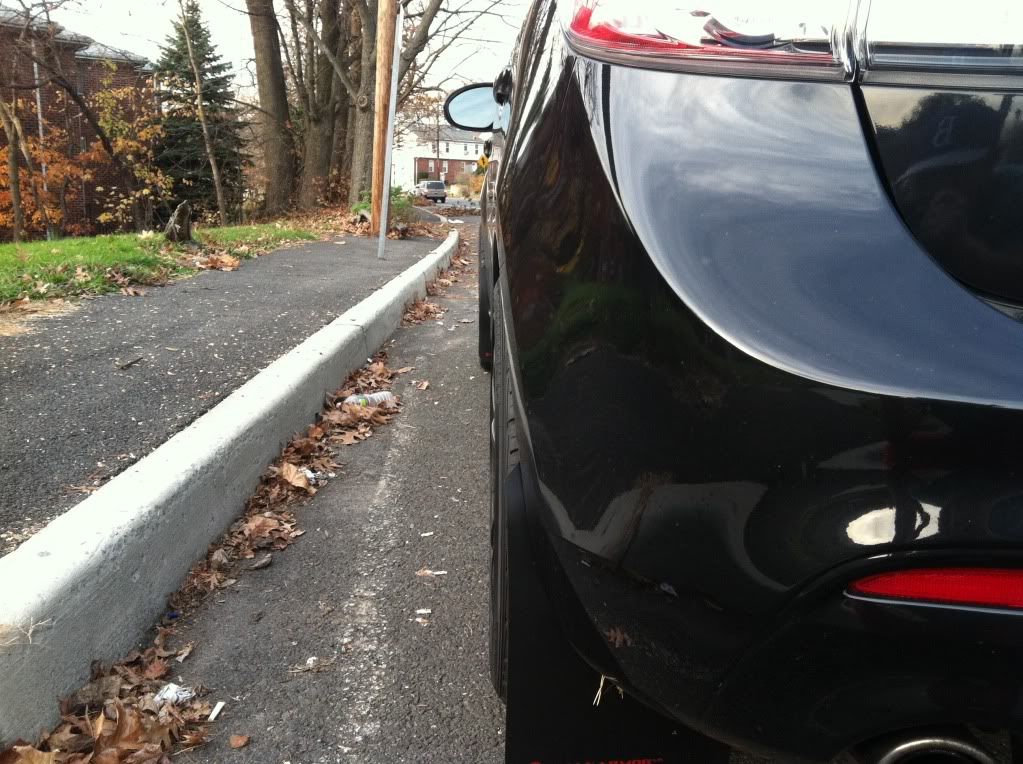

have a couple of pic in this thread
just got these babies | SpeedForums.org
they dont rub unless i hit a big speed bump or have 2 people in the back seat.
this is with the 245's on them im gonna get 235's for this summer.
Nice, good thread with some more pics.
These look really good!

Fitment is perfect. With the front tires turned all the way I still have 1/4" before they touch the side wall. As long as I don't hit a speed bump hard while my tires are turned all the way I'll be just fine lol.
Please note I'm on stock suspension, if you are lowered this setup WILL NOT work for you.
EVO X 18/40/8.5 Rims
Nitto 245/40/18 NT05 Tires
I've completely eliminated ALL wheel spin in every gear except first. I used to spin 1-3rd. Now 2nd & 3 have zero spin, just pure zoom zoom acceleration loving!
As for the ride quality, I was expecting a stiffer ride. It's actually very smooth, I was surprised but road noise is at a minimum it's a very smooth ride. I absolutely love them.
Here are the pics:
