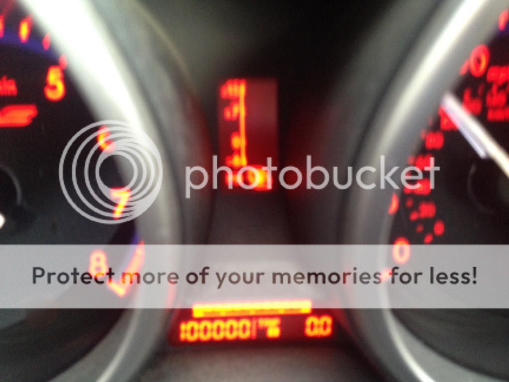

AndyT 01-11-2015 02:17 PM
Mine's just ticked over 100k,
http://i536.photobucket.com/albums/f...s/IMG_1717.jpg
had the car since new and I started tuning 4 years ago pretty much as soon as i bought the car.
I'd echo what others have said about good oil etc.. but also add to drive it sympathetically until upto temperature.
I've just changed my suspension top mounts today, but that's expected for my mileage.
