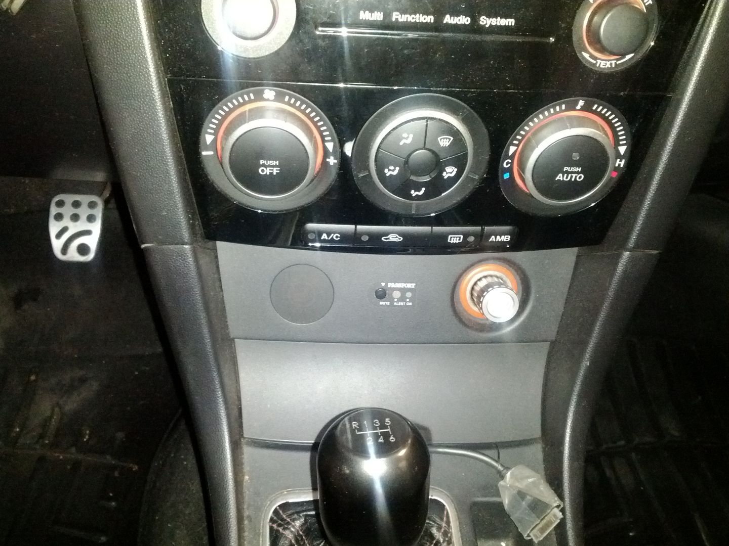

Ok, so I am going to hardwire my Beltronics 995 and I want to use the mute button. I was thinking of placing it in one of the empty button spots on my dash area, anyone done something like this before? Is there enough room back there?
I'll attach some pics so you can see what I'm talking about.
Thinking of that rectangular one on the right.

Any clue how to get that trim piece off?
CWP_MS3 05-01-2012 09:01 AM
Just guessing, as I've never had to take it off before:
Start with the plastic piece surrounding it. Lightly pry from the side with a pocket screwdriver. That's the way 99% of small trim comes off. Just keep an eye out for clips that hook underneath to the dash so you don't break them.
Trial and error. :)
manila 05-01-2012 09:11 AM
You can also try taking apart that module in your hand (looks like the power source) find the wire that connects to the mute switch and separate that wire to the panel on the right of the steering wheel where your DSC is located. From there you could have a pretty clean install. GL. keep us posted
EDIT: The blank switch located next to the DSC; you could probably pry it of by going from the back and pushing it out.
iggy097 05-01-2012 09:16 AM
Ya, the trip pulls right off, and the button pops out by depressing the two tabs, one on top, other on the bottom.
The mute button fits in there good ( not this one, because this is the stock smart cord ) but the mute button from the hard line one, without the wire sticking out the front.
May have to trim a little, in the cavity where the button is, but I won't know until I go pick up the cord from Best Buy later.

I would never use the 'official' Escort / Beltronics hardwire kit. Too big and no really good way to mount it. Unless you absolutely need the lights that it has, I'd pass.
The past 4 cars I've owned I've used this:
ESCORT PASSPORT SMART MUTE RADAR Direct Cord Hard Wire | eBay
Swap out their ugly button with something a little nicer and you end up with this:

That's clean, but why did you choose to dremel the switch there?

How much of a pain was it to install the button there? Seems like a decent placement, as your hand is most likely by the shifter anyhow
ahfunaki 05-01-2012 10:11 AM
Originally Posted by iggy097 (Post 1391763)
That looks really nice. Thanks for the link, just ordered it, you saved me some cash.
It wasn't hard to install. Just a matter of running the wire over there.
And you obviously don't have to put the button there. I thought about putting it over to the left of the wheel in one of those blank spots too, but it makes no sense while driving.
I installed it where I did because it's close to the shifter, so it's easy to move your hand off the shifter and hit the button. Or while you're crusing your hand is over there anyways.
And I put it in the black plastic so it wouldn't be as noticeable. Ideally if you want to drill into the silver shifter trim that might be the best location for it functionality wise, but I didn't want to a) drill a hole in the silver and b) have a button very visible because it's black on silver.
Oh and I should mention when driving, the button is below the e-brake handle, so you just kinda have to move you hand over the button from the side you can't really go from straight up and hit it. So if you want better access you'll have to move it up farther or maybe put it in front of the cup holders? I really like where I have it though.
Also this is the button I used:
http://www.ebay.com/itm/5-Viper-Avit...#ht_500wt_1413
It's a valet switch from a Viper alarm. I had one laying around, but if you don't it's a nice button and might be worth spending the $7 on. Plus you'd get 4 backup buttons!

Seems like it would be a ackward place when the E brake was disengaged
