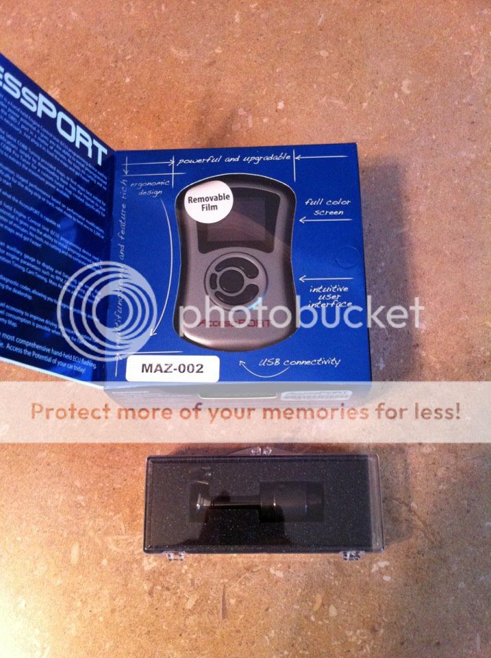

Looky what came in today!
So this morning AP and Autotech internals came in!( From Eric at Edgeautosport ) Now internals are being put in this sunday. Is there a map I could be running or just keep it on stock tune till then?
http://i477.photobucket.com/albums/r...AccessPort.jpg

You can run the stage1 map for the Cobb SRI

Im afraid of running lean on stage 1 with no HPFP till sunday

Sure you'll be fine just don't rag on it too bad

Cobb doesn't require HPFP for stage1. They recommend it, but it's not really necessary with only a SRI. I ran the stage1 maps for months before I got my HPFP and DP in...no issues. It's only gonna be 2 days. You'll be just fine.
