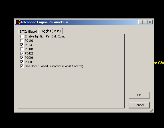

rfinkle2 08-11-2011 02:21 PM
Wolly6973 and I got that code recently also, just after Cobb switched to the newest version of ATR.
I never had the code until then.
I disabled it, and my car is running fine.
mrFanel 08-11-2011 03:23 PM
Hrm - that might be the thing too. What exactly did you disable and how?
rfinkle2 08-11-2011 05:28 PM
In ATR,
Edit>advanced parameters>toggles base tab
http://i1206.photobucket.com/albums/...2/advanced.png

mrFanel 08-11-2011 10:42 PM
Thanks Finkle :)
