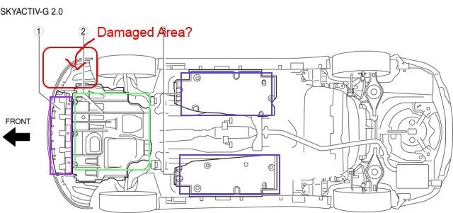

So I got fed up and took a closer look yesterday after work. I was tired of driving the Expedition and wanted some speed in my life again. Anyways, took a look under the car and noticed it wasn't the plastic skid plate undercover thing. What happened was when the front lip got ripped off the other screws got ripped off also so the left and right plastic/rubber covering things near the wheels where not fastened to the bumper...if that makes any sense. So basically they were dragging and got torn up and in turn were rubbing against the front tires. So what I did was I just cut them off so both sides wouldn't be dragging anymore. It's the part where you can see that it is stapled to the bottom of the wheelwell covering, where it has that little flap.
I made sure the screws were tightened on the plastic skid plate undercover and now I'm driving again. I'm going to have to see if I can find some replacements for those parts I cut off. At least I'm on the road again - minus my front lip and those flappy undercover parts. I'm gonna have to browse back to another mazda forum and find the pic of it. I'll edit this with what I'm talking about. Thanks for you guys' help!
