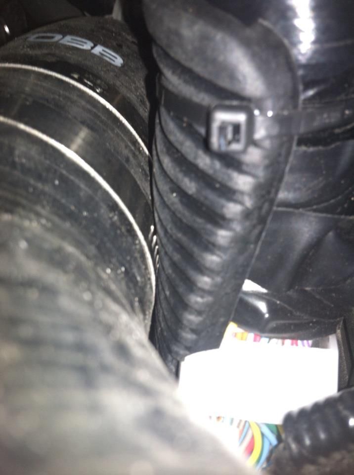

So it's been about a week after I installed my CS SRI and everything has been going well up until about 15mins ago. All my lights on my dash started flashing and it restricted boost. I got home and quickly found the problem. I guess I should be more careful with clamp placement in the future. ImageUploadedByTapatalk1357441815.683871.jpg

same thing happened to me, where it cut into the ecu harness? car died mid turn up a hill. had to wave everywhere back so i could roll down into the parking lot behind me. Hit the injector wire and shorted it causing the fuse to blow in the fuse box. Used the radio fuse in place, started right up

You're not the first one, young Jedi. CorkSport has an article on clamp install for that very reason...

I guess I should have said install fail, I don't blame CS at all. I'm guessing ill have to pull the intake and carefully repair the wires put the clamps back on in a way where they won't rub and hopefully I didn't ruin anything

Do you guys think it will blow a fuse or short and burn something up if I drive it?

Inspect the harness as stated above repair if necessary. A few things in the tool kit should be a test light, or DVM,liquid electrical tape,rescue tape,butt connectors and assorted fuses. Keep us posted on progress.

Check the out the wires carefully which took the damage. If there they are pretty torn up cut the wire and make a new connection if you can with solder and good heat shrink. You need to make sure the repairs are sealed well to prevent anything from coming up in the future.

We wrote up that article Code Monkey linked in to try to help people from doing this exact thing.

Also, it might be obvious, but disconnect (and possibly remove) your car battery while repairs are being done, even if your careful its easy to do really stupid things near a car battery (trust me...).

I thankfully noticed the hose clamp rubbing against the wires after a week when I installed my Cobb SRI and avoided this problem

 Old 01-05-2013, 11:32 PM   #23
Evan002's Avatar
Location: Seattle,WA
Posts: 69   (View Stats)
Evan002 has much to be proud ofEvan002 has much to be proud ofEvan002 has much to be proud ofEvan002 has much to be proud ofEvan002 has much to be proud ofEvan002 has much to be proud ofEvan002 has much to be proud ofEvan002 has much to be proud of
Thanks: 41
Thanked 22 Times in 13 Posts
Groaned at 12 Times in 2 Posts
Well the damage doesn't look to bad I'm thinking a little liquid electrical tape and it should be fine. ImageUploadedByTapatalk1357453962.746868.jpg

Looks like only the insulation rubbed off - lucky dog.

The repair seemed to go well and everything is working now. I am concerned that this will be a problem in the future, so I guess I will look into ways to insulate the wiring. Thank you everyone one for ideas on how to avoid this in the future. ImageUploadedByTapatalk1357497634.023049.jpgImageUploadedByTapatalk1357497645.451266.jpg
Evan002 is offline   Reply With Quote

Originally Posted by Evan002 View Post
The repair seemed to go well and everything is working now. I am concerned that this will be a problem in the future, so I guess I will look into ways to insulate the wiring. Thank you everyone one for ideas on how to avoid this in the future. Attachment 87967Attachment 87968
Just do what I did. Look at the pic I posted before. It is a $4 rubber brake pedal pad and a zip tie. I have not had any issues and its a cheap effective way to not have to worry anymore.

^I like this idea. @KILLER_VIZ; your photo for reference:

I just used three zip ties around the harness

When I installed mine I made sure the band was as far away from the harness as possible because I read it was a problm here but, it would be easy to install the SRI with the clamp next to the ECU wires, live , learn, read, donate.

I read about it and thats why I did what I did the same day I installed my TIP and SRI.
I will have to say, this is a great idea. I'm going to replicate that as best as I can, thanks for the idea man

There is a note in our instructions telling people this.
