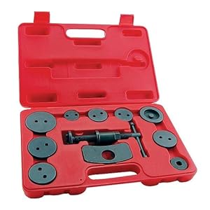

Nliiitend1 01-31-2013 01:28 PM
I use a Harbor Freight kit (although mine is the "older" version they don't sell anymore that came in a red case and was slightly cheaper).
http://ecx.images-amazon.com/images/...500_AA300_.jpg
Well worth the investment for this car's PITA rear pistons.

I'm not too sure about the one you got but I got this from Harborfreight and it seems to be working pretty good for me:
18 Piece Disc Brake Pad and Caliper Service Tool Kit
