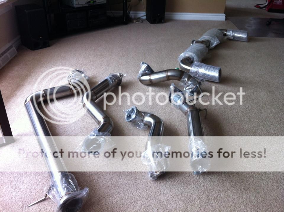

Alright, well on monday I received my Ultimate Racing turbo back exhaust from Edge ( Thanks Eric for making it so easy). Since ill be pretty busy with work , install will be done on the 15th. Good news is ill be heading over to my buddys house with a lift in his garage to do the install so hopefully the dp install wont be a fucking PITA.

Evan@COBB 06-06-2012 12:54 PM
Oh, it'll still be a PITA. :tongue:
GunGuru727 06-06-2012 01:00 PM
It's a beautiful sight isnt it?
When I opened my box I just wanted to lay with the piping.
forcedinduktion 06-06-2012 01:01 PM
Ive done 2 DPs on 2 speeds on floor jacks and it wasn't very bad at all. A little time consuming but its pretty easy.
boosted_out 06-06-2012 01:23 PM
I was so exited about getting it out that after I had that lil popcorn foam pads all over the place.
boosted_out 06-06-2012 01:29 PM
haha im trying to psych myself mentally that it wont be too bad, but if it gets hostile, well have many beer breaks lol! From what im hearing its the fucking heatshield and the location of the bolts that have everyone cursing.
GunGuru727 06-06-2012 01:41 PM
Same here lol
Holy shit they pack it good!
EdgeAutosport.com 06-06-2012 02:03 PM
Hey are those the gaskets attached to the flanges?
boosted_out 06-06-2012 10:05 PM
Yes my bad, I was completly not expecting to be already attached that is why I was sure they were missing, I was looking around for a small clear bag with gaskets in. Now if im correct, is it only the parts for the CBE that have the gaskets and the dp and tp have donut gaskets?
Roddiy 06-06-2012 10:36 PM
http://i477.photobucket.com/albums/r..._out/URTBE.jpg
Fuck that looks awesome.
Enjoy the awesomeness, until the day you have to put it all on your car. Then you'll hate it for about 4 hours, and fall right back in love again.

econman 06-07-2012 08:37 AM
I just installed my UR TBE that I got from edgeautosports as well over Memorial day weekend. It wasn't too bad to do - took about 10 hours over two days. Two tips for you:
1). Make sure you drive your car for a while get all the bolts around the turbo nice and hot before trying to remove them. I started taking all the heatshields off the car right when I got home from work (30 min drive) so I could get access to the 5 downpipe nuts. Sprayed everything with PB blaster, waited 5 minutes, and they all came out every easily (3 nuts, 2 studs + nuts). I had the 5 bolts off in less than 10 minutes using a breaker bar, various extensions, u-joints, and 14mm deep socket.
2). When you are getting the pipe into place the goes over the rear drivers side suspension, there is a black piece of plastic that needs to be removed (http://www.mazdaspeedforums.org/foru...12/). If you don't remove it, you won't be able to get the pipe in. The pipe goes over the rear arm and suspension from front to back.
